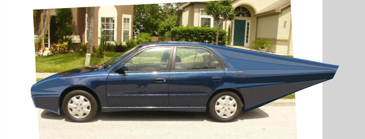

    but since this board is pretty slow lately I'll put some crazy ass shit so you guys can shoot me down
    and we all get a laugh...
    (even if secretly I wanna do it cause it would be cool)
    Congratulations, your car looks like a helmet.
    JDM?
    SaberJ2X Lurk MOAR
    1,713
    7
    398
    Mayawest, PR
    EUDM!
    JDM is so 2001
    what a dumb looking helmet lol
    get these rims. less air drag than the ones you have on?
    Even the guy wearing the helmet cant hold back from laughing his ass off.
    he may appear to be laughing but deep down inside hes just jealous that he cant have rims like that on his bike
    fishexpo101 Get Some
    1,087
    Northern Virginia
    Not sure you will gain that much from a boattail add-on, especially at lower speeds. Might consider a Kammback setup. Similar gains, but you won't distort the length of the car as much. Add to that a grille block and rear skirts - you could be shaving 10% or more in overall fuel consumption.
    SaberJ2X Lurk MOAR
    1,713
    7
    398
    Mayawest, PR
    I see fishexpo at least haven't joined the ranks of the hurr durr me-too tribe :D
    kammback does much of a diferrence?
    and yea, the boat tail is much more efficient... but how the hell I'd store that in the trunk I wouldn't have a clue... I'd like to do the nose front too but again, storing it when not in highway driving.
    was also thinking of doing the underside with that coroplast panels except near the exhaust

    Wouldnt adding the weight just cancel out the gains? I just thought about the CRX having kammback rear might actually be for a purpose. I wonder if this is the reason why CRX's can easily be made into dragsters (and maybe the fact that swaps can be done for cheap)

    well it can be made of plexiglass, tape (to seal the gaps cheaply) and some hooking system (spoiler mount points)
    1,087
    Northern Virginia
    Also have to factor in your speed of travel - added weight is never a good thing, but drag on the car grows by a factor of two of the speed. Comparing commutes at 30MPH (typical city) vs 60MPH (typical highway), just doubling the speed will increase drag four-fold.
    Yeah, nothing will beat the boat-tail for efficiency, but the Kammback's lower profile makes it less of a hassle to deal with. You won't see the full pressure recovery of a "pointy" tail design, but it will be pretty close. Don't have hard numbers on their efficiency, but to say they are 25-50% of an airfoil is not out of the question (i.e., if a full boat-tail gave you a 10% gain in fuel economy, a Kammback will yield 2.5 to 5% gain in fuel economy. That's not bad considering the short profile, instead of a tail that is 8-12 feet behind the back of the car to keep in around that "magical" number of no curves greater than 20-22 degrees.
    If you are serious about this - might consider a hybrid design - something that is part boat-tail and part Kammback. In a sense, they were used in many road racing cars of that day than forbade rear diffusers.
    http://www.mulsannescorner.com/lolab2k40-2.html

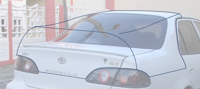

    I want it to be something I clip on and put some tape of the top since I won't use it 80% of the time
    and collapsible OR build-able in some minutes.
    will take 2 pictures of the car and line something serious in flash.
    could I have to do something from the bumper? or I can end it all at the trunk lid?

    well...?
    1,087
    Northern Virginia
    That's not too bad!
    I wouldn't worry too much about the bumper, if you want to later, you can incorporate some sort of diffuser under the rear bumper to help with flow separate issues from the high pressure air running under the car. The underbody panels you mentioned before should help out. Without an actual test facility, your only other options are CFD modeling and/or trial and error.
    But what you have is actually a great start. Stick with the axioms of aerodynamics (and art) - form follows function and if it doesn't "look" right, it probably won't "work" right - that will get your a good portion of the way there.
    The Kammback on the old CRX was intentional. Same way with the Toyota Prius and Honda Insight.
    Though in the drag racing aspect - that was all brute force coupled with the lightweight body. Stuff more power under the hood and it won't really matter how the body is shaped.
    The Kammback is an endearing design, classic and clean - either love it or hate it.
