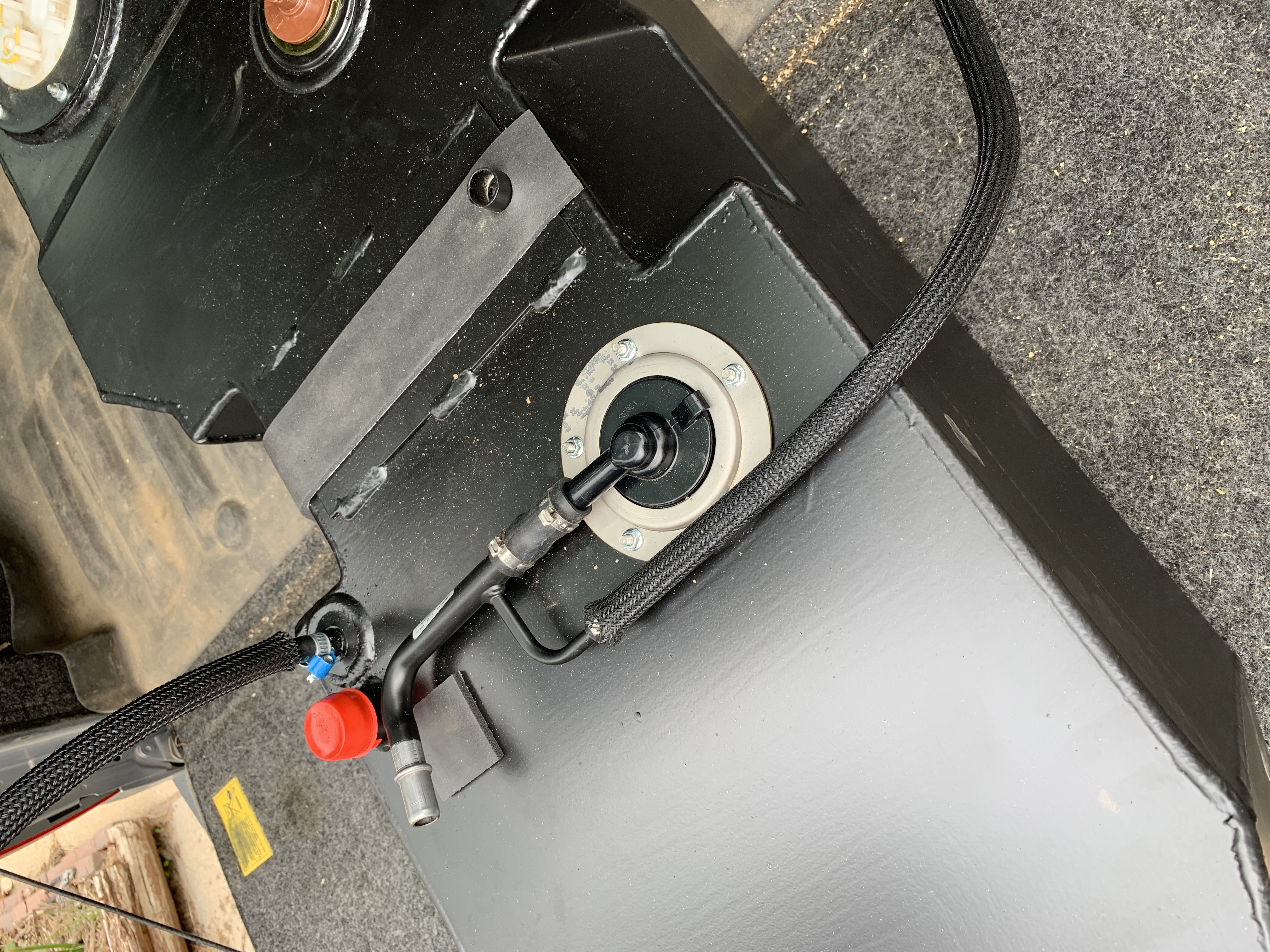

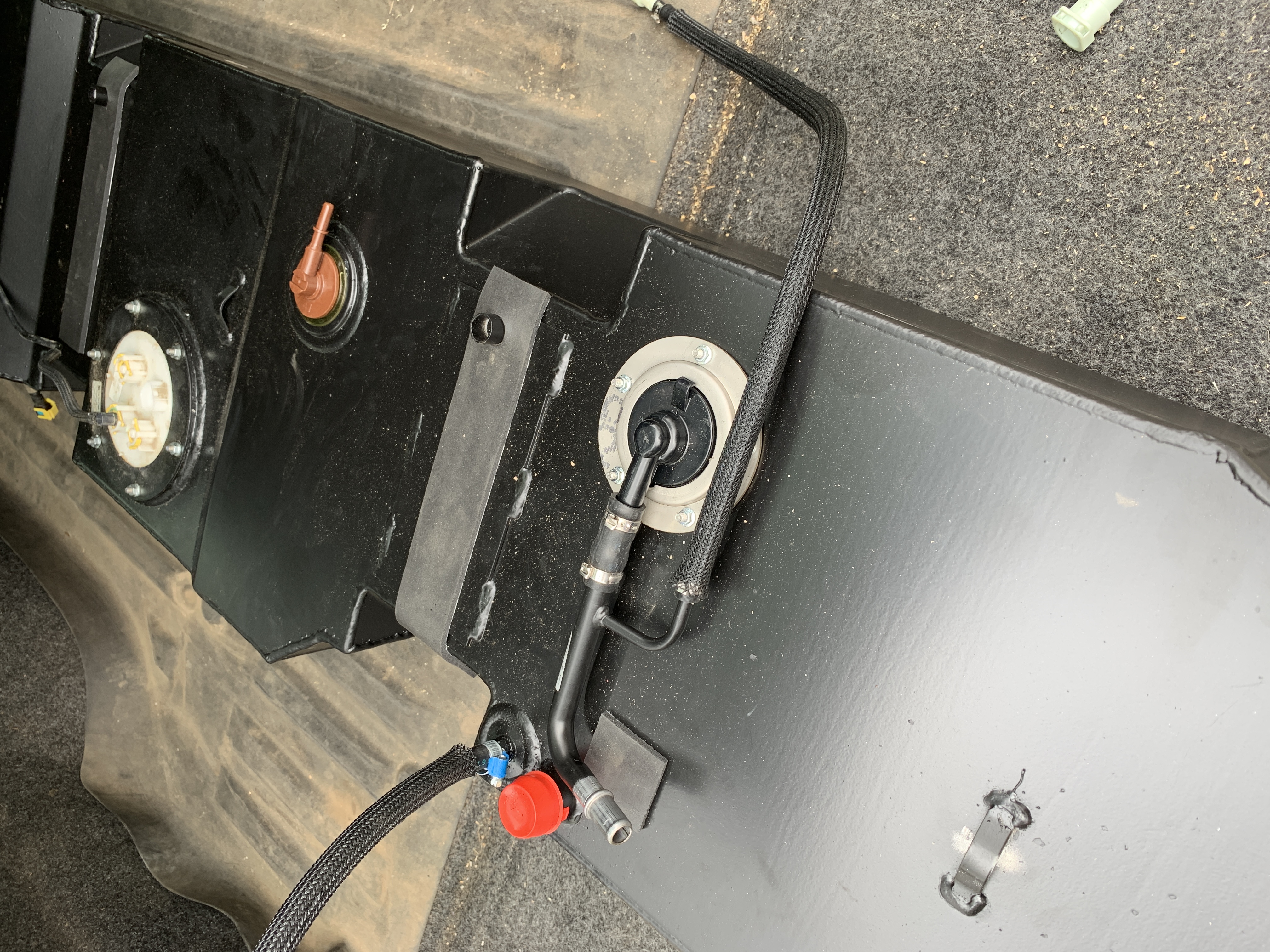

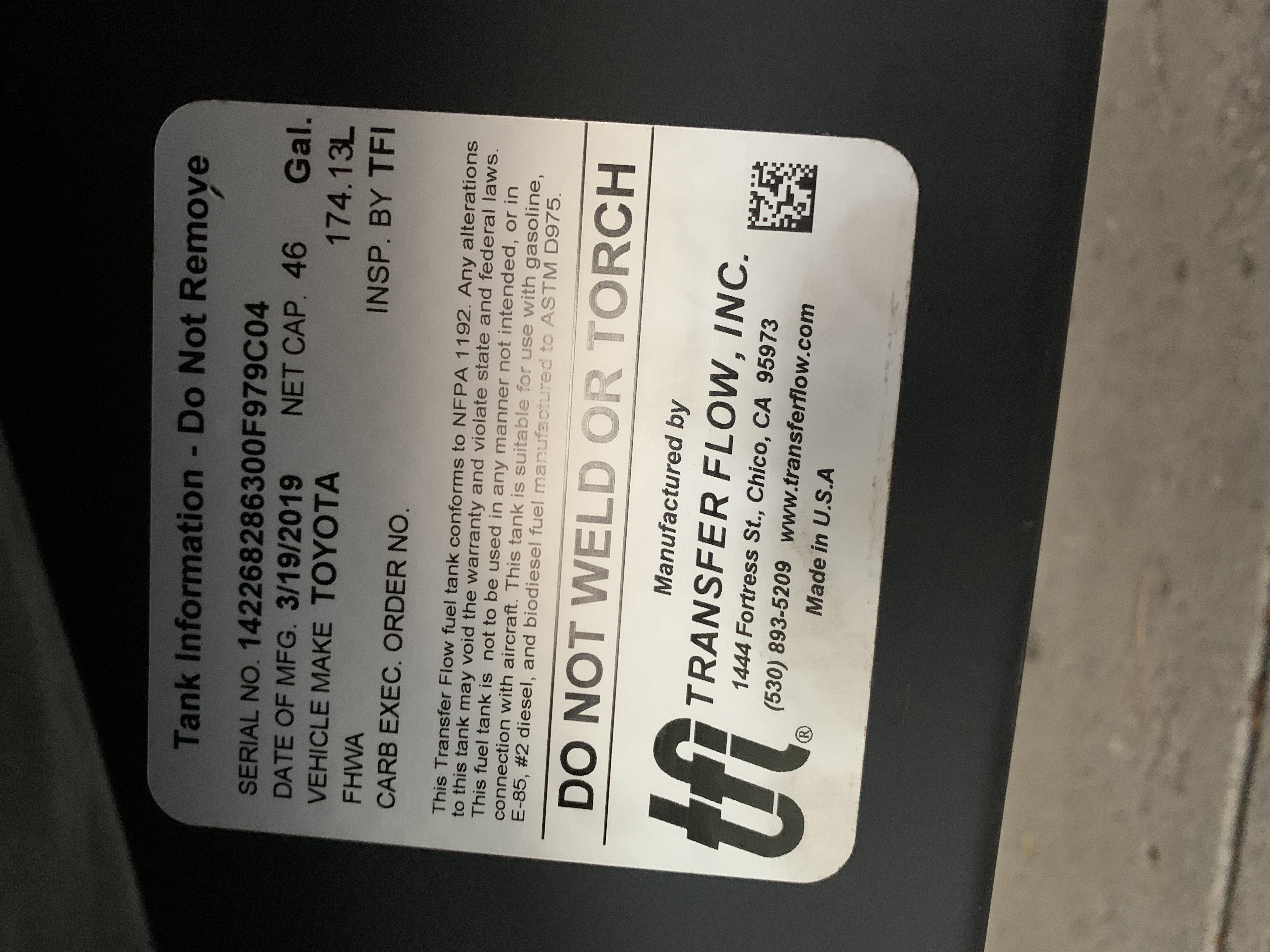

    First post is my 46 Gallon Fuel Tank Upgrade that DeebsTundra (old school name from back in the day here) and I installed on my truck at the beginning of May. This is the TransferFlow 46 Gallon Midship Fuel Tank Replacement
    Link to the product installed:
    https://www.transferflow.com/shop/product/0800114225

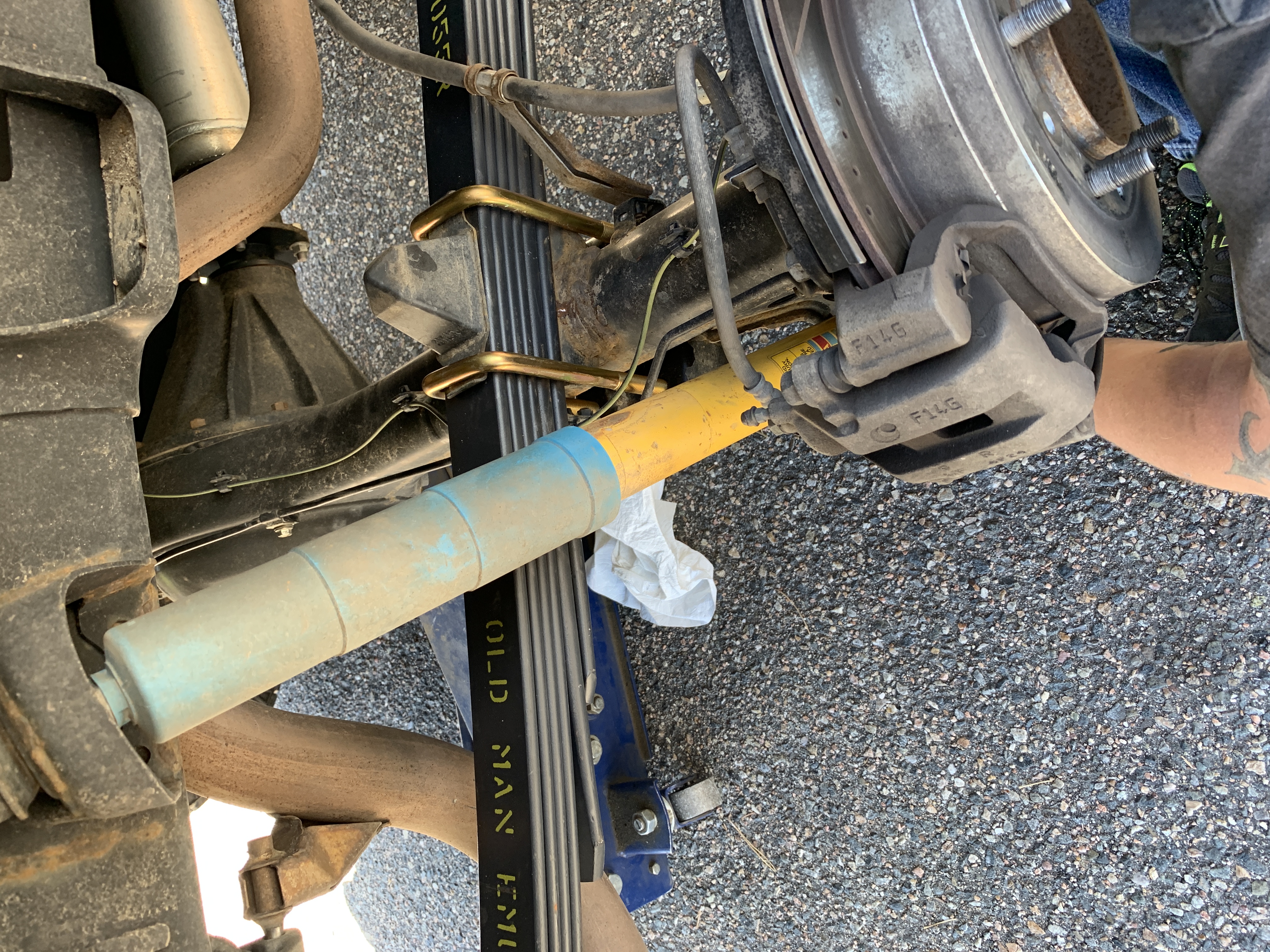

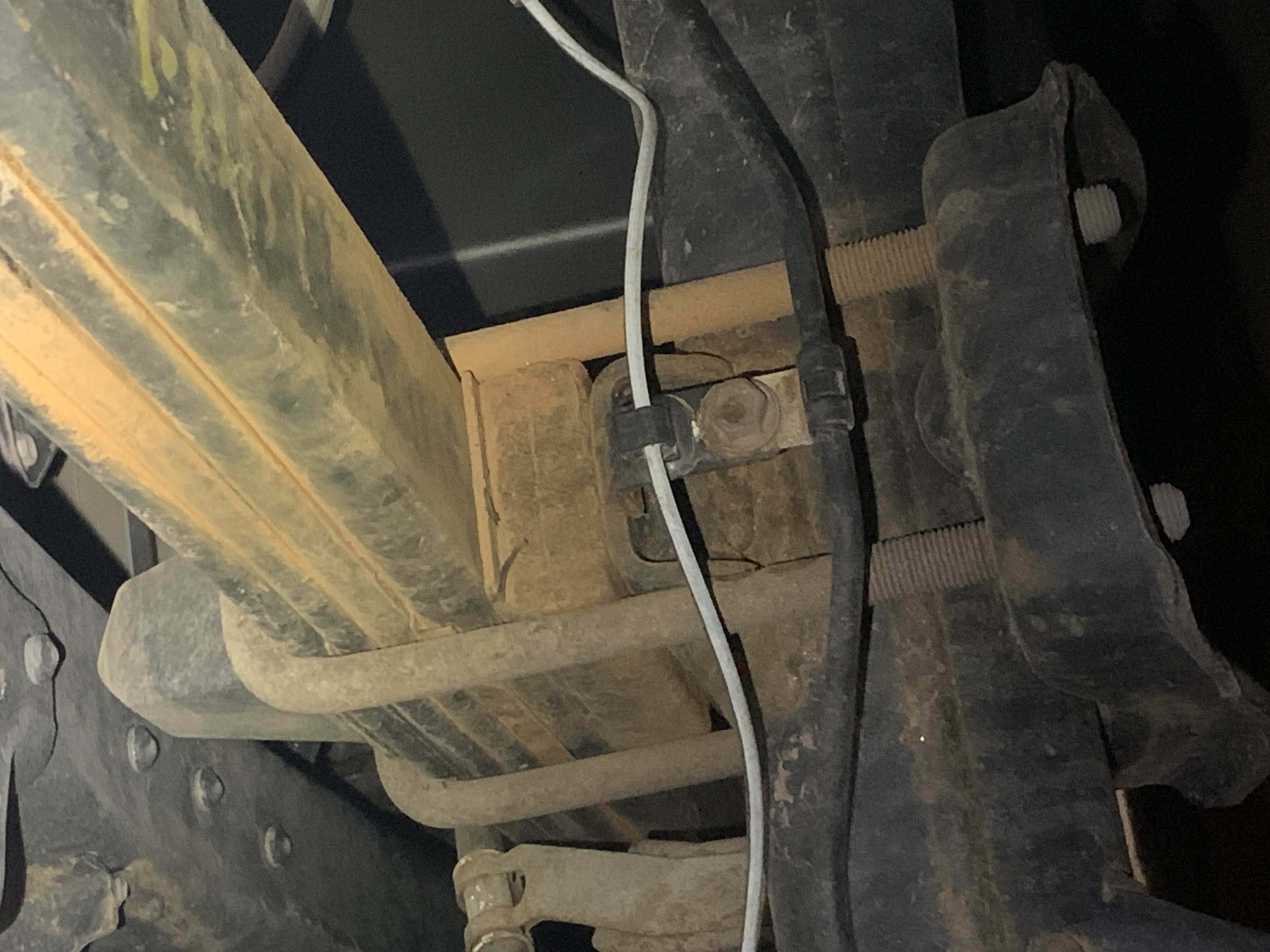

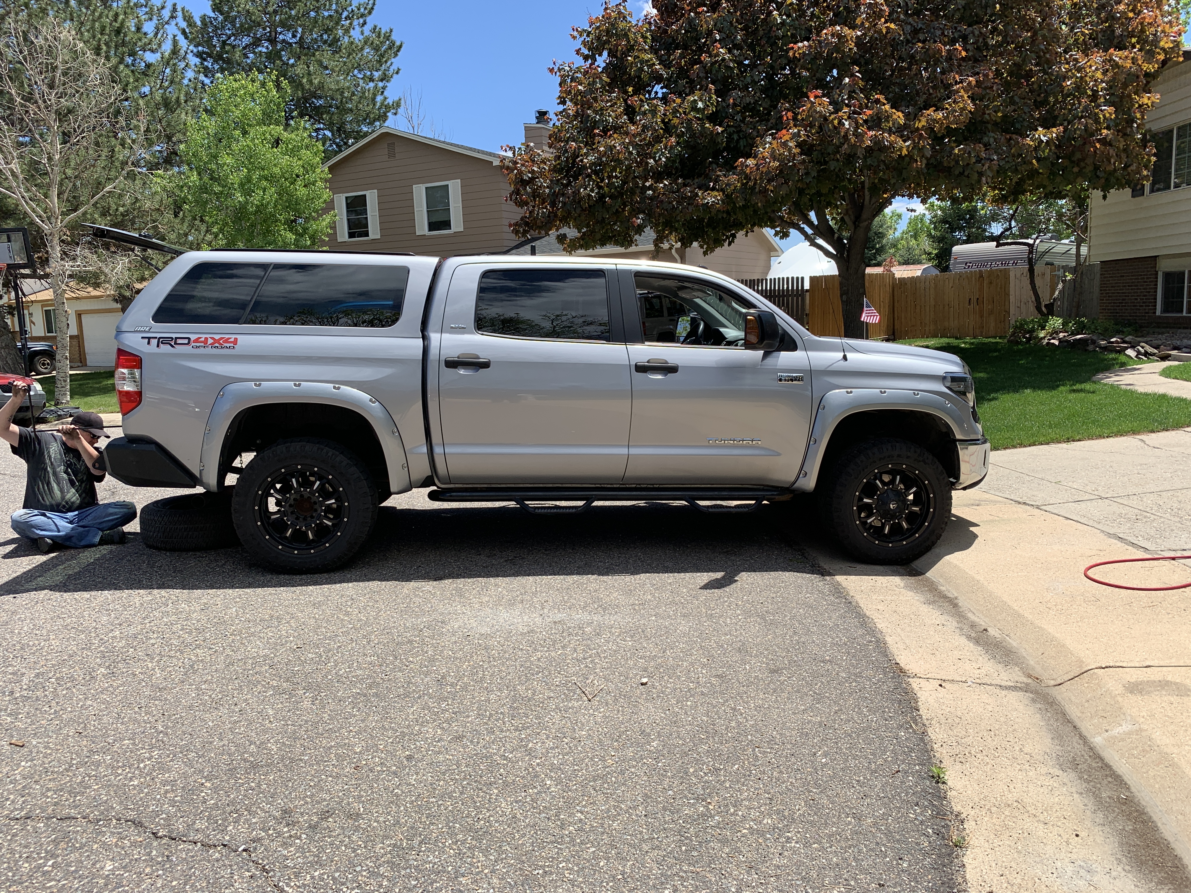

    Second was an upgrade to the rear springs from the stockers (3 leaves + 1 overload + 1" block) to a solid OME Dakar Set(4 leaves + 2 overload) There's ole Deebs behind the truck and another shot of him cutting a seized bushing sleeve off of the shackle!

    vortex Well-Known Member
    4,102
    42
    Westminster, CO
    Thanks for the heads up on the pics... I'll see what I can do to fix that.
    Yeah, 600 mile range on my truck now, lol. TBH though I wouldn't bother filling it up at E anymore, just at a half tank so it'd be just like normal and would have the extra tank running spare. It'll come in handy mostly when I'm towing my camper around... Yeah, I'm gettin old. Got a camper now. LOL

    So did you have to do something special for the gas gauge and warning light? I can see how that would come in handy for towing, but also for being out in the middle of nowhere and needing to idle the truck maybe for some aux power
    4,102
    42
    Westminster, CO
    Oddly, ZERO changes made to any system in the truck other than the tank swap. The sending/pump unit is the stock one. It literally was a removal from the stock tank and direct fit into the new tank. You then had to add on an additional vacuum box alongside the stock one but other than that, everything has been solid. The truck freaked out a bit trying to calculate miles to empty but once it figured it out it seems to be just fine. I've been monitoring the actual OBD2 output via my stereo head unit (Pioneer has some neat stuff in it) so as far as the ECU is concerned, I'm measuring correctly. MPG still calculates just the same as well and did from the start.

    Got the shocks upgraded after that OME setup so no longer running any crap job block lift, it's all suspension!
    Fronts were upgraded with Bilstein 6112 Coil Over set and the rears got the Bilstein B8 5160 Reservoir Shocks.
