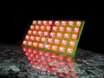

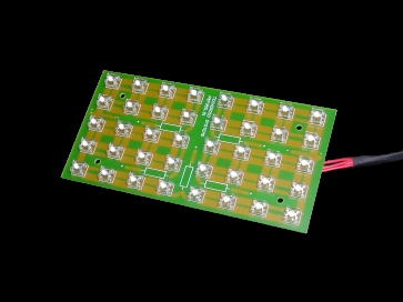

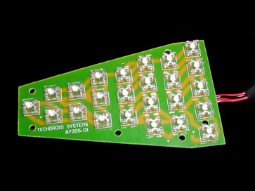

    My hope is not to just change the bulbs of: corners,tails,stop light, but to add a PCB, which will be expensive but have a great outcome.
    Just like you see on the new 2004 models Prius, Rx300, bmws
    This is what im doing
    Heres a PCB for the corners:
    PCB for tails and stop:
    Tails
    The only downside is this shit a pricy mod. $42 for the LED and PCB$24 for just the blank PCB
    Worth it? maybe
