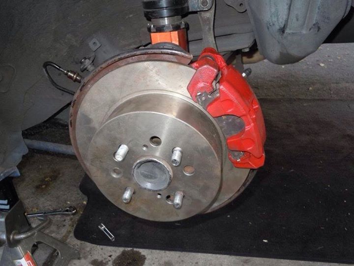

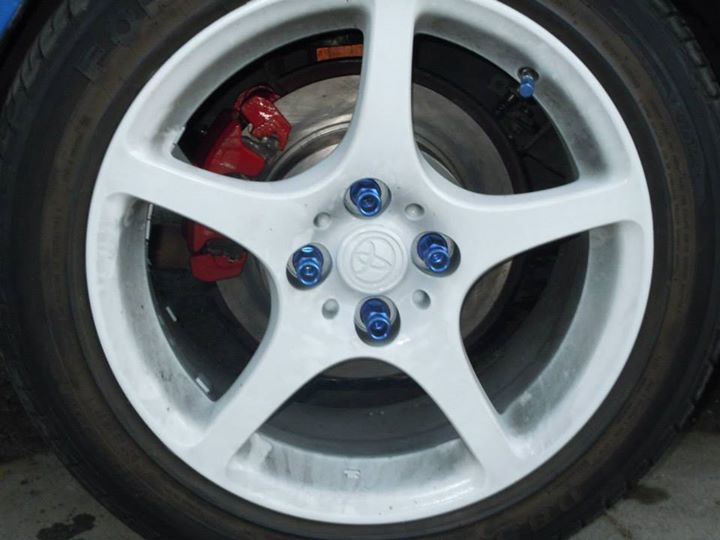

    Rockandrolla New Member
    that is probably the most cheapest way to do a rear disc conversion as i've already done it that way twice..
    10418181_711841518872718_8022502820924838675_n.jpg 1378482_589630071093864_2044919082_n.jpg
    i bought everything needed to do the swap for around $60 from a local junk yard.....then the rotors Milky on the forums sent me a set of disc already drilled 4x100 for some corolla parts in exchange.
