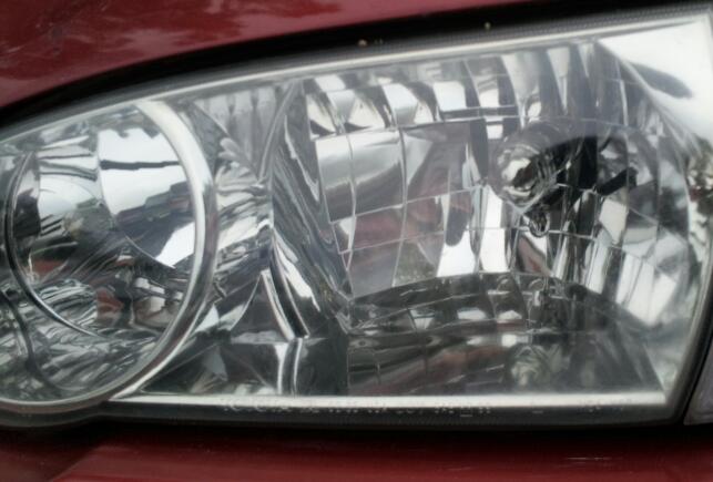

    btw i was checking out 3000 sandpaper
    are you sure that will work? :O it was soo soft
    Well, how else would you make a lens clear by sanding? Yeah 3000 grit it is!

    It felt too smooth :eek:
    2500 grit? Then 3m rubbing compound.
    Or is 3000 the way to go?
    I cant personally vouch for it but;
    Restores headlights and its fucking boss on interior.
    3000 grit is still sand paper. You can't feel the grit, but you don't want to feel the scratches on your head lights.

    3000 grit, and 3m compound = cleanest headlights. Maybe to clean. Pics tomorrow.
    Nice! Yeah you pretty must just had to finish the job with the 3000 grit. Did you seal it with the right kind of wax?

    Used turtle wax xD
    Just thought any type of layer of something would help protect it
    Self-Owned.
    Definitely make sure to either use a clear coat or a special head light UV wax, I grabbed a bottle of the Meguiars. Or, you can just wax it up like once or twice a month. Regular wax doesn't last all that long.
