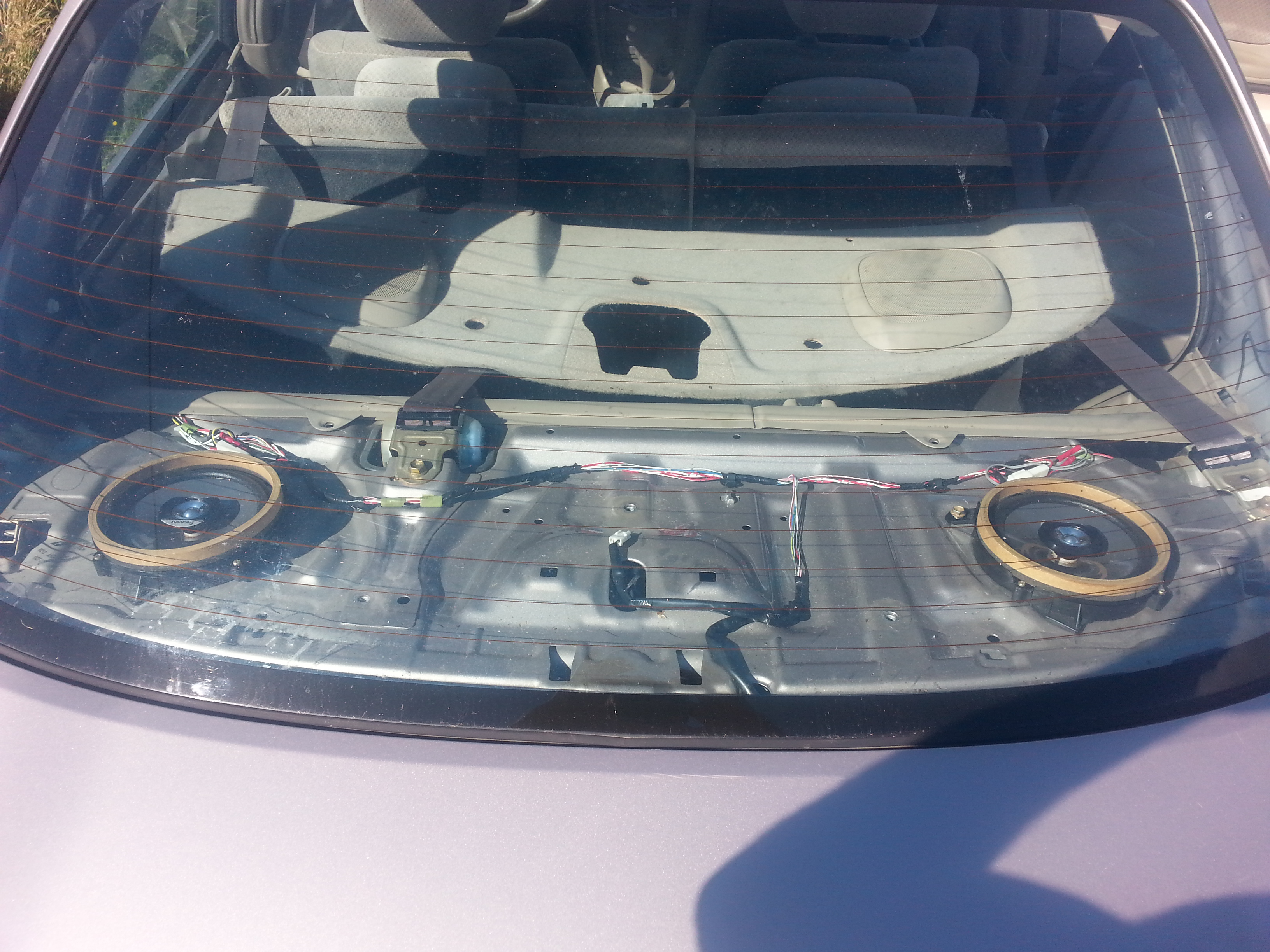

    I also debadged the trunk since one of the letters in COROLLA was missing, i have just the toyota logo now.I 'tested' the pass rear window and it now rolls up and down.I removed the rear speakers yesterday and am going to remove the stereo today since this should be here tomorrow.

    Installed the stereo and speakers today sounds good

    what brand are they? glad enjoy it man
    pionner is not bad man, i use them on my car after i take my sound system off

    Yeah its pioneer gear, front speakers are still stock might upgrade in the future.It sounds great!
