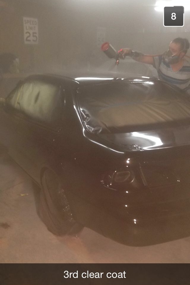

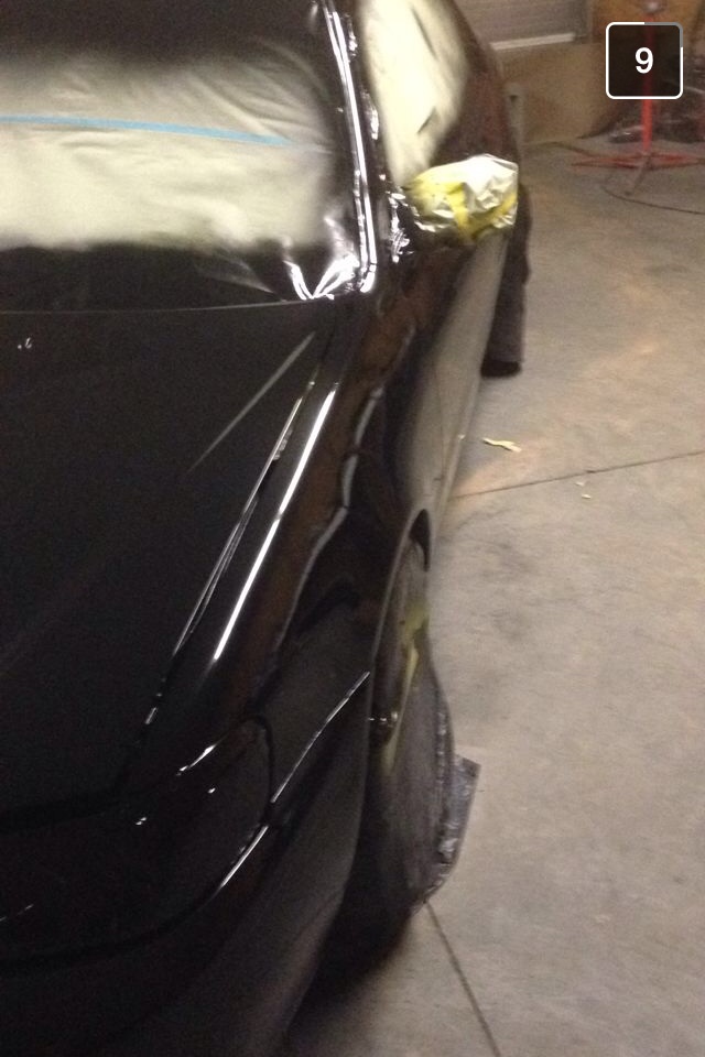

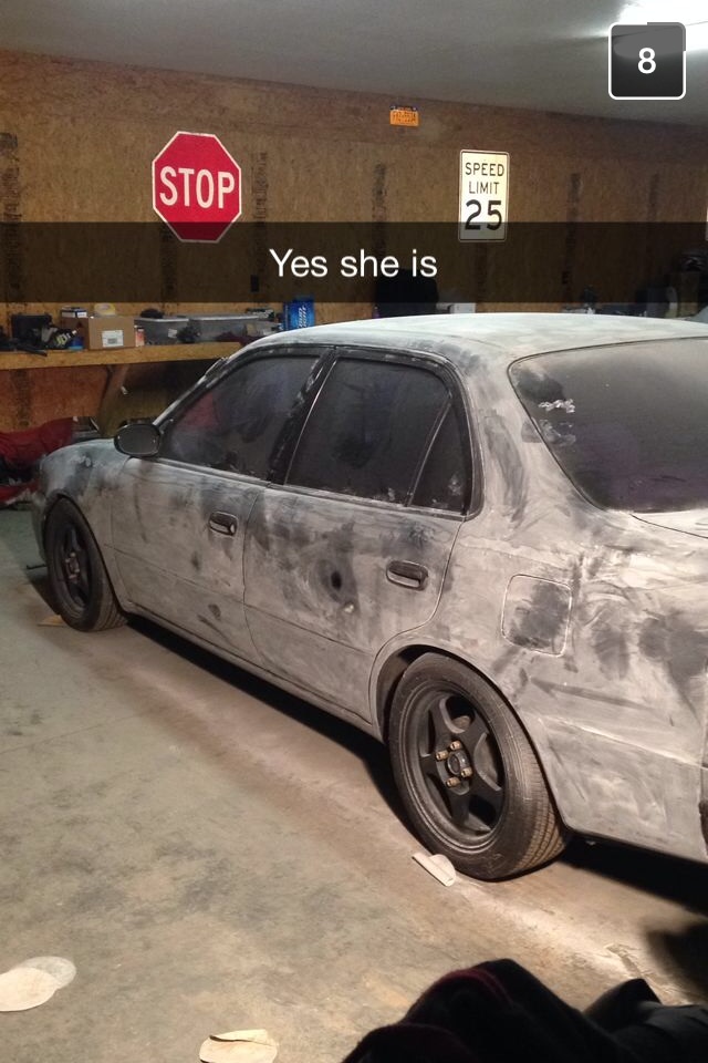

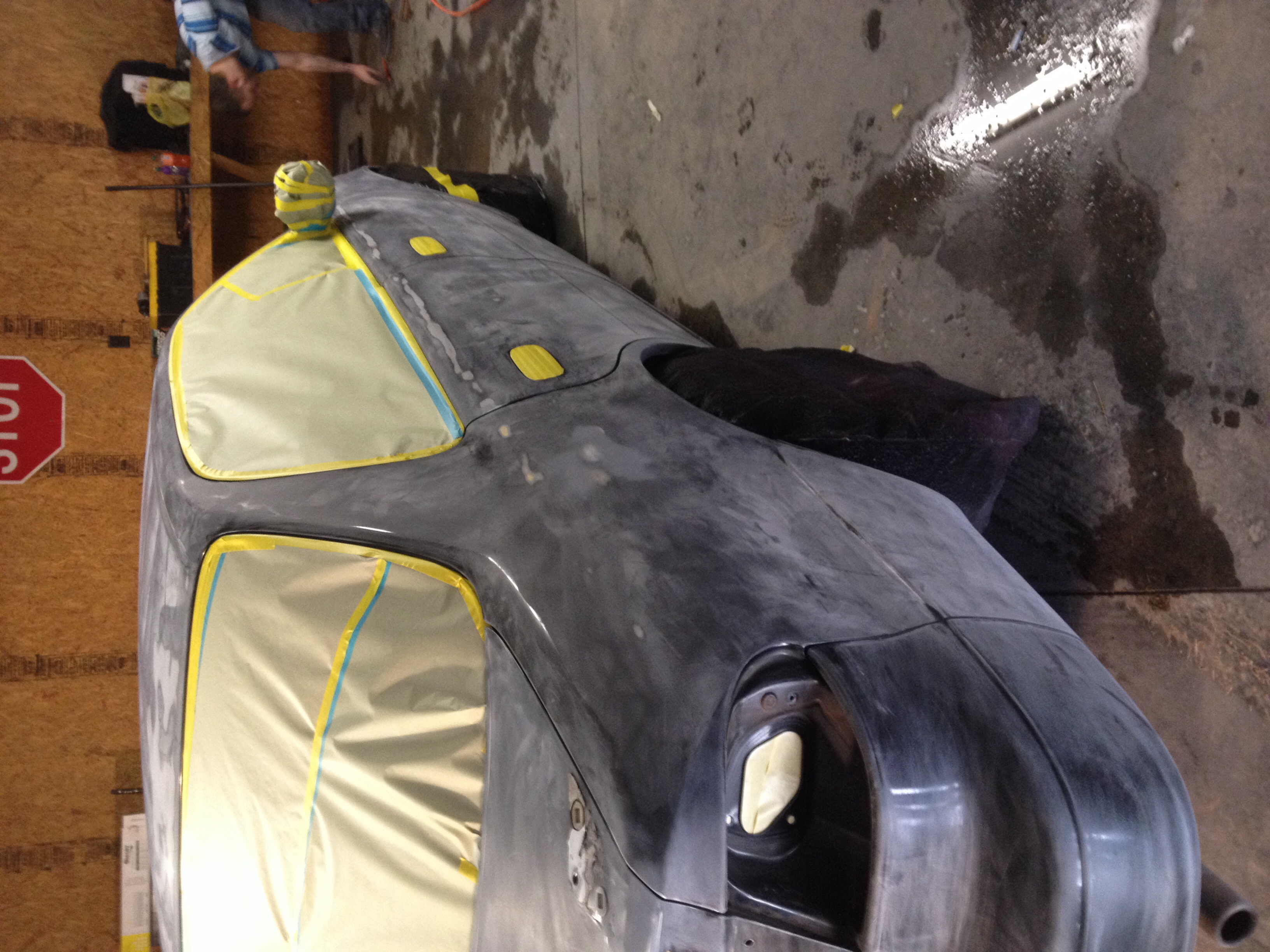

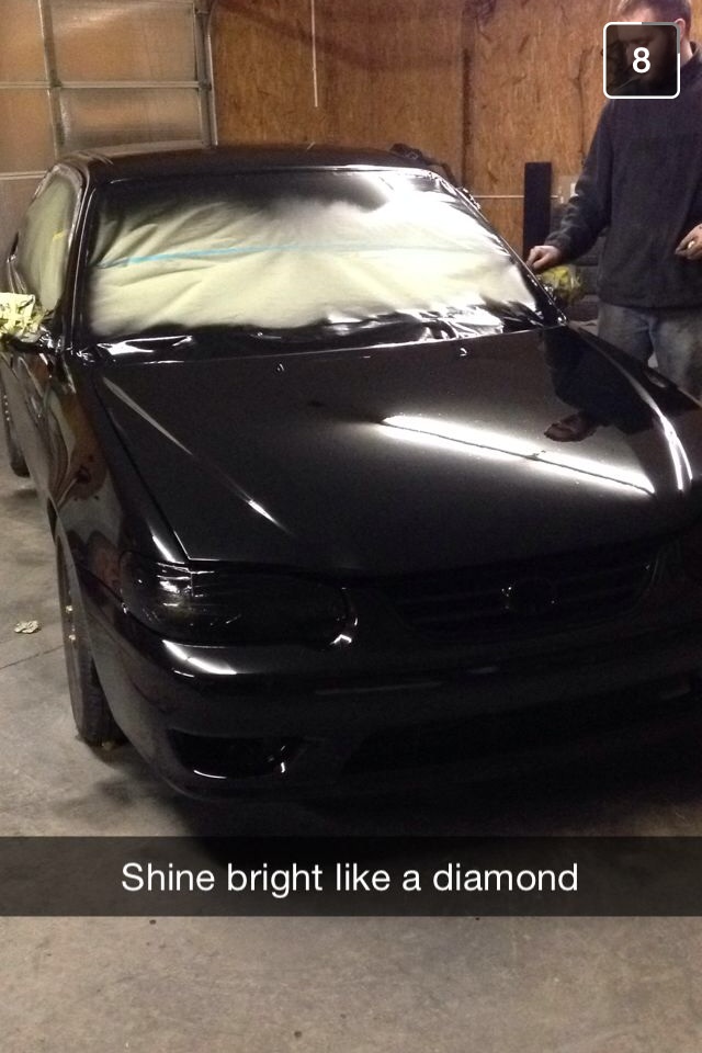

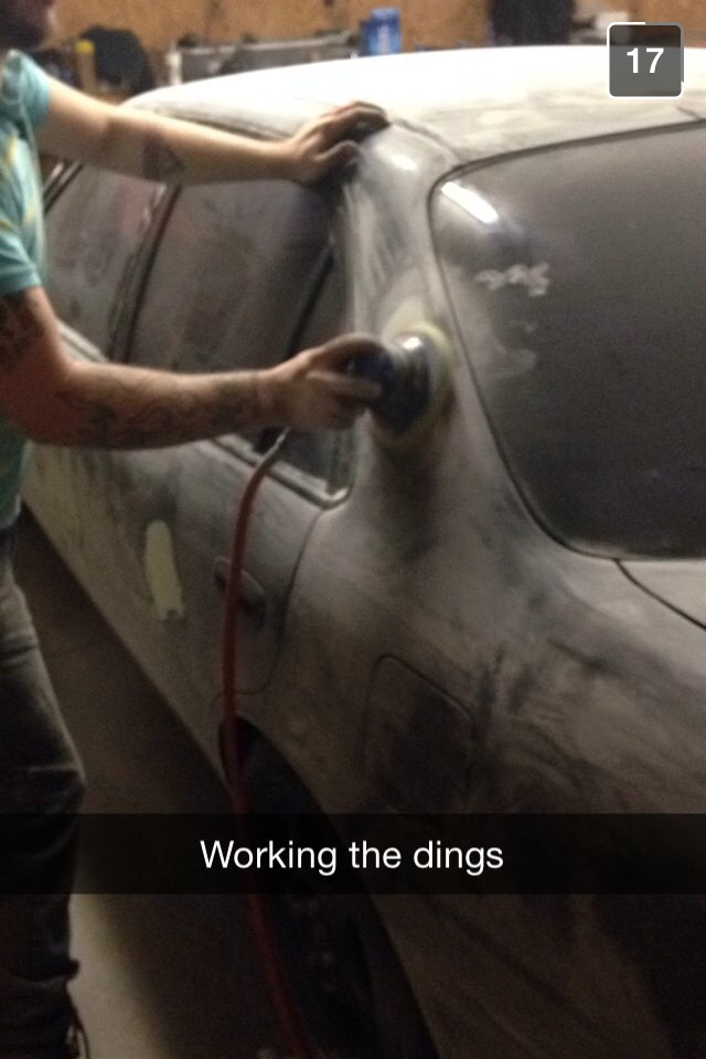

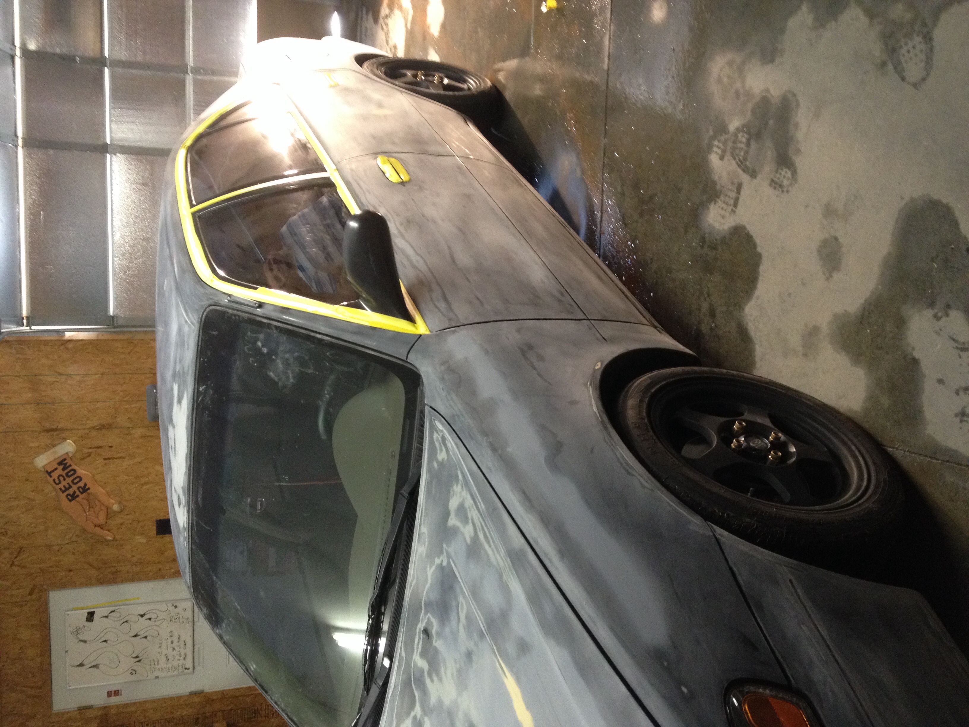

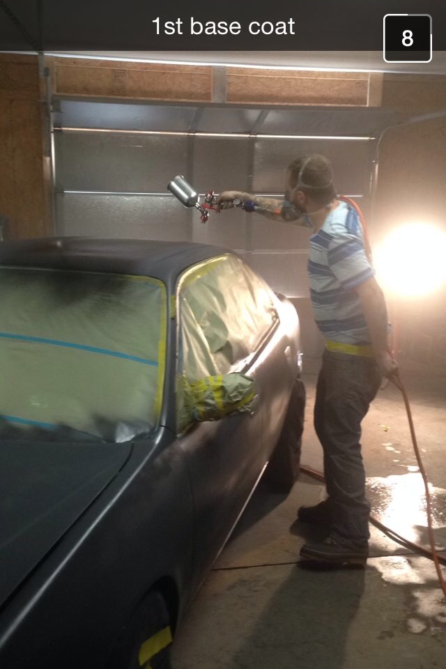

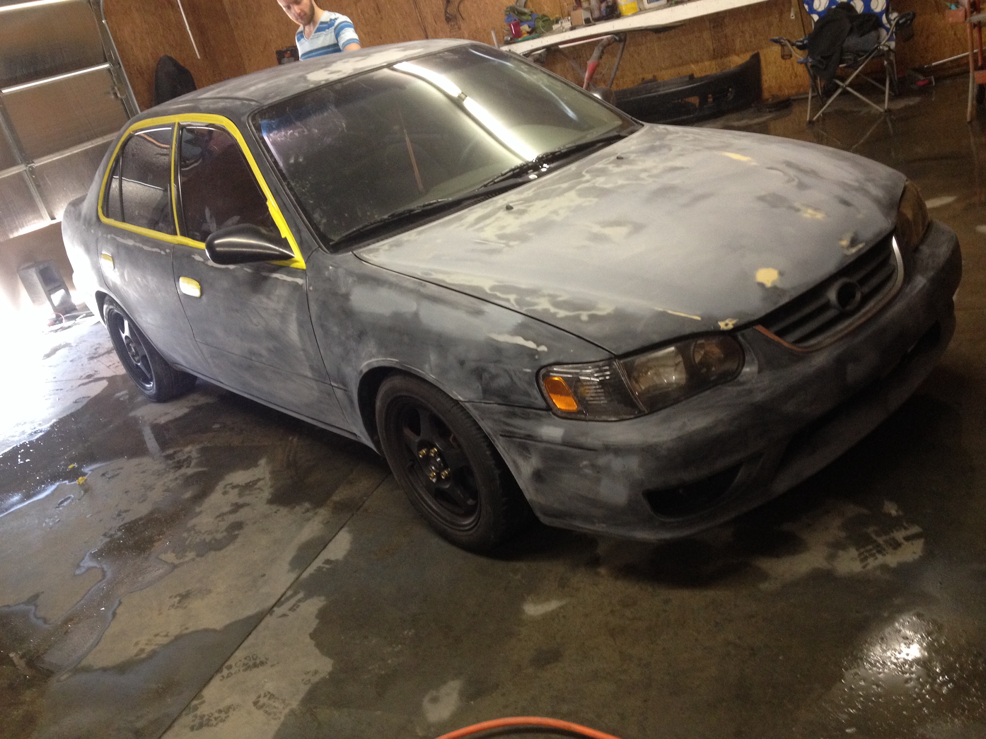

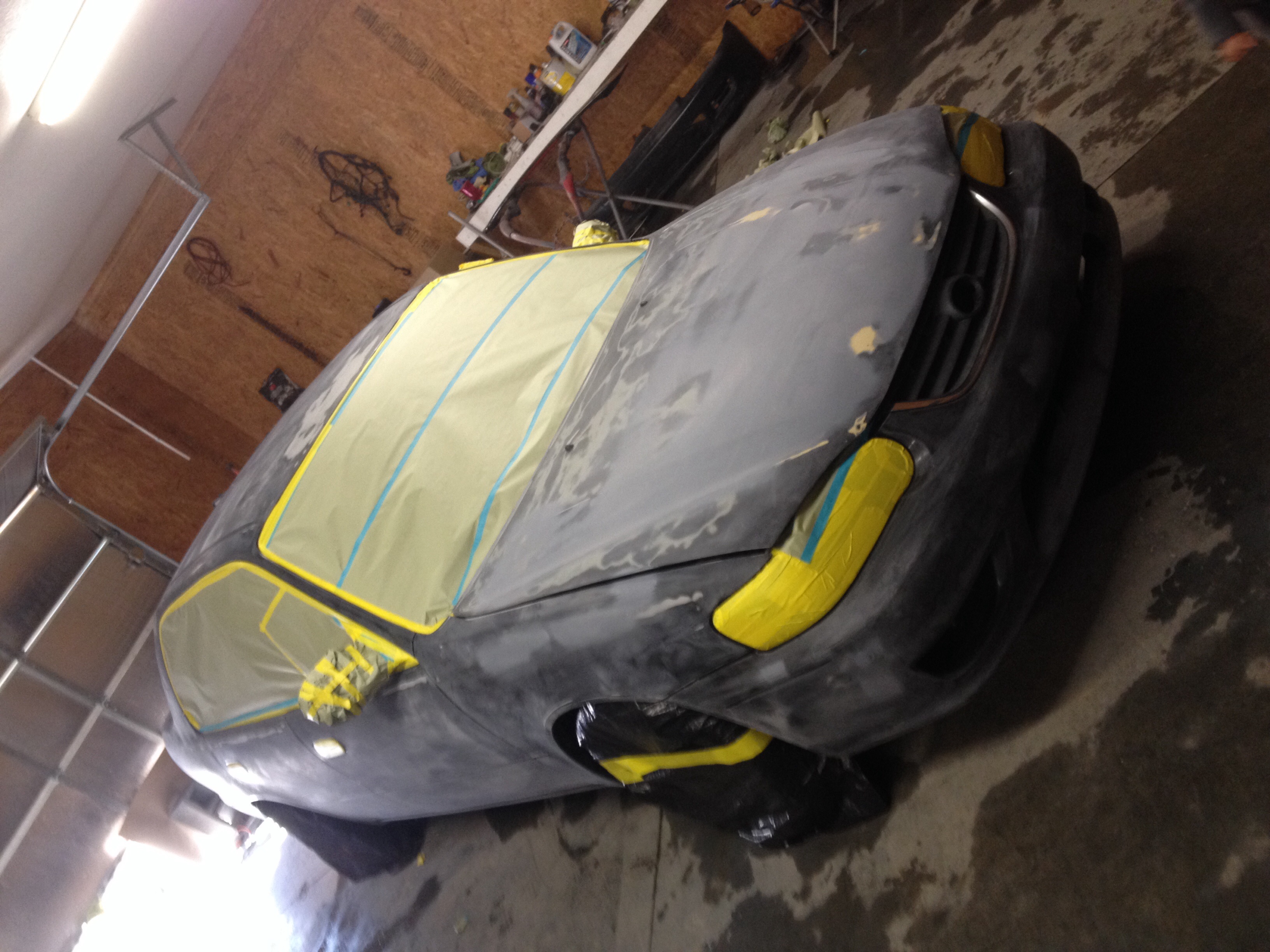

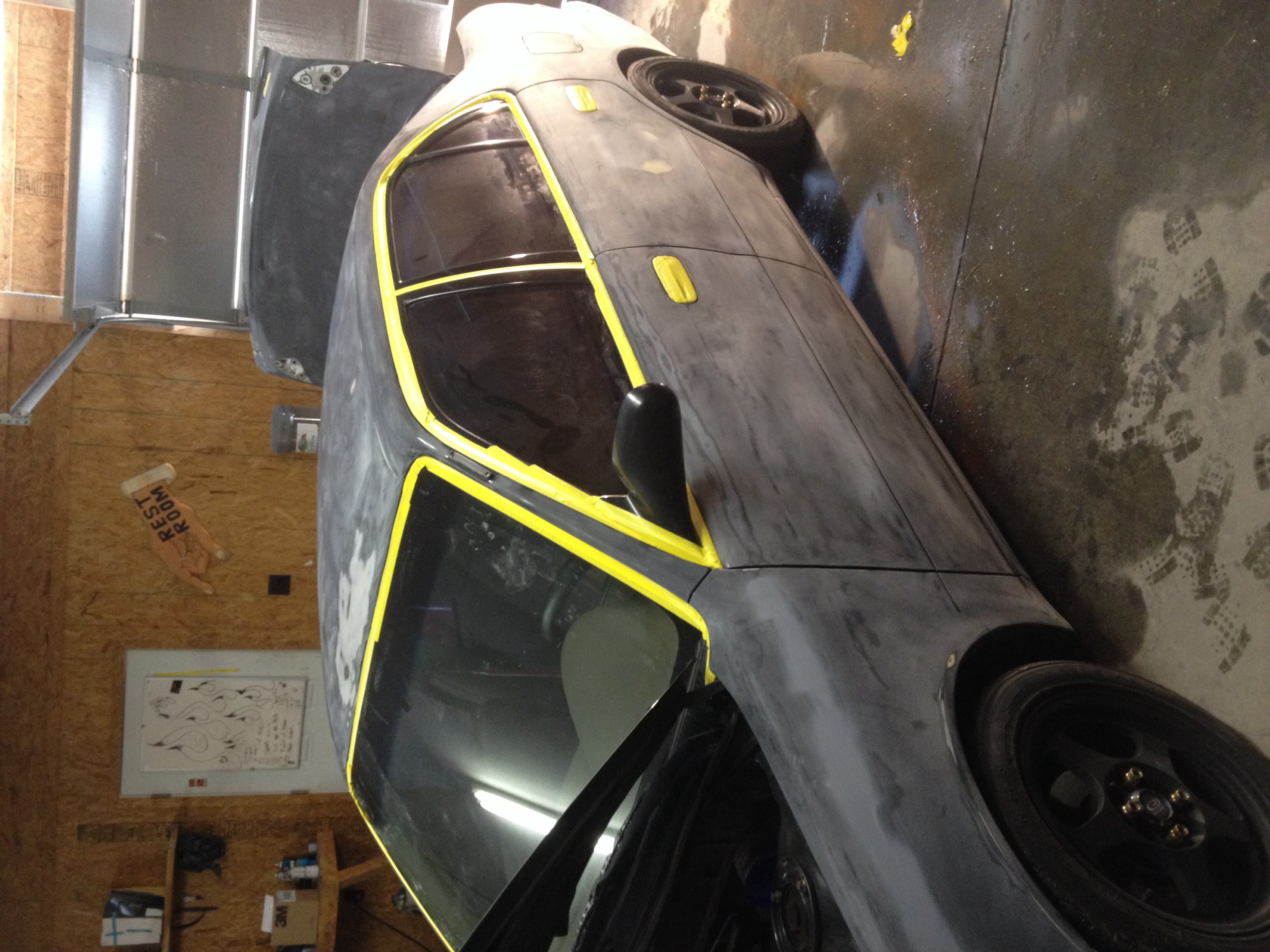

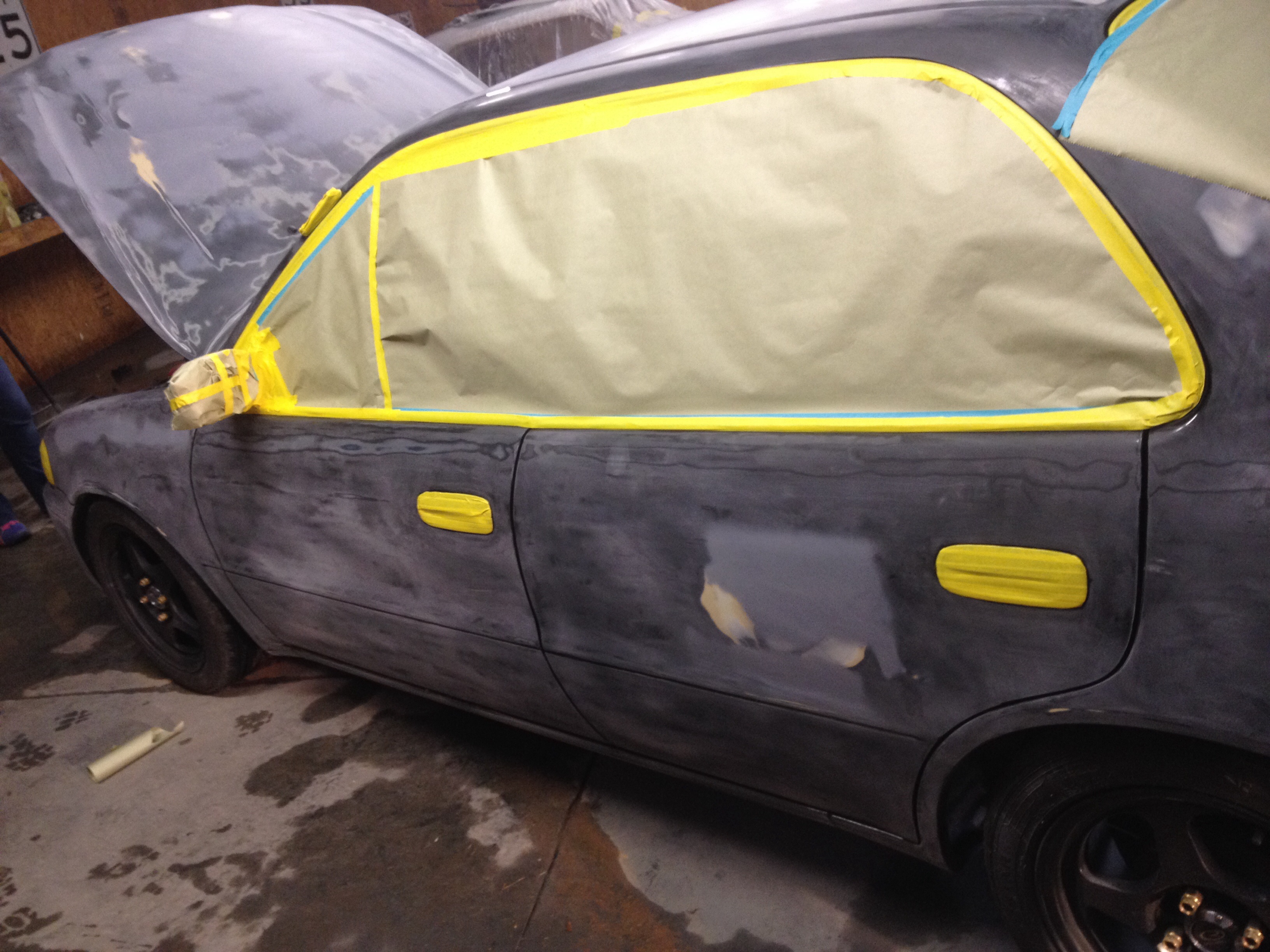

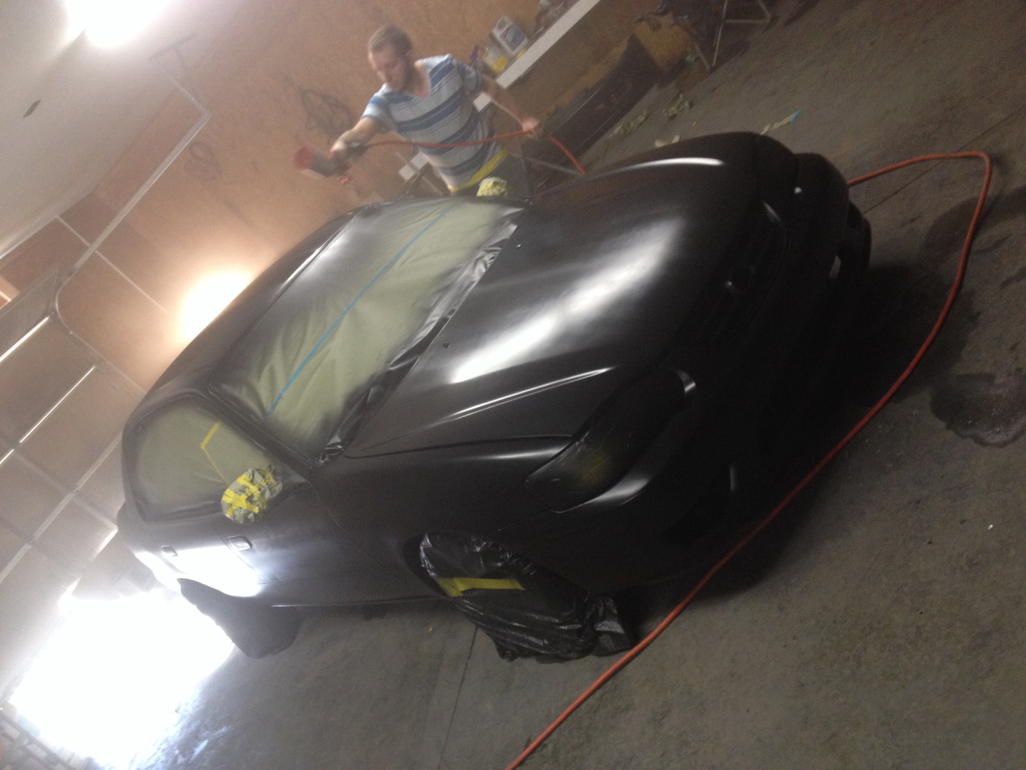

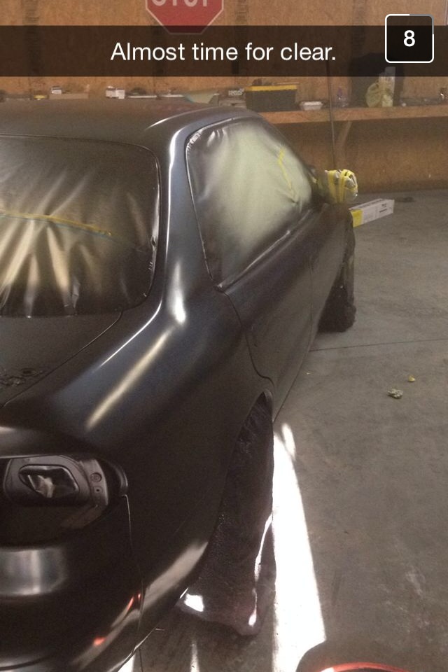

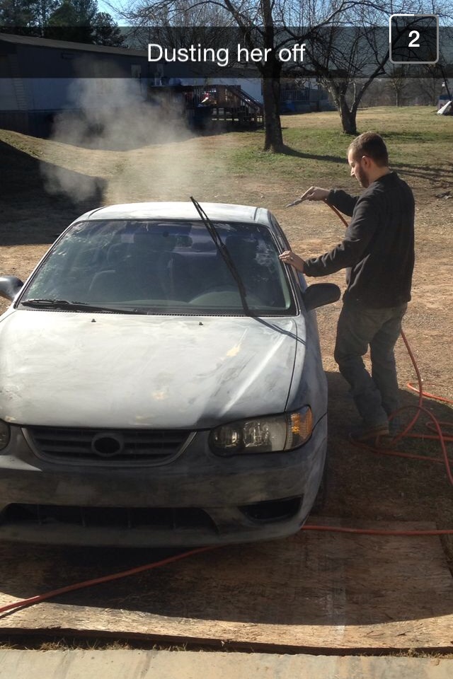

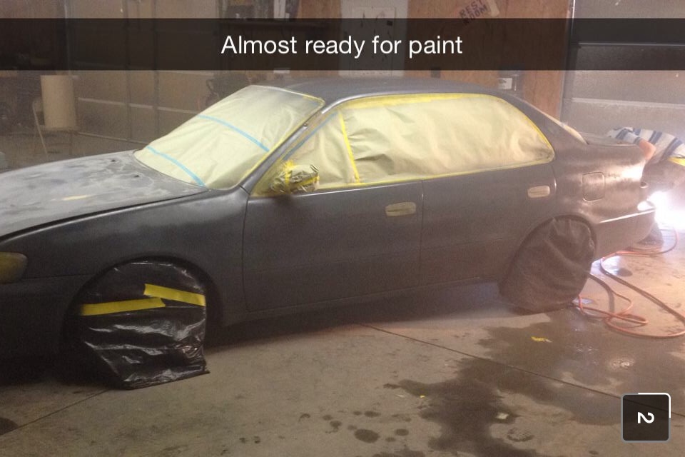

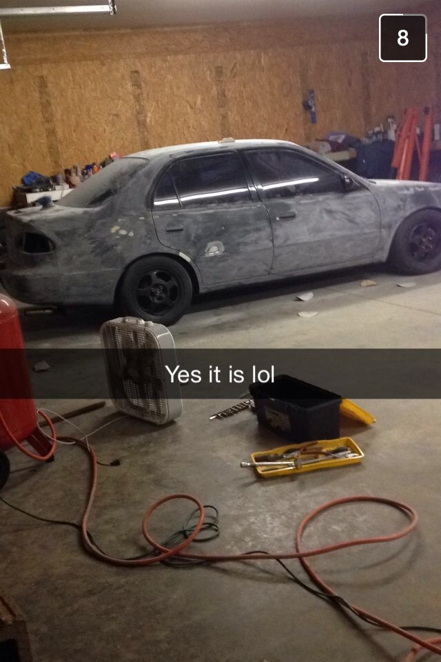

    Dropping my car off to be painted base clear black 202, I'll be getting her back Sunday!
    935
    305
    ahh fresh paint how much did it cost ? and what are they doing prep , single stage ?
    jdmgen8 Well-Known Member
    554
    51
    Spartanburg, SC
    2002 Toyota Corolla CE
    It's a buddy of mine has his own shop, I bought the paint and supplies from finish master which cost 335 and I'm paying him 200 to do it. It's gonna be base clear he's sanding and fixing the dings with dolphin glaze then priming and doing 3 coats base and 3 coats clear.

    That would be nice, integra type R white is nice also think it's champion white or championship white. Here's some pics of his progress on my car so far.

    Ok got some pics of the car it's finished just drying so I can pick it up tomorrow looks amazing, will have some more pics when I pick it up.
