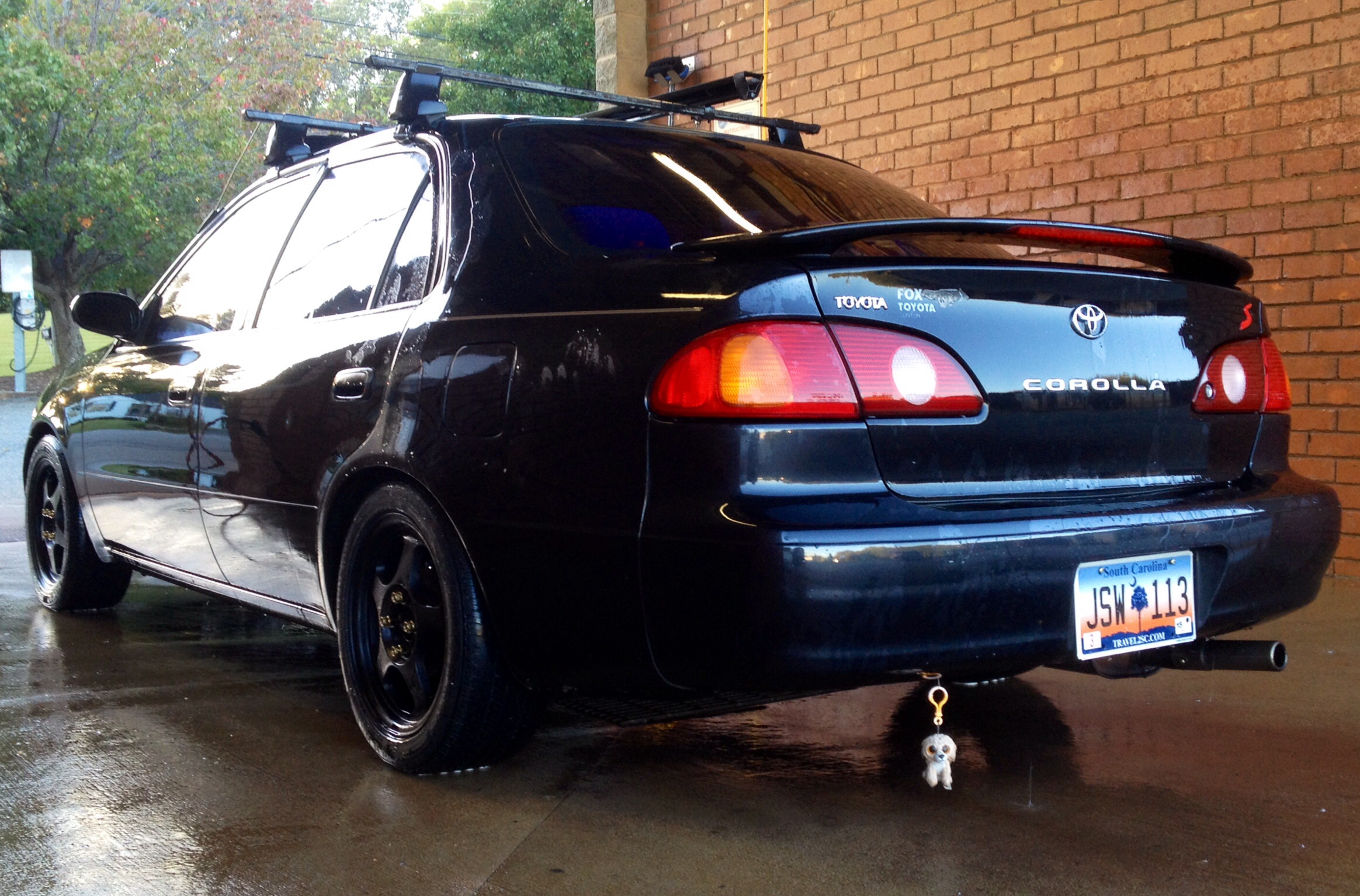

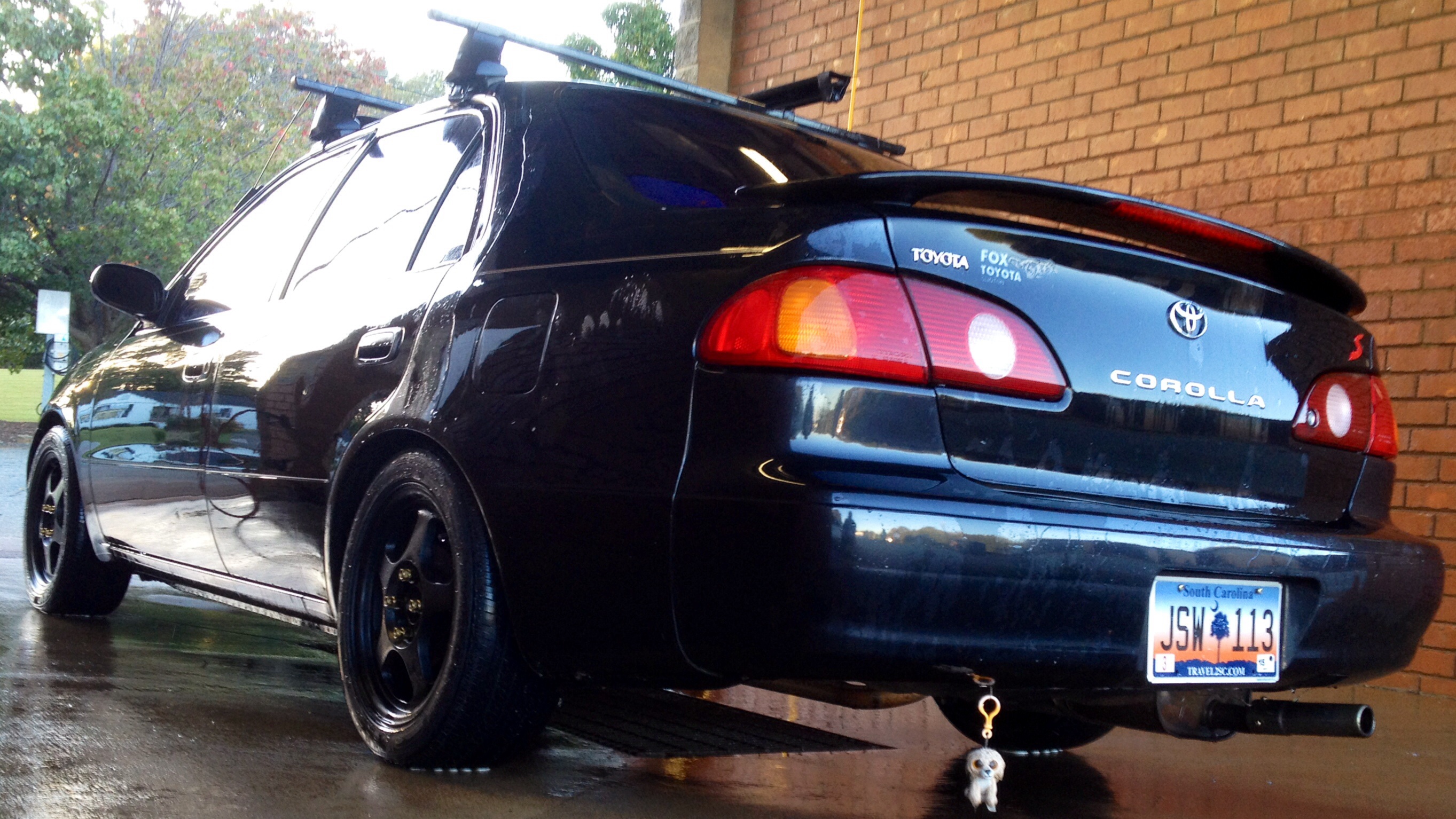

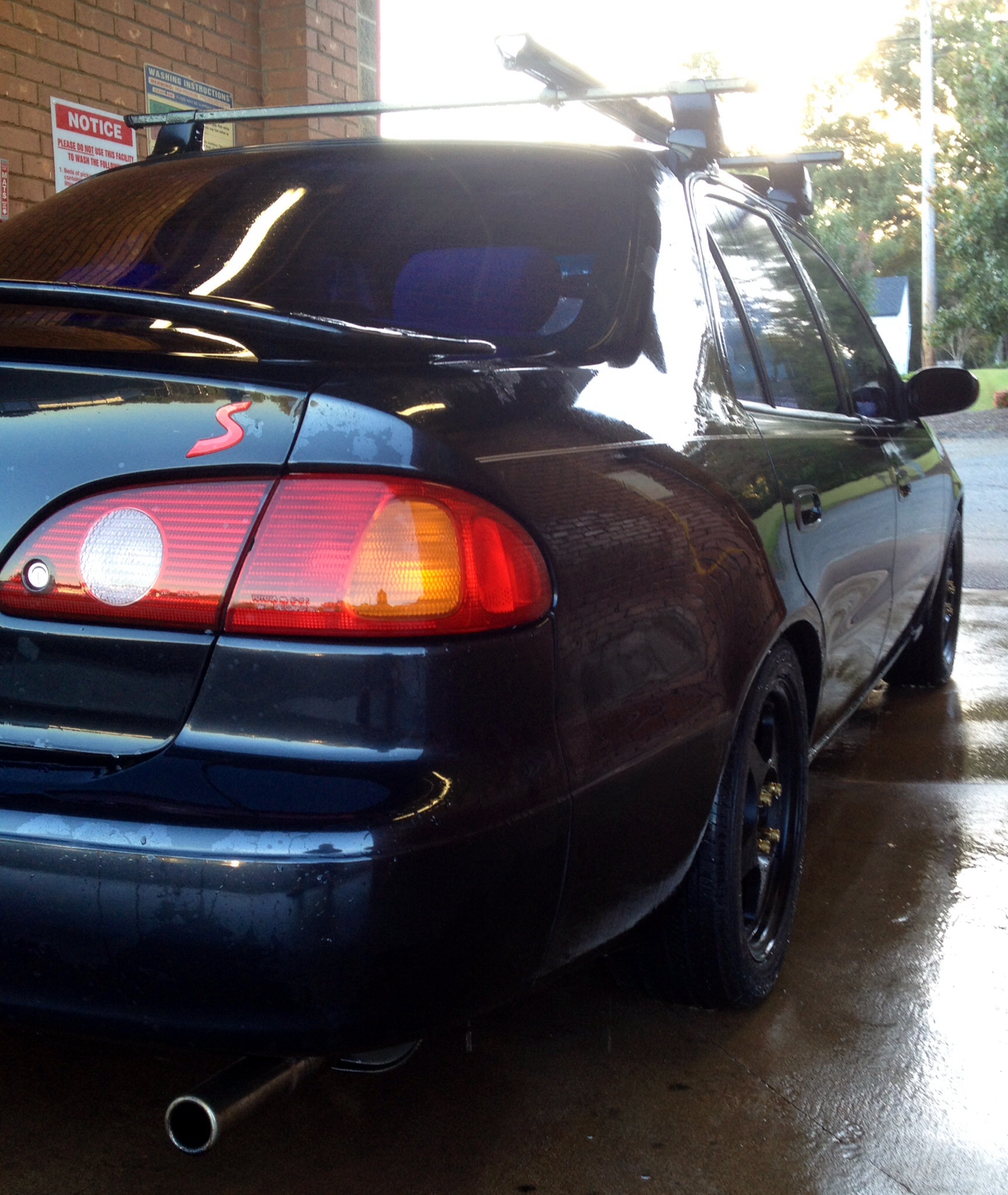

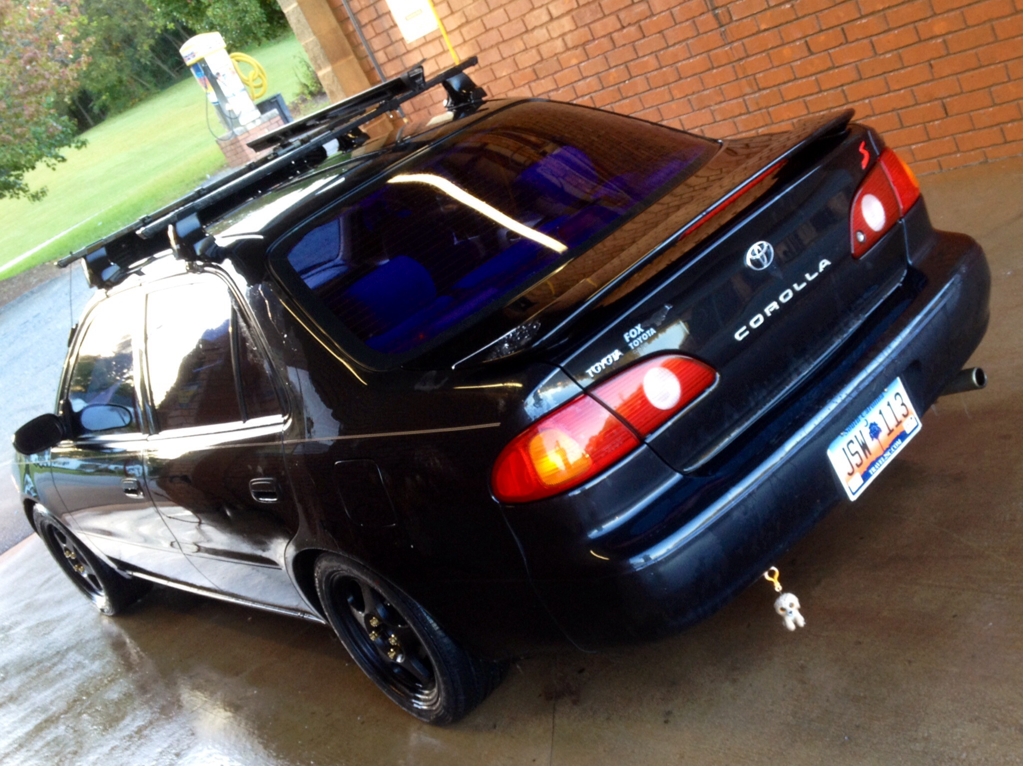

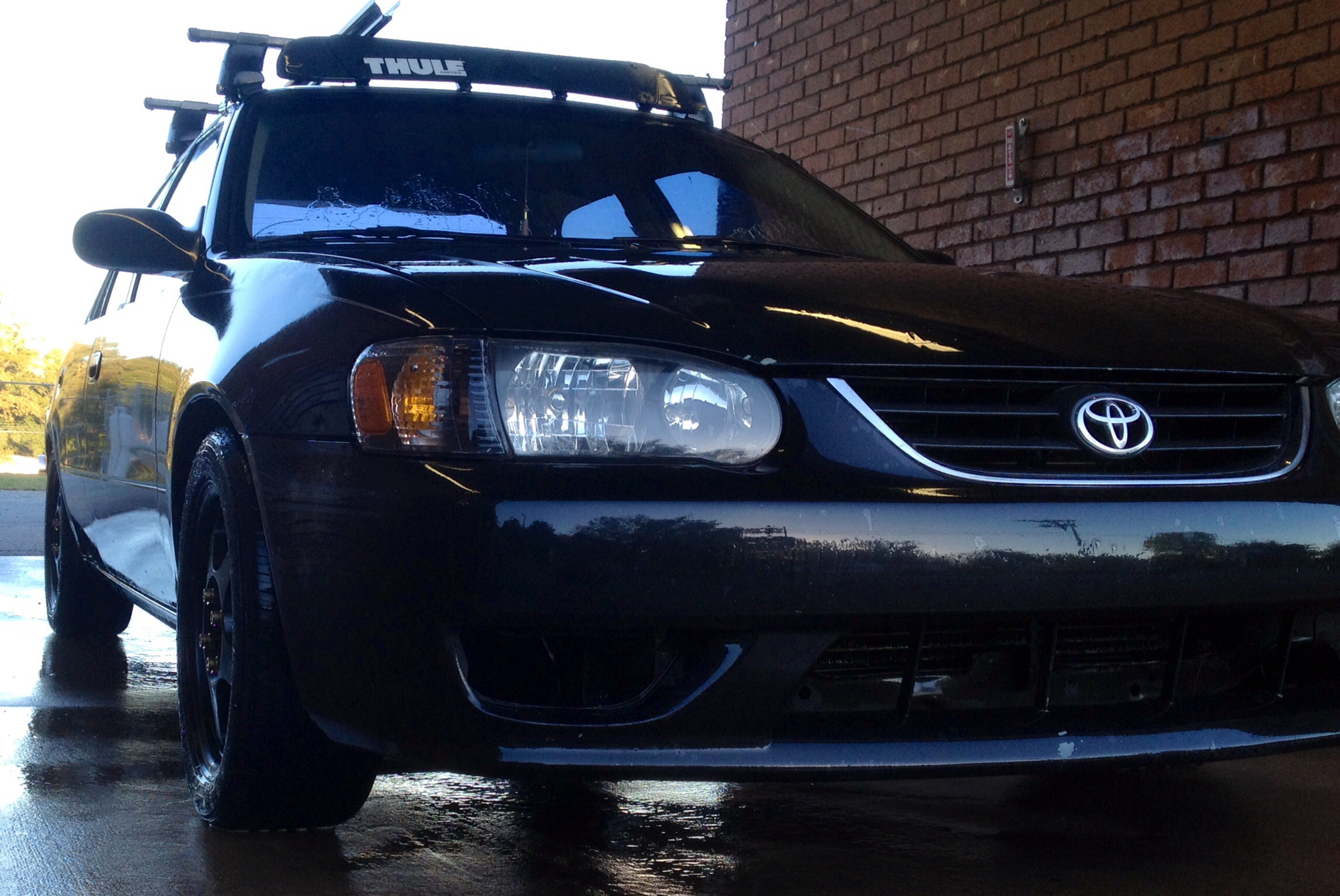

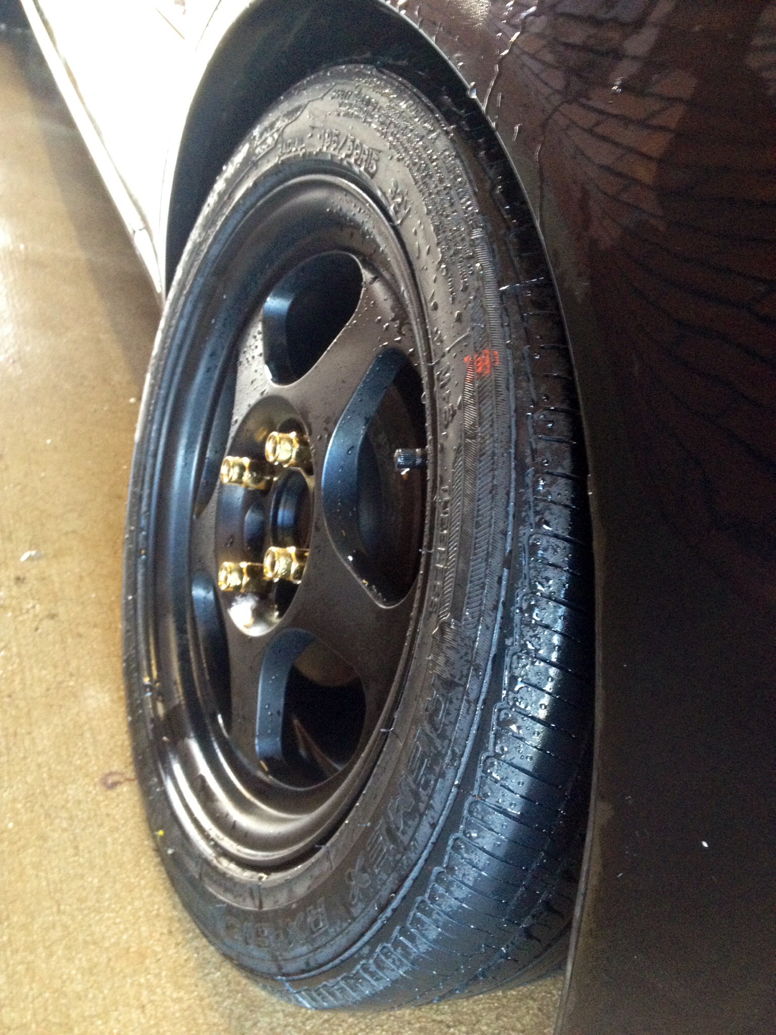

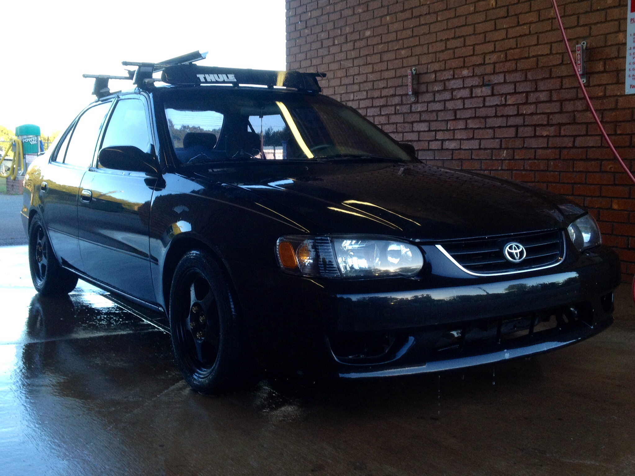

    Ok finally made some progress got my suspension and wheels on then took it to the car wash.

    Thanks gold glad I was able to finally get it done.

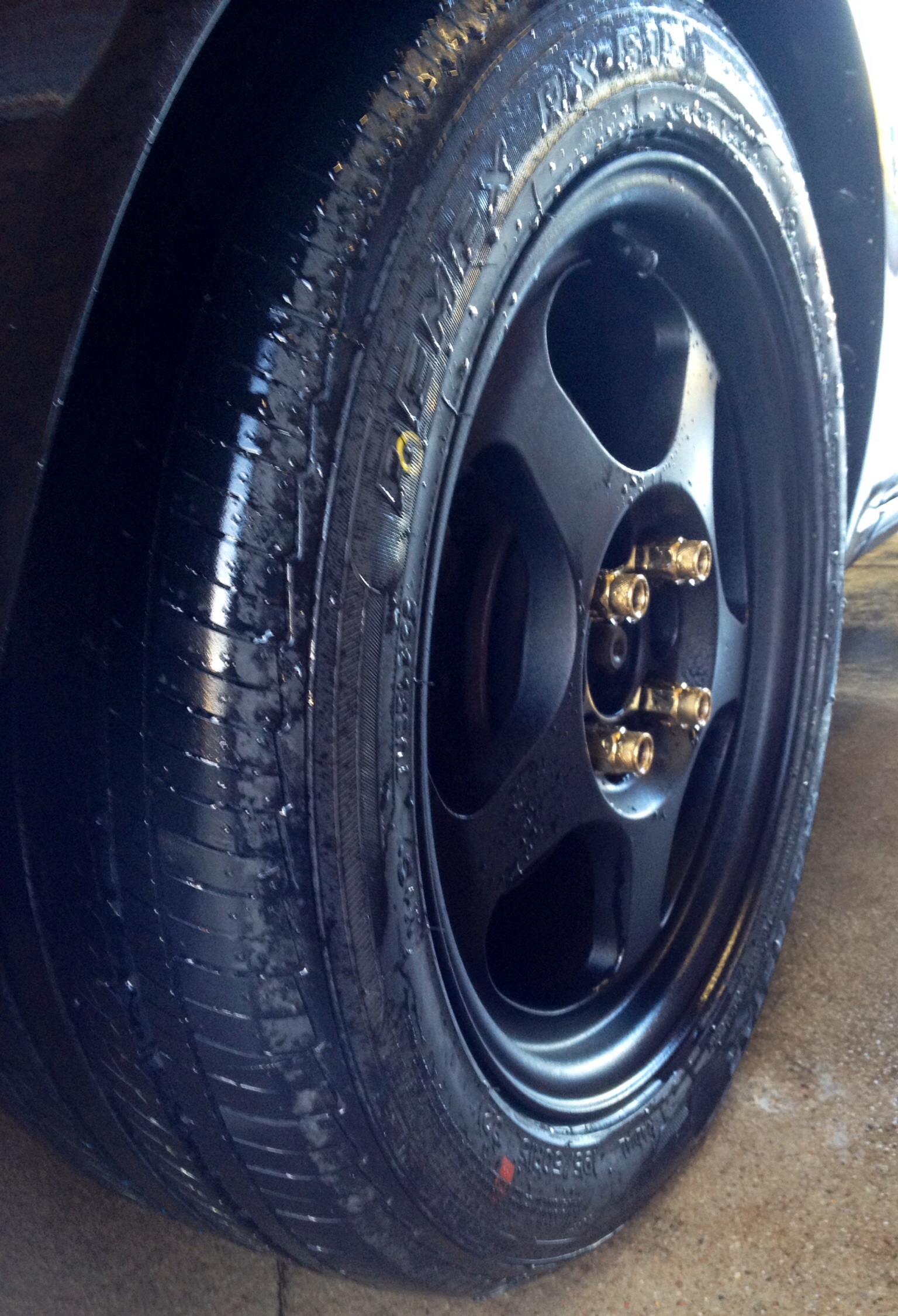

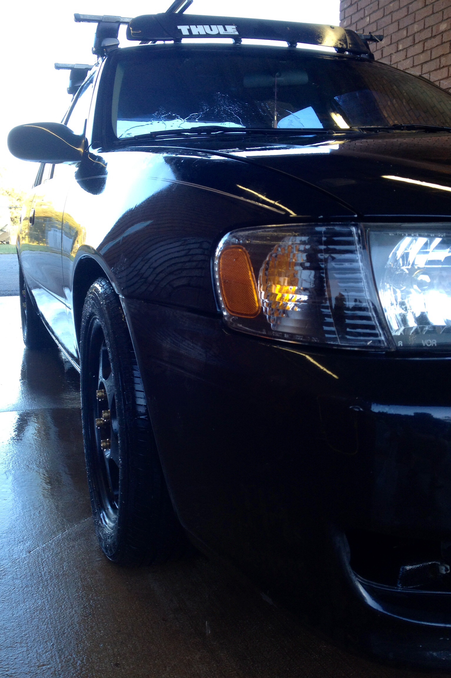

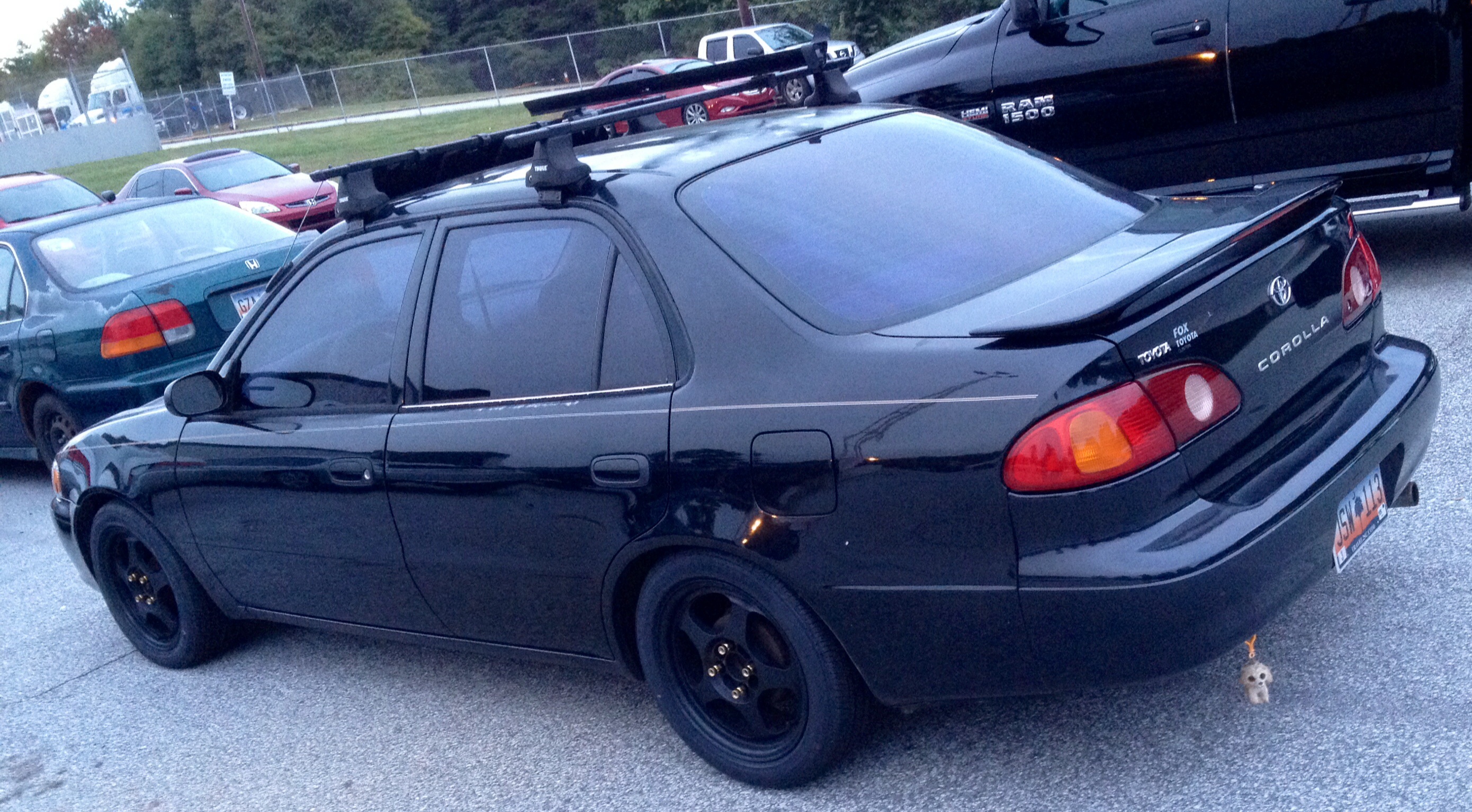

    Couple quick pics after work today
    Time to buff that hood
    jdmgen8 Well-Known Member
    554
    51
    Spartanburg, SC
    2002 Toyota Corolla CE
    I'm having it painted before the end of the month so that will be taken care of lol

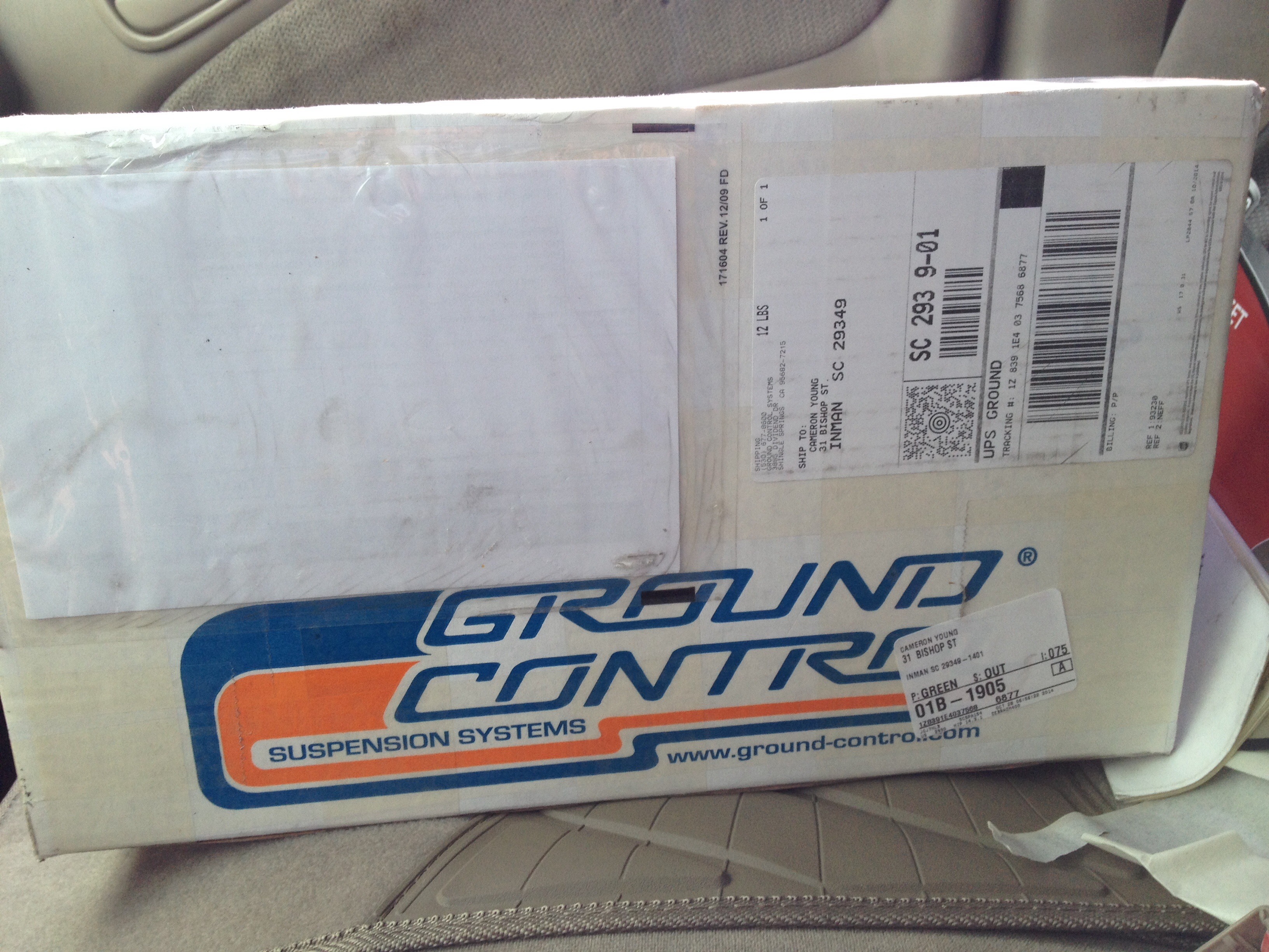

    Well I just ordered the ground control coilover kit to go on my konis, the teins just didn't make my car sit the way I wanted it to.
    yeah if the shocks are wack, springs won't work right lol
    554
    51
    Spartanburg, SC
    Lol yeah except mine were brand new konis
    weird...
    554
    51
    Spartanburg, SC
    Yeah the front still had way more wheel gap than I wanted the rear still sat lower it just didn't look right.
    You sure you got the springs on the right way lol
    554
    51
    Spartanburg, SC
    Lol yeah I'm positive I do there was another guy on here that had the same problem I forget his name but he ended up putting the stock springs back on there rear and left the teins on the front that was the only way to level it out idk doesn't make sense
    MP220 Well-Known Member
    43
    108
    CT
    2001 Toyota Corolla CE
    I think your ride height is actually level, I'm guessing the offset of the fender is giving the illusion that it's sagging in the rear. On all 4 stock springs, it has the same effect, just with more gap lol
    554
    51
    Spartanburg, SC
    Yeah it looks exactly the same as stock except lower, if that makes sense lol but the ground control kit should fix that problem.

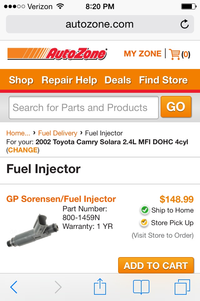

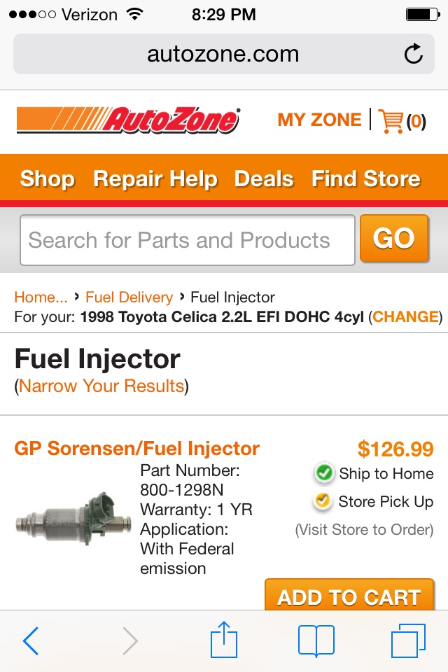

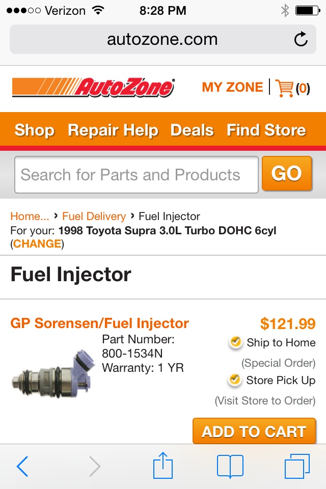

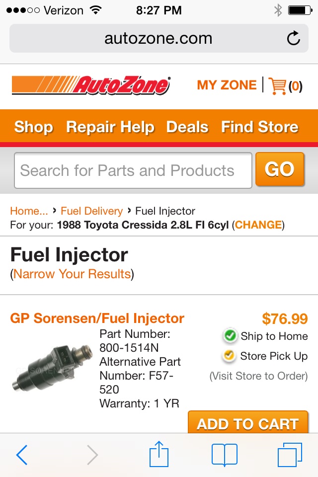

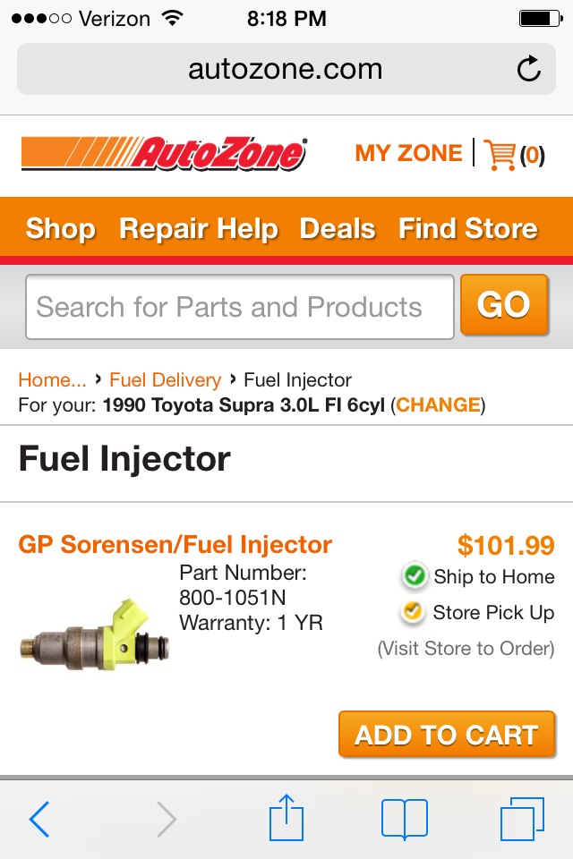

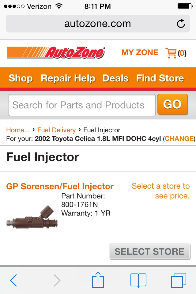

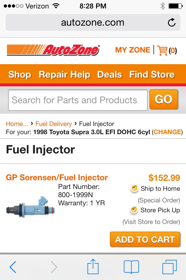

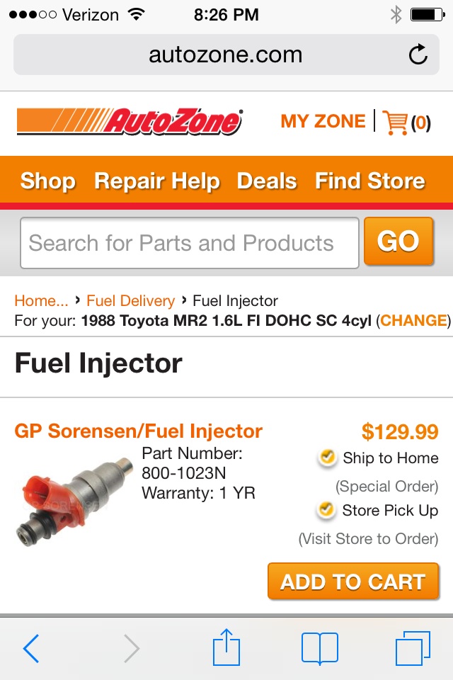

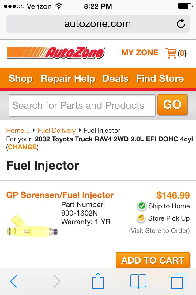

    Will any of these fuel injectors work as a direct fit upgrade on our cars?
    image.jpg image.jpg image.jpg image.jpg image.jpg image.jpg image.jpg image.jpg image.jpg image.jpg image.jpg image.jpg
    554
    51
    Spartanburg, SC
    I guess a simpler way to ask is there any other bigger Toyota injectors that are a direct fit on our cars like a 315cc or 440cc?
    554
    51
    Spartanburg, SC
    I have plans to boost and just need some bigger drop in injectors, really don't think anything bigger than 315cc is necessary. I've read our stock injectors are around 200cc so anything bigger than that should work with the right fuel management. There should be an injector Btwn 220cc and 300cc that will fit I just don't knw what car that would come from.
    Yea you can use the lotus exige 440cc injectors. I also think the scion tc injectors are 350cc or something like that and those are plug and play also.
