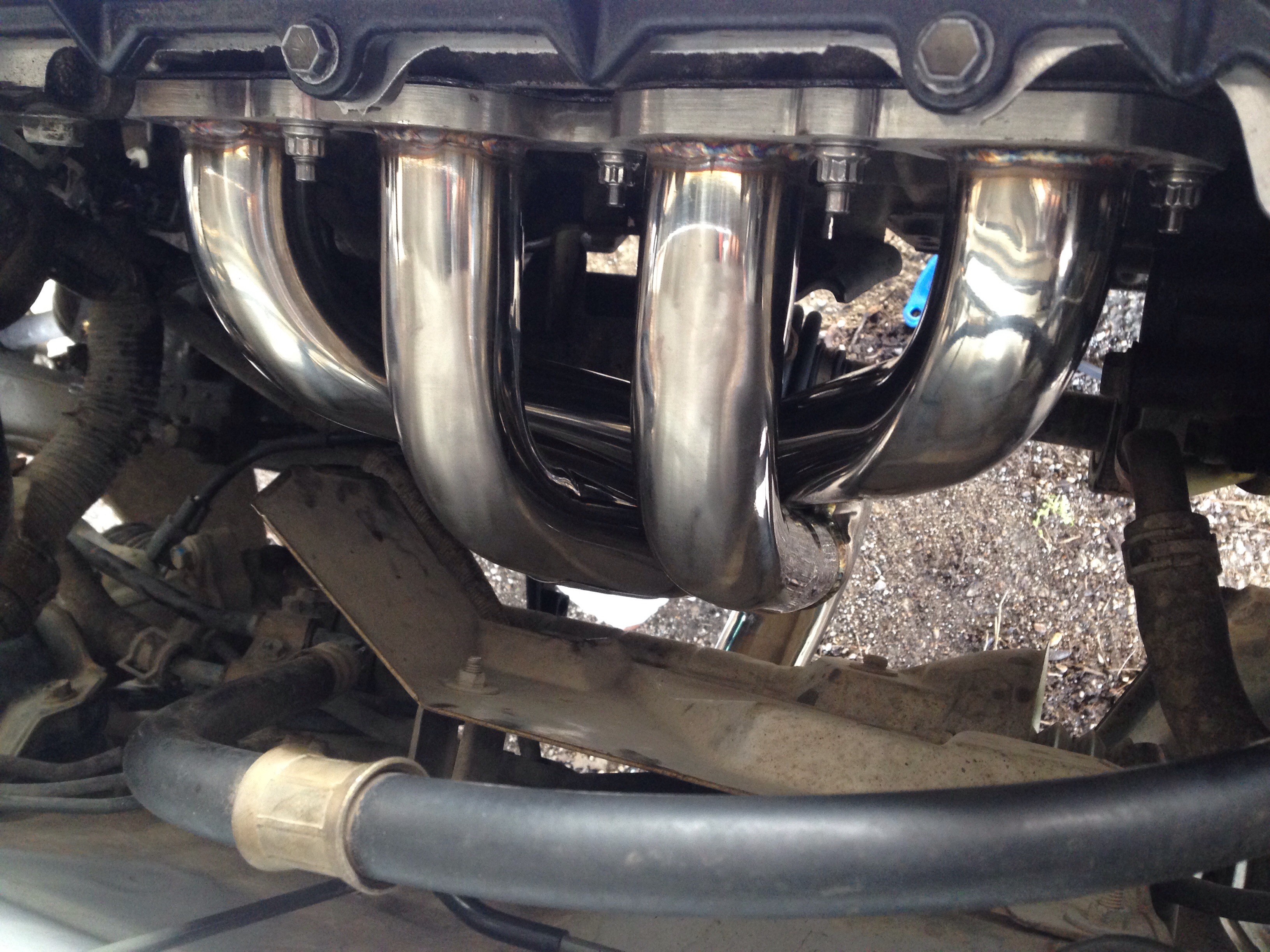

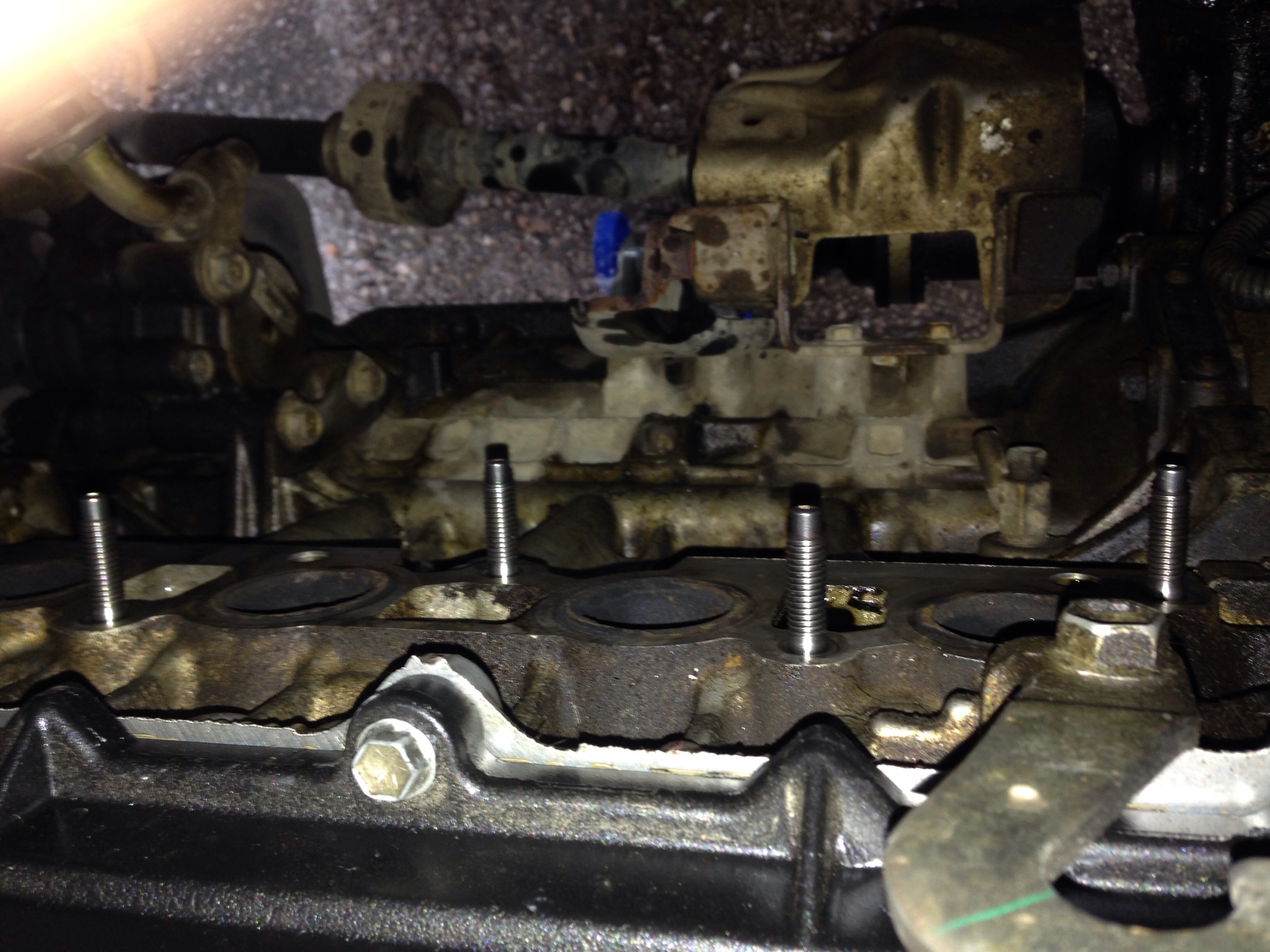

    Ok answered my own questions, Monkey wrench racing arp header studs for 1zzfe are nice, long term I'll have to update on them staying tight. image.jpg image.jpg
    And for the OBX header, people who are noticing it because of the factory dent. Just file it and put a back up SS band clamp for extra security. Works better than making a leaky notch in the pipe. I was going to add a flex pipe, but I used the speed source motor mounts instead. No flex, but just like everyone says vibes the teeth a little. I may drill holes?
    33
    Ballerado
    8thgen Corolla
    Sorry, I'll explain file it = file the factory dent that Toyota smacked in there

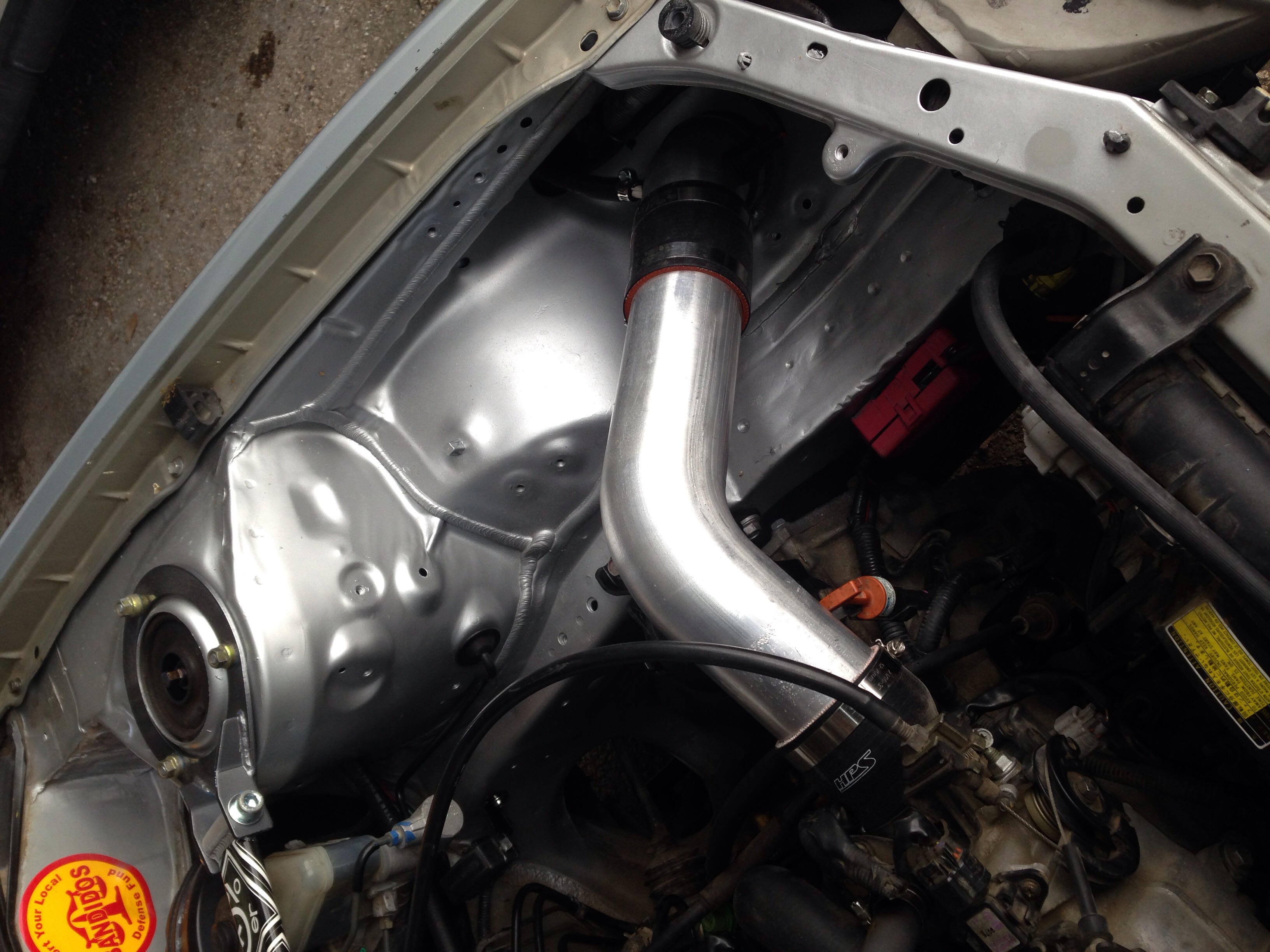

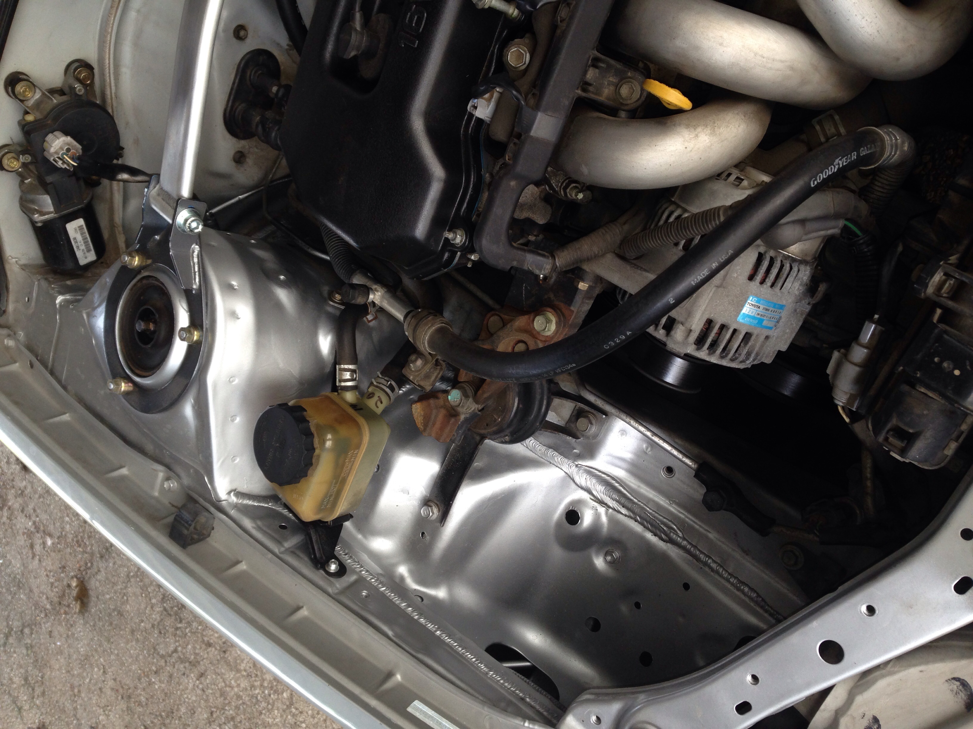

    Nice! looks good man. What do you mean deloomed engine? You mean you shaved/wire tuck your engine bay?
    33
    Ballerado
    8thgen Corolla
    Same thing, technical term is Deloom. I still need to move my power steering res, and work on hiding the injector wires. But it's getting here.

    Still deciding. A lot of your cars look good but......I'm a over achiever so you may have to wait a little. I can give you my current 3 projects.
    1. Finish Deloom- still have PS res, main engine area, and radiator fan area to get clean. Sides are mainly done. It took a while cause i made splash guards for everything in the bumpers.
    2. I am going through ever panel with RTV, dynamat, heat shielding. Rattles be gone
    3. Interior- I have a box of rare ae101 parts and random Corolla years that I am putting in.
    But I will do coilovers, maybe bags? And going with black diamond steels 5" backs pacing that should be flush with a slight fender roll.
