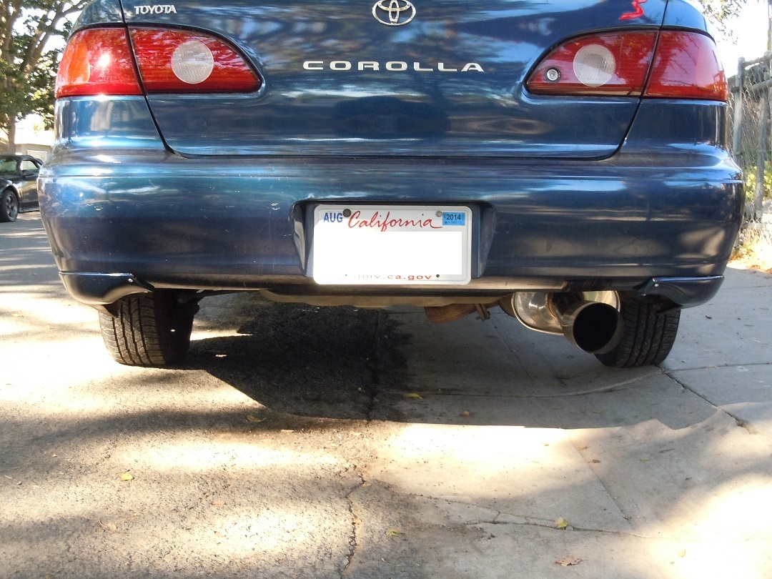

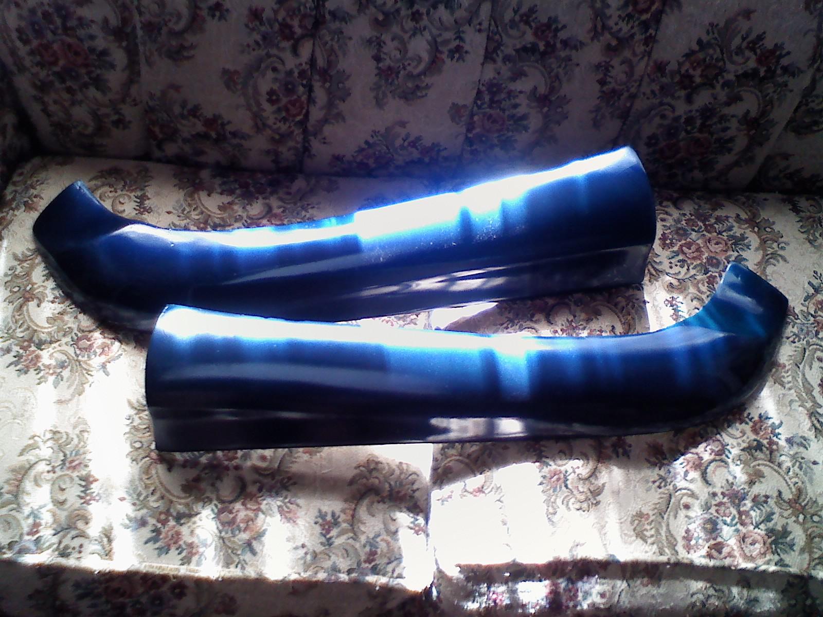

    So this has been a question everyone has been asking because apparently mine are a little different, my reps dont provide the groves found inside the valences so that kinda leaves one wondering on how to install them...well i decided to make a DIY

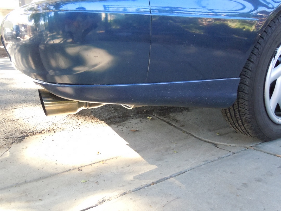

    now attach it to the car and screw it in, you can now remove the 3m tape and line it up with the rear bumper curves. very hard to miss...
    apply pressure towards the body with your hand and use the drill to screw it on.
    installed
    the 3m tape does alot of work if installed right

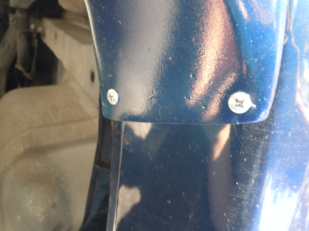

    now you want to install the second screw on the inside of the wheel well and you need to pull on the bottom of the valance away of the car to flare it out like the original ones do, and then use another screw so it wont move
    this is optional but not needed,
    if the inside part of the valence separate a little you can add another screw to hold it in for a total of 4 screws used.

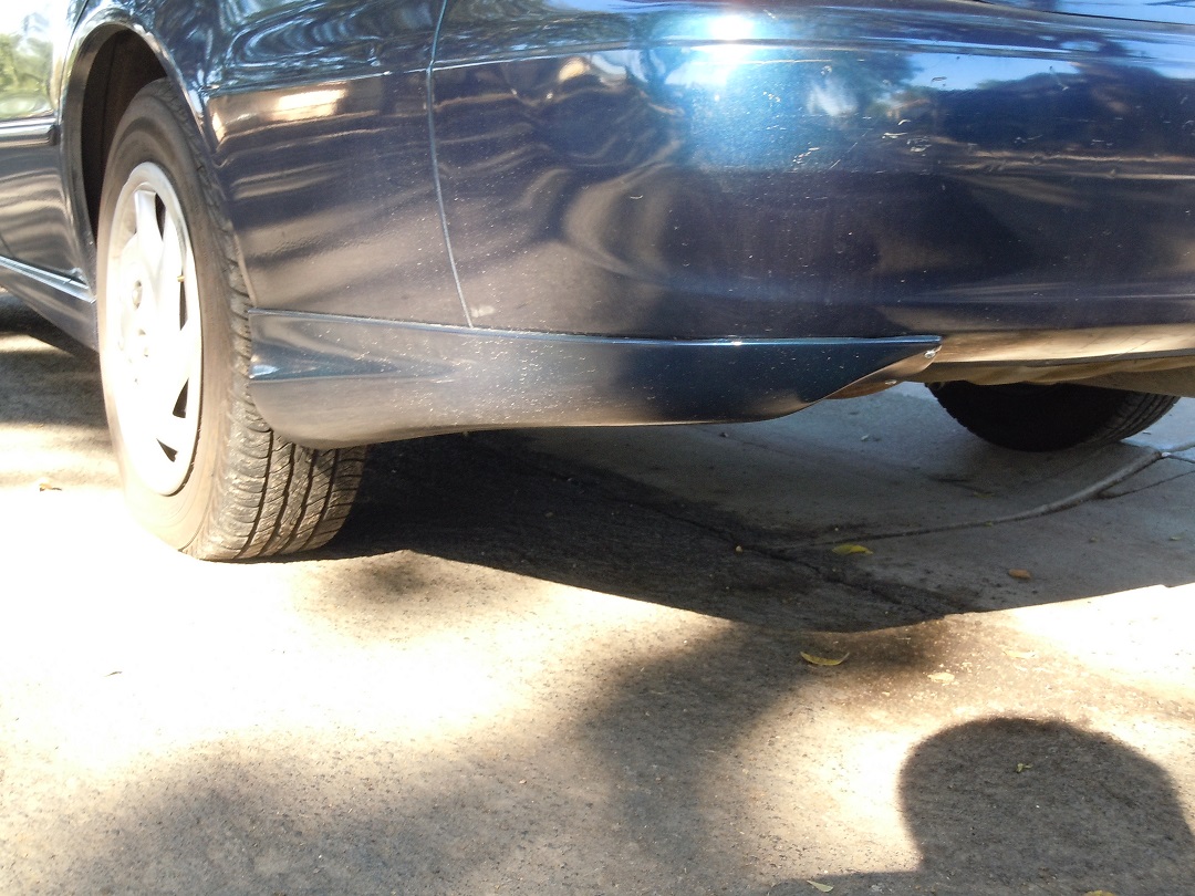

    AND ENJOY!
    don't forget the other side...
