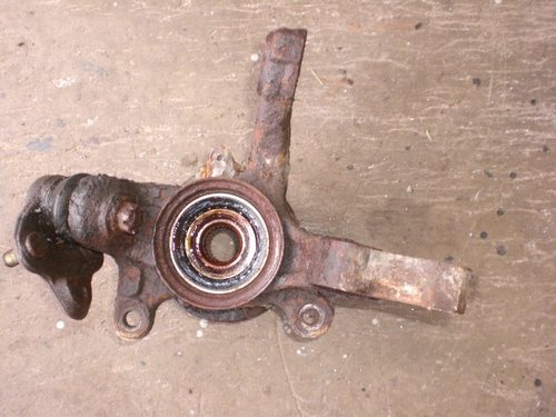

    5 lug is by far the biggest headache ever....
    the 9th corolla, 1st matrix, and 7th celica all have the same front spindle knuckle, no way its going to work with the 8th gen corolla without heavy modifications done to them.

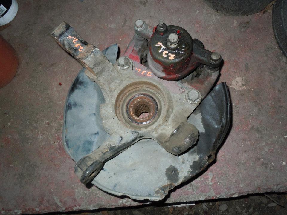

    went to the junk yard today and made another discovery....
    94-99 celica gt front spindle knuckle has the same position for the tie rod as our corolla....here is the 6thg en celica....
    and check out our 8th gen
    HOPEFULLY the axle is the same, going to go try it out 2mrw morning....
    here is the 7th gen celica, and look how low that tie rod mount sits....
