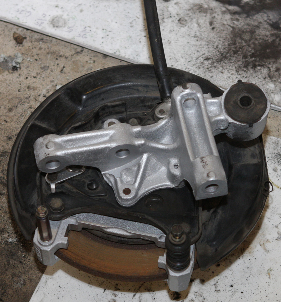

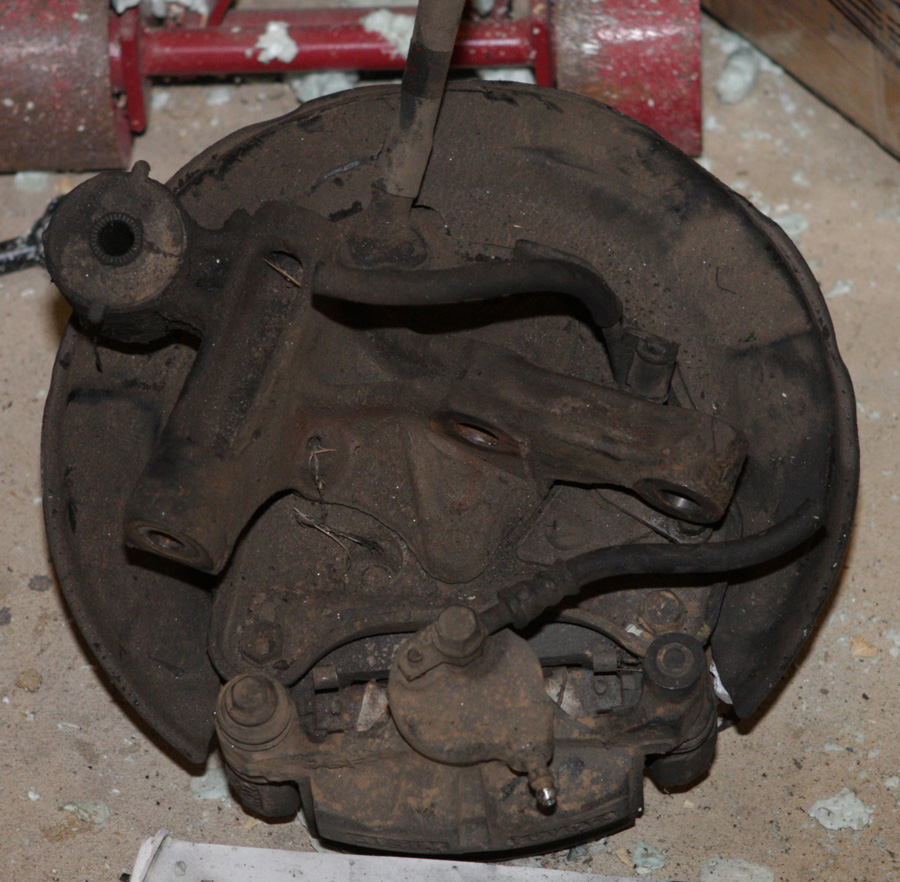

    OK peeeps...i made some more research and found out some nice information....apparently the 1986-1990 camry had rear disc AND it has the same length as our cars for the stabalizer arms and strut. I found these pictures...
    now obviously i would want the Celica ST202 rear disc better so the only thing you would need is the knuckle part from the camry BUT id also have to check and see if the hub bearing from the ST202 bolts on to the Camry knuckle because i need 5x100. 2mrw i will go early morning to stockton pick-n-pull to confirm this...

    I also want to add not all camry came with the rear disc v6, this was actually rare, so thats why we turn to the lexus es250 1989-1991 which came with rear disc and the v6 camry engine....

    by the looks of it the camry 2nd gen/ lexus es250 is going to be the one....but as i said, im going to be using the st202 rear disc because they are bigger and thicker and need 5x100. sensing a dirty joke ahead....
