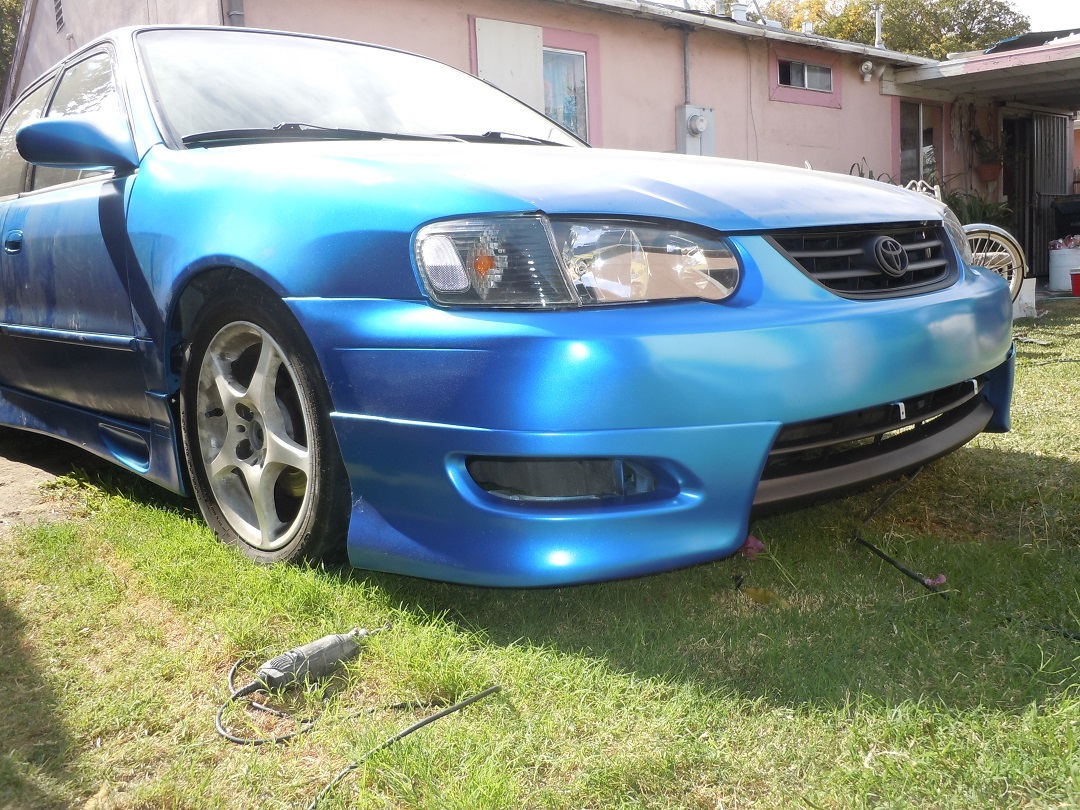

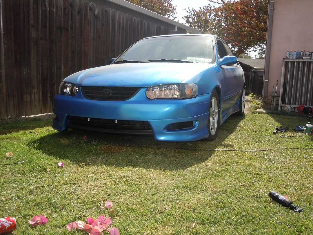

    u should convert the entire 9th gen lip kit to the 8th gen and call it the "widebody corolla" :D
    :kidding: gold.....you said you would buy me some :(
    Sorry, I can't buy you huge gaps under the corner lights.
    James and MacktasticSlick like this.

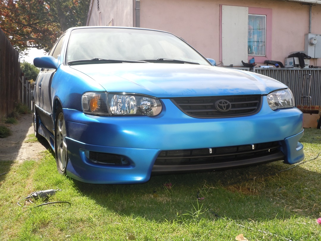

    ohhhhhhhhhhhhhhh lol i though you meant the fog lights....

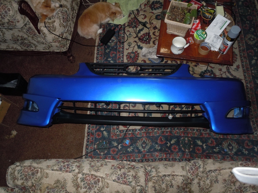

    so those gaps, i need to buy new bumper mounts that go behind the bumper and they sit under the headlights. You got 1 on each side and that holds the bumper up.
    I removed mines because the fiberglass bumper did not need them and they were only on the way so i removed them. Me being stupid i did not think i was going to need them in the future so i tossed them out.
    You also have a ball mount that is under the corner light on the fender, you need a plastic mount that also goes on the bumper which slides in to that ball on the fender to keep it up...
    At least the valences have all the proper clips to secure them to the bumper:laugh:
    OH yeah, I remember you talking about those corner bumper clips, now I see what they do!

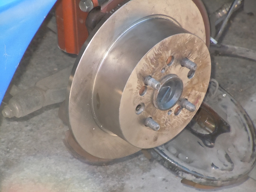

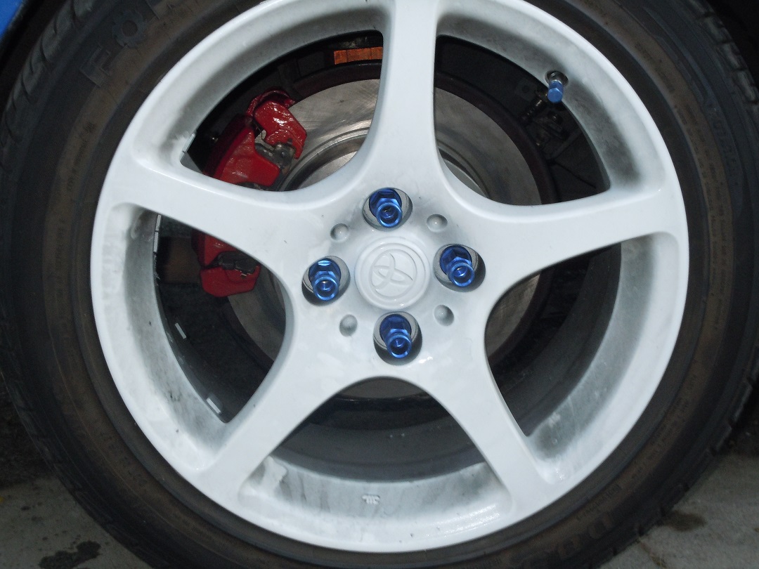

    Celica 94-99 rear disc swap
    That's cute. Nice tiny painted calipers.
    you don't even have any!:dafuq:
    I know I don't have any tiny painted calipers. We talked about this. I have very large calipers, which are painted. You yourself talked about how silly and rice it is to paint such parts. Now I know, I know, the rear discs you have on there are an upgrade from stock but they are still tiny.
    I don't need them any bigger on a corolla, i just wanted the detail of rear disc brakes.
    I never said that, why you think my drums were painted red at first in my primer body kit days? Its funny because i remember telling all you guys i was going to paint my calipers red and all you guys bashed on me for that.
    I rather have these tiny caliper rear disc brakes with drum while you keep your non caliper rear disc brakes....its not like you have any other choices, these are actually bigger than the ae111 and ae92, pretty much the only choices so not much i can do other than laugh at your non rear disc brakes...

    Cute brakes cbass

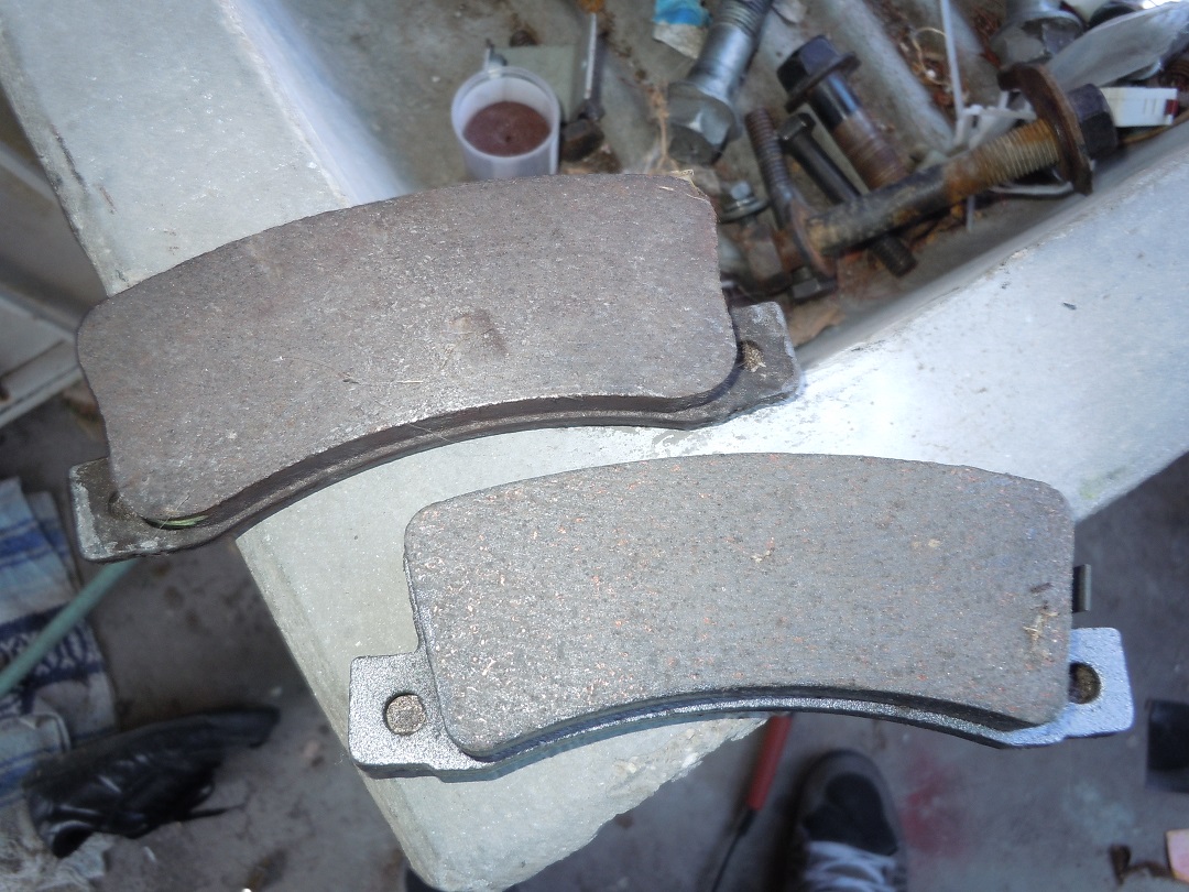

    wow....that's funny....brake pads and calipers are about the same size on the ae92 and celica.
    and if I'm correct the ae111 is identical as the ae92 since the pads are interchangeable....
    Basically the only difference in all of them is the celica has the drum brake hardware inside the rotor...Not really any advantages...ill just leave these here for reference i guess....
    936
    305
    Yup you're right that how i change my rear pads but i use EBC.
    it's what I did lol

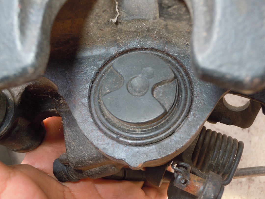

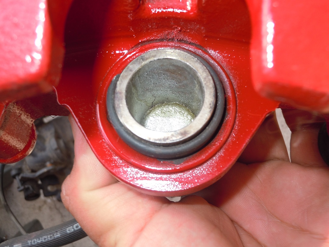

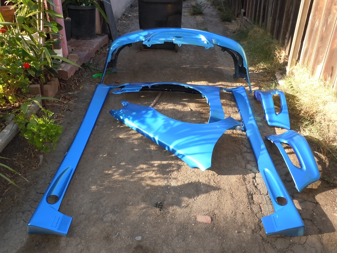

    painted all my parts...everything came out good:happy:
    looks good man
    thanks :thumbsup: here is everything installed
    TOYROLLA99 and Gold like this.
    OK that looks a LOT better now that it's painted!
    Well it looks better than I thought it would, for sure.
