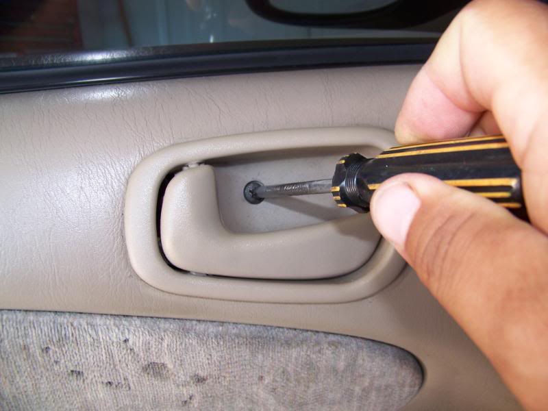

    First you remove the door handle with a phillips screw driver . ( Warning : When you are putting the door handle back DO NOT OVER TIGHTEN THE SCREW make it snug so that the inside of the handle doesn't crack )

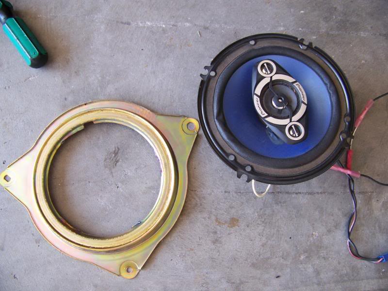

    With a chisel you can remove the plastic rivet that is holding your OEM speaker frame to the door . Once you break the rivits you unplug the speaker and then remove the whole spreaker and frame .
    With a dremel you cut off the frame of the speaker that holds the magnic , because this frame can be re-used for your new speakers .
    Once you remove the old speaker then with your new speaker you first wire up using the same connector as your OEM speaker , Then once you do that then you align your aftermarket speaker to the frame and mark off where you will be placing new holes . After you drill your holes then you tightly screw the aftermarket speaker to the frame . ( In this case I used Pioneer 3 way speaker 6 1/2 . )
    Then once you are done you wire up the speaker so that when you put the frame with your new aftermarket speaker you can hide the wires correctly so that they don't get caught on the window track . Then with new rivets you realign the frame holes and rivit your frame to the door .

    Yes you dont want the speaker to stick in the door all the way I think it will hit the window regulator . I just re-used the frame from the old one or you can cut a hole in the door panel and stick the speaker there , Everyone has there own taste . This is just a heads up for those who want to upgrade or replace :)

    or just get some mdf and some screws and cut out the same shape, which is what i did i used 3/4" becuase the pionners i bought had a very large magnet and was like 2+ inchs depth so i had to push them out. i also put some of that sound deadaing stuff around the edge to make a good seal.

    The plastic on the door doesnt go down that far so your ok . All his is the same thing as the frame I used but his is made out of wood . you cant go to thick cause the door panel has a lip to seal the speaker face to the hole on the door . plus you go thicker wood your will push the panel away from the door clips . but his idea will work , my idea was simple easy and fast one day about 1 hour to do both doors . :)
