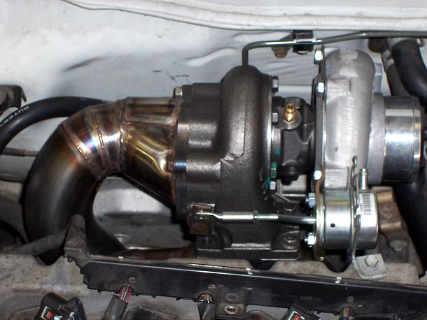

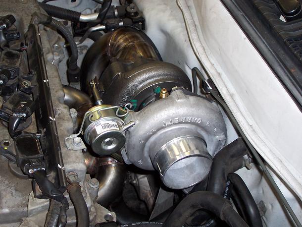

    That is one crazy exhaust manifold. hehe Isn't that turbo a bit big for a little corolla? ;)

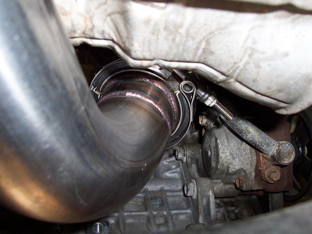

    JspeXAE102 Well-Known Member
    4,851
    群馬 日本
    those are some nice welds
    It's really unique... The downpipe curves off from the side. And its a huge diameter. What size is it exactly? I can see the exhaust is a wide diameter too.
    I know this is a long shot but do you think you would be able to sell this as a kit able to ship out if it meets demand?

    Very nice. I wish I had used a v-band clamp for my downpipe. I can't get the stupid thing out unless I drop the cross member cause the flange gets in the way. Looking forward to seeing what you put out with this setup. What size turbo is that anyway? Looks about the same size as mine.

    Thanks for the great comments everyone. That turbo is a GT2860RS, and if my calculations are correct, it should be just perfect for the engine and horsepower goals in mind.
    The awesome welding are courtesy of the new guy that we've hired here at the shop, "Angry" Mike, who's a very good tig welder. He designed the manifold (a cross between a log and a tubular design, similar to a log but with much better flow and extremely compact) along with the downpipe.
    The diameter of the downpipe along with the complete exhaust is 2.5".
    I would like to market this kit, but we will not have the chance to blueprint this one, and demand is a big concern. If anyone wants this same setup though, or any custom turbo setup, ship it on down and we'll take care of it. This customer sent his car down from NJ.
    I'm going to leave the speed limiter in place as far as I know. It isn't about how fast you can go, it's about how fast you can get there. :)
    -Doc

    does anyone make a v band for an internally gated .48 t3? the three bolt flange is effing impossible to get to with the sharp angle my downpipe is at.
    Dr Tweak Mad Scientist
    1,237
    Savannah, GA
    Yeah I know what you mean. I've never seen them offered, but if you can pull the downpipe off and cut it where you want the v-band installed, we can weld it up for you no problem.
