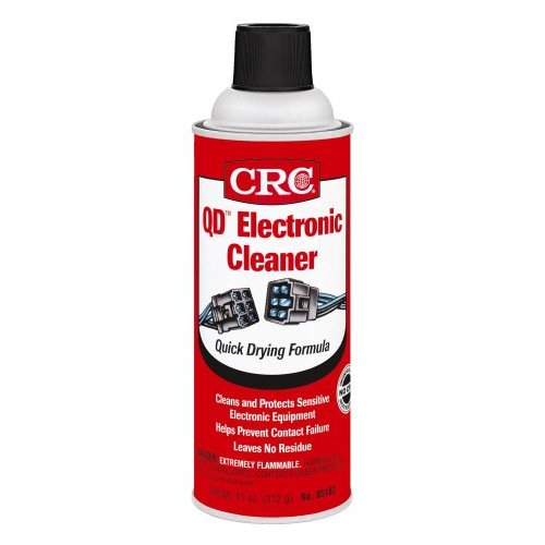

    Sounds like a P0420 or something similar. Do you have an aftermarket intake at all? It sounds like your MAF sensor needs to be cleaned and computer reset. Autozone should sell this stuff. CRC QD electronic parts cleaner. I hit my MAF sensor with this, let it dry and it usually fixes the problem.
    PSON New Member
    The code was PO171. Yup I cleaned the MAF and I used the very same stuff, electonic cleaner. Now I will just disconnect the batery for about 1/2 hour and see what happens. I do not have any mods on the car, air intake etc.

    Well on my corolla 01 i would always get that same code p0171 system too lean on bank 1...i tried that cleaner stuff, then i sprayed some of that inside my throttle body and cleaned it with a toothbrush (came out very dirty) replaced the original air filter to a K&N drop in and i would still get it after around 300 miles or so, then i changed my donut ring and my exhaust manifold gasket and it cleared the problem, have not got the light back on and its been 1k miles

    It seems to have worked for now. I cleaned the MAF and then removed battery cable for about 10 minutes. Rode around this afternoon, no engine light. cBass, what is a donut ring? In case I need to change mine.
