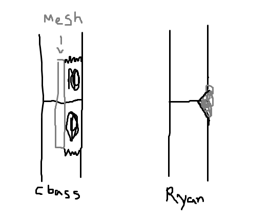

    ohhh boy, ryan you just missed a very important step....you didnt use the reinforcement mesh that is provided with the kit....That bumper is not going to hold for long, with the vibration and the bumps of the road its going to break apart...
    The kit comes with it, it gives you instructions on how to do it...
    Added: Jun 13, 2013 at 9:30 PM
    This is basically what you did, that reinforcement mesh is suppose to be melted in between the bumpers to have a good bond...

    yea i talked to other people and they said it's not really necessary, besides, im making sure to get the melted plastic deep in and on alot of the areas it actually goes through to the other side

    :dafuq: Once you melt the plastic you thin out the material, which is why the MESH is included in that kit, AND PLUS you have the Aftermarket OE bumpers, that plastic is very weak, look at macks rear bumper!! shit melted way sooner than his OEM bumper, I actually used OEM bumpers in my hybrid......BUT HEY dont listen to me
    idk, the weld job im doing seems pretty solid, im even using the same plastic the bumpers are made of to fuse the 2 halves togther
    Yeah cBass let him do shit his own way, it it falls apart he knows for next time.
    i tried... -_- apparently a guy with 2 years of auto collision repair class is not right
    srry, ur making me feel bad :/ but its too late, and idk if only u could see it, it seems solid, i went strait through with the melting unlike the diagram u made, im taking my time

    Dude im just telling you because the bumper will scrape to wherever you go. My dads drives the corolla on normal conditions "11 year old OEM SUV suspension" and in half a year the bottom of the bumper has hella scrapes, and the front valances? those are also messed up too...THEN your gonna add weight to your bumper by installing the g-tec lip and fog lights, that shit will break...I understand that you melted almost completely all the way through but think about why the kit has that reinforcement mesh... I'm giving you a hard time because i know whats going to happen, don't cut corners.
    well is it to late to add the mesh if i decide to do it after im done welding?
    Nope, it's not too late! Do it.
    Im really confident about my craftsmanship on this one. i triend bending the bumper and if feels like the regular unfused parts will give before the fused seem, but i may decide to reinforce it when i get closer to finishing it
