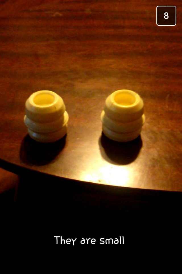

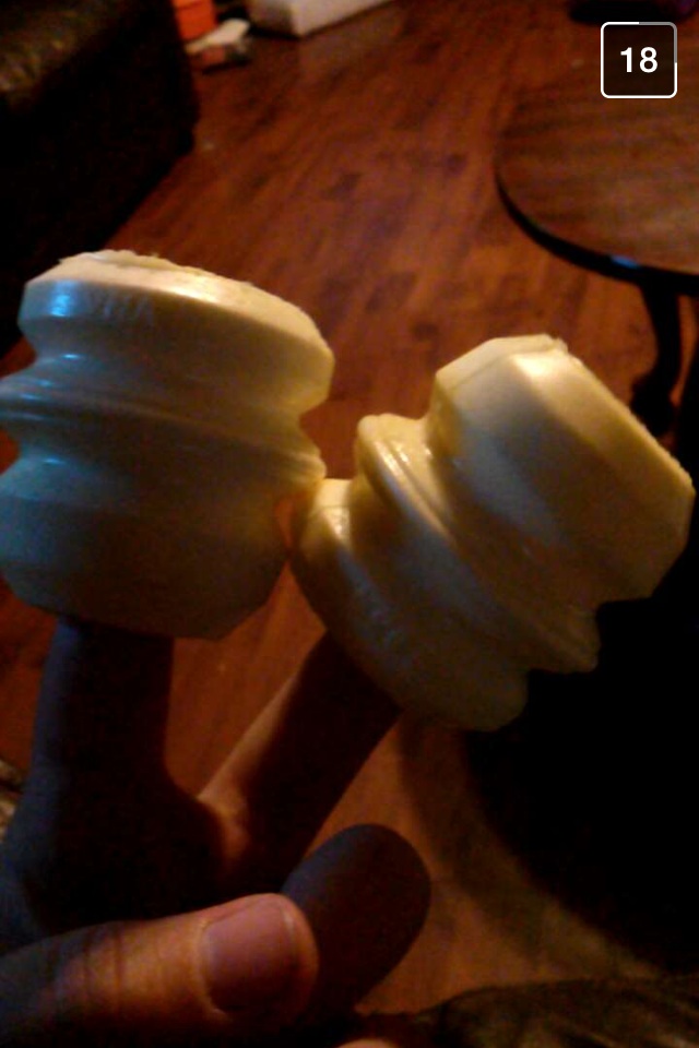

    No I just found these on ebay in case anybody needed some cheap ones I don't believe it'd be necessary to cut any off as your car won't be resting on them they just keep the piston from bottoming out. Check out my thread and you will see the GC bumpstops I bought they are pretty thick and work great didn't cut any off.

    Are those bumpstops squishy or like a hard plastic. I'm not grinding on mine, they already had a mold to fit in the holes and curvature of the perch, from when they were installed previously. They fit fine.
    jdmgen8 Well-Known Member
    554
    51
    Spartanburg, SC
    2002 Toyota Corolla CE
    They are a hard foam so they may compress some I haven't checked em GC recommended them specifically for the koni oranges.
