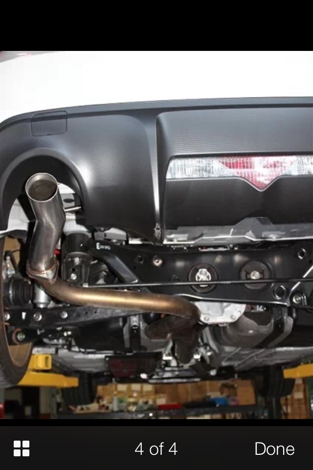

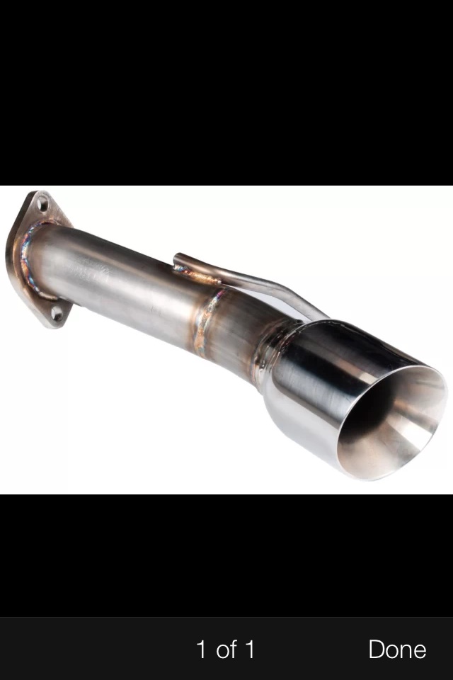

    jdmgen8 Well-Known Member
    554
    51
    Spartanburg, SC
    2002 Toyota Corolla CE
    MattH Country Boy Problems
    217
    Central VA
    2001 Corolla s
    Probably won't work. The pipe that bolts to the muffler turns towards the right rear wheel right where the muffler bolts up and there is about a foot of clearance. You would definately need a 90 degree elbow. The pipe you posted would be headed straight for the wheel.
    554
    51
    Spartanburg, SC
    I mean if they are short enough they should work but no way to tell.
