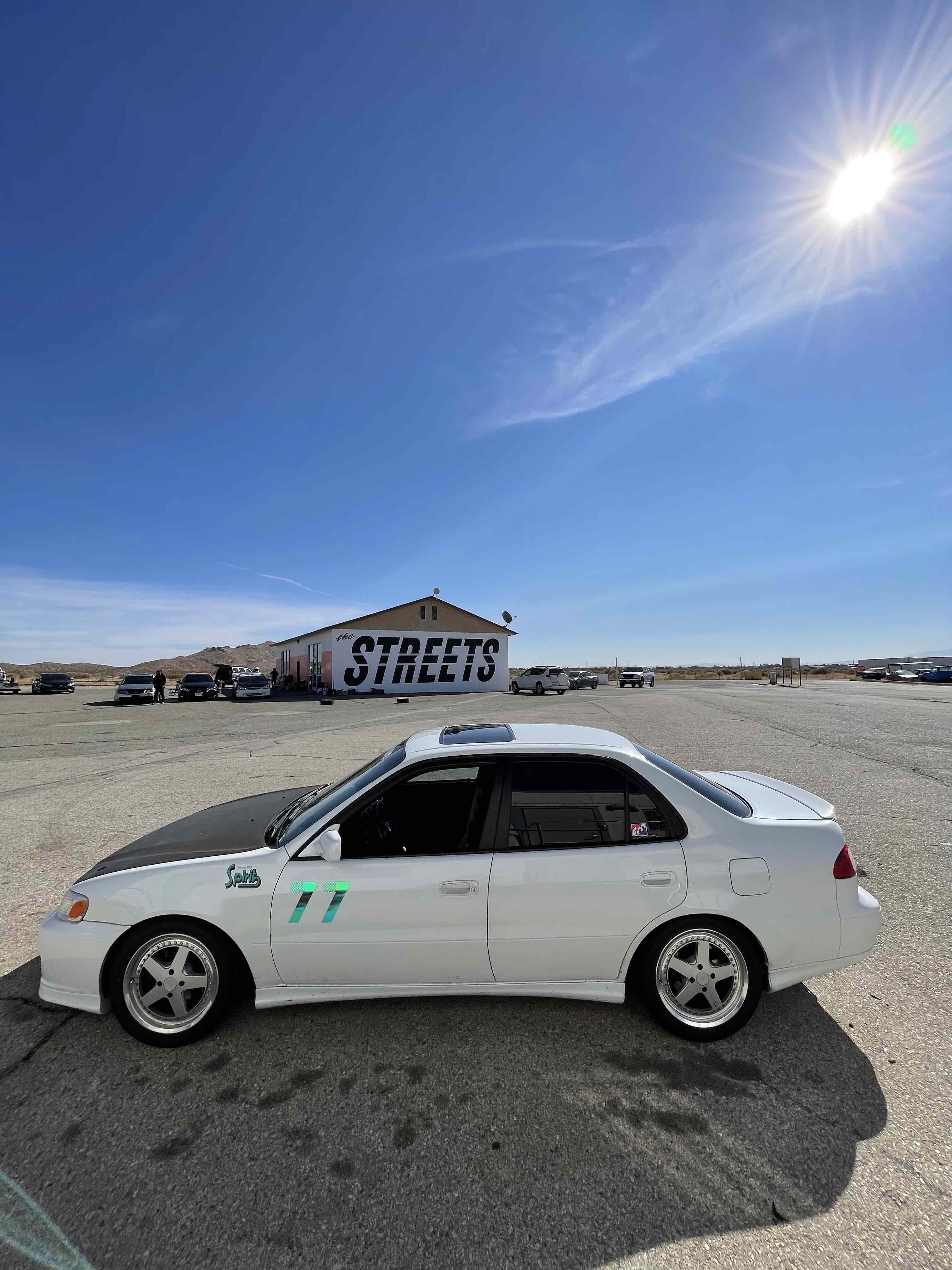

    Spent a good amount of time dialing the alignment. Finally getting a nice linear rotation control i've been wanting with left foot braking.
    Less time tinkering with the mods for a little, just enjoying the car as is. lol

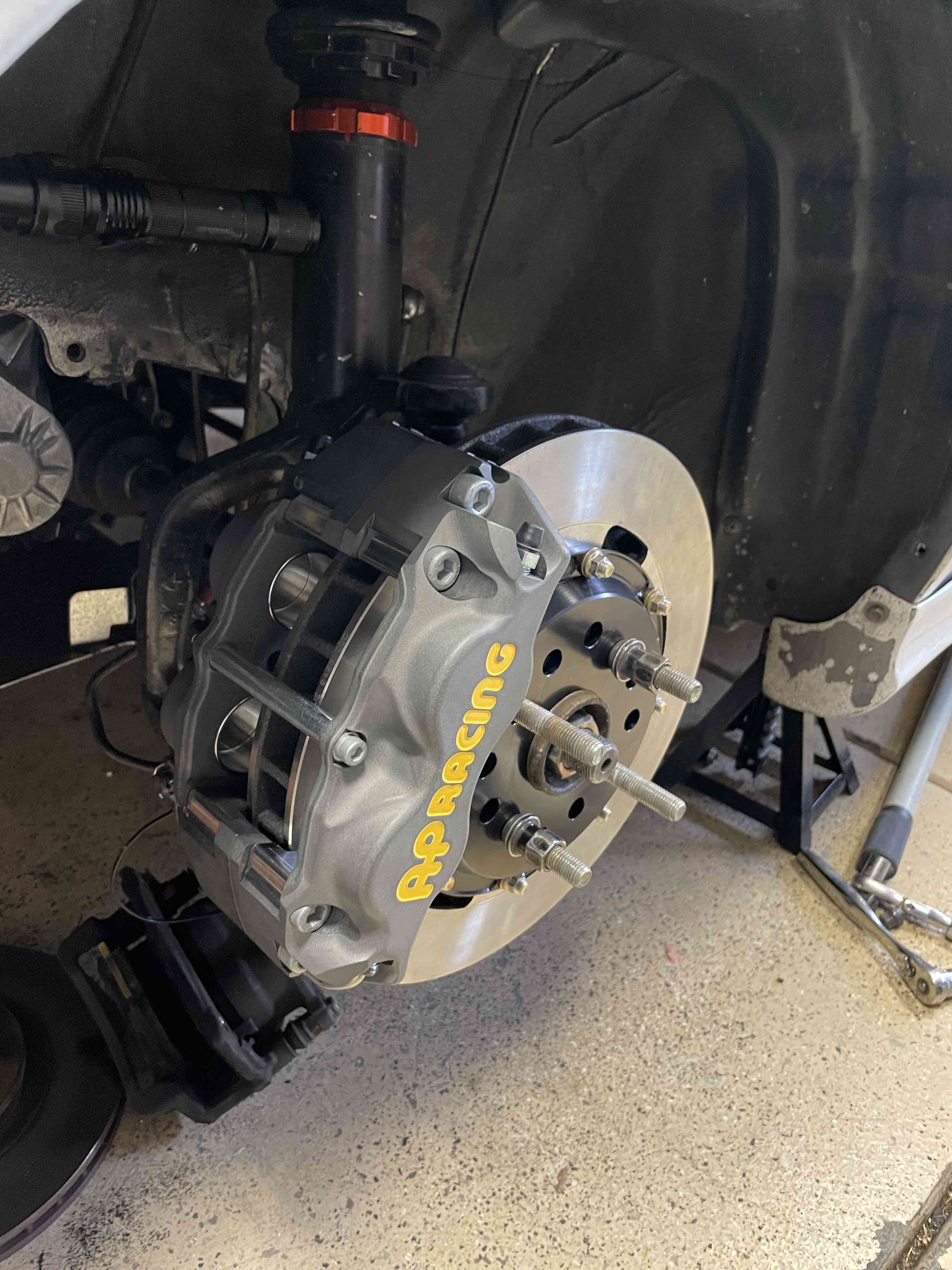

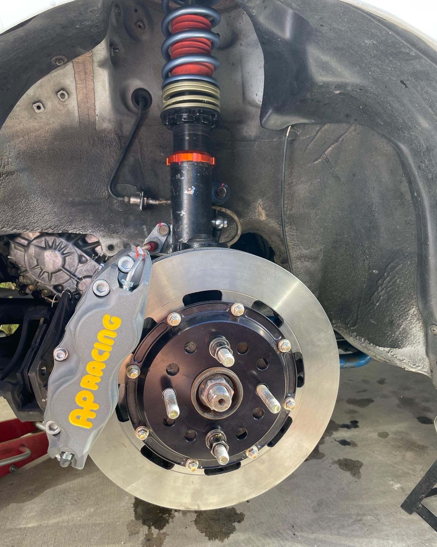

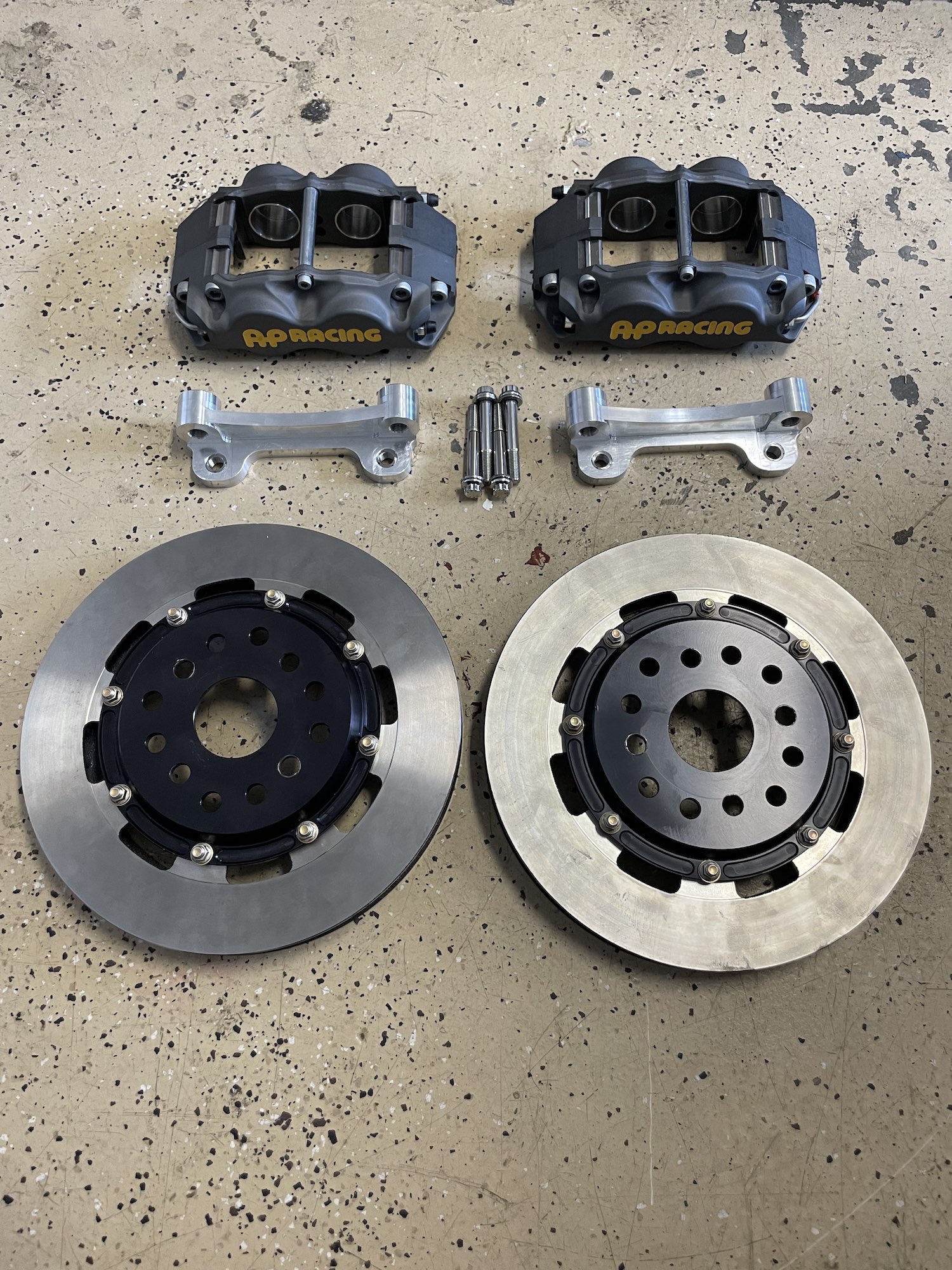

    Previously i was sporting a BBK from Fastbrakes which was good for the moment. Some reason i wanted more so i decided to step up to big leagues with a AP racing caliper and thicker rotor from a .81" to a 1.25".
    Everything is metric on this caliper, so i can forget a tool and not really stress. which was an added bonus, Plus this new kit i have designed to utilize all OEM Toyota standard bolts for ease of repair.

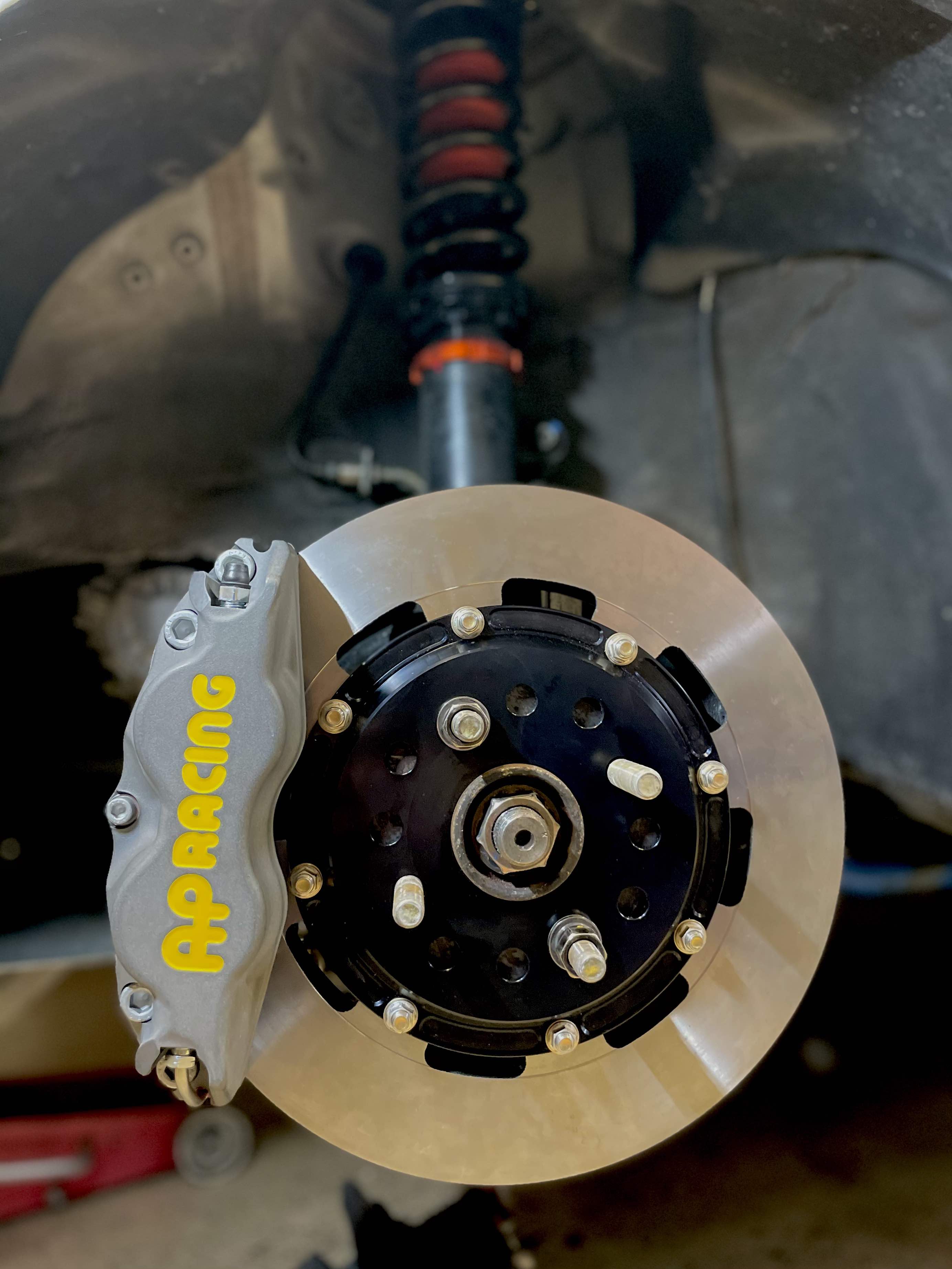

    So lately it's slowly chipping away at projects i need to knock out. my main one is a proper brake upgrade to hold the heat.
    had a friend of mine mill some brackets i designed.
    Fully custom AP racing BBK
    11.75"x1.25 Rotors for my Superstrut setup.
    [IMG][IMG][IMG]

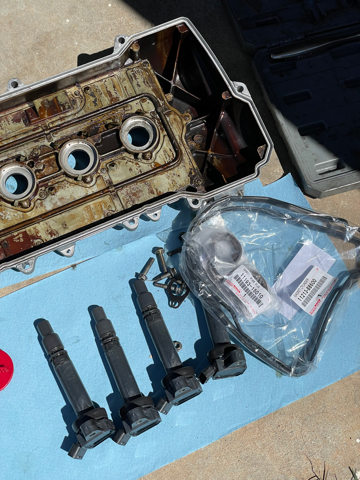

    But this motor has been a PITA with leaks, So i finally said time to fix it. Replacing the rear main seal, valve cover gasket, Spark gaskets, and finally reseal oil pan.
    (its a high milage motor i got from a rolled over XRS so forgive the gunk)

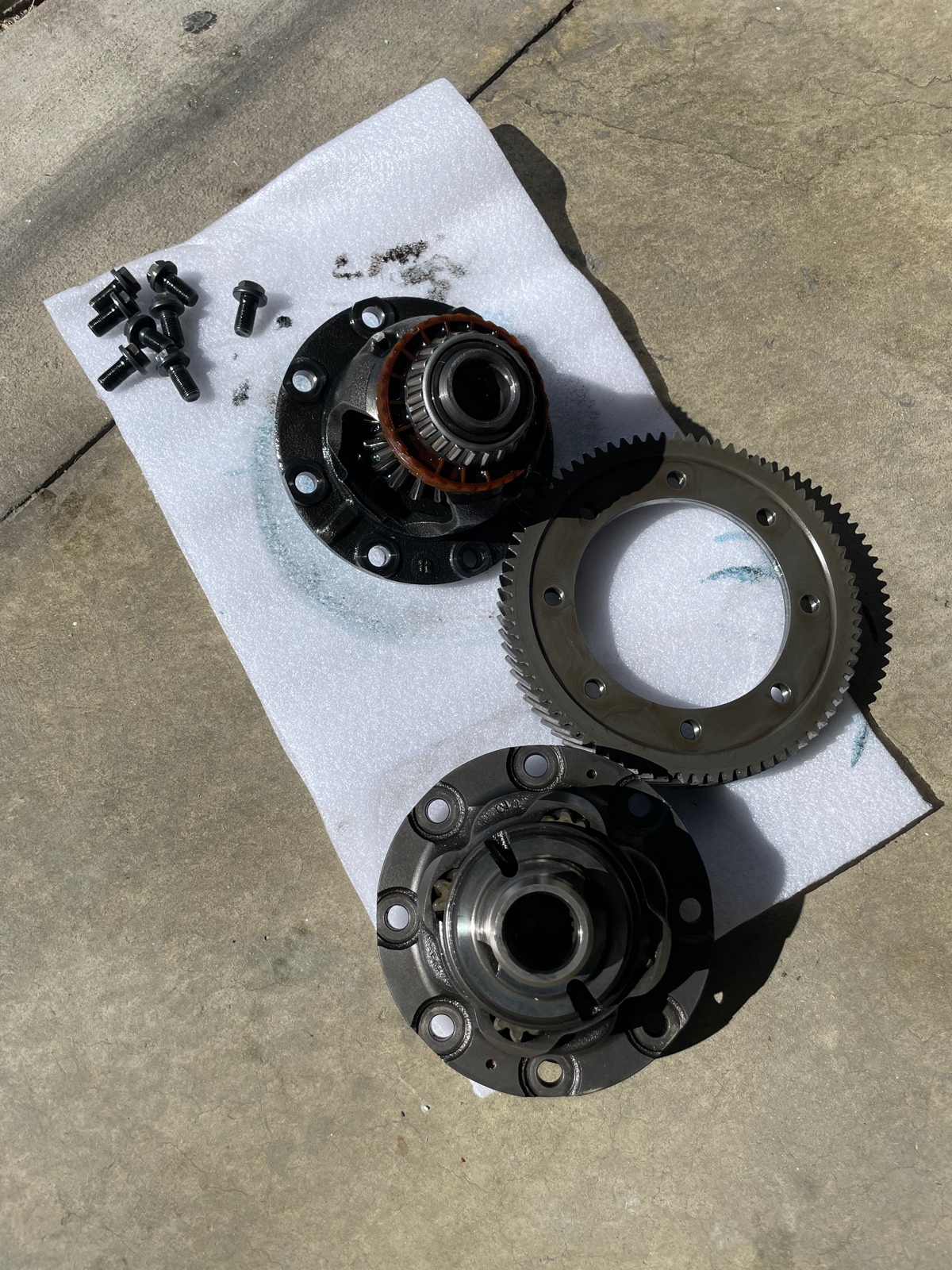

    Many of you know the rear main isn't just a "Quick fix". Soo i said its time... going with a light tune theme for the moment, and installed my helical LSD while i was in there so thats more small parts, Fresh bearings, and axle seals.
    All my complaints about how the car needed a Diff are gone and its well worth it. Really bummed we didn't get a spec like this in the states

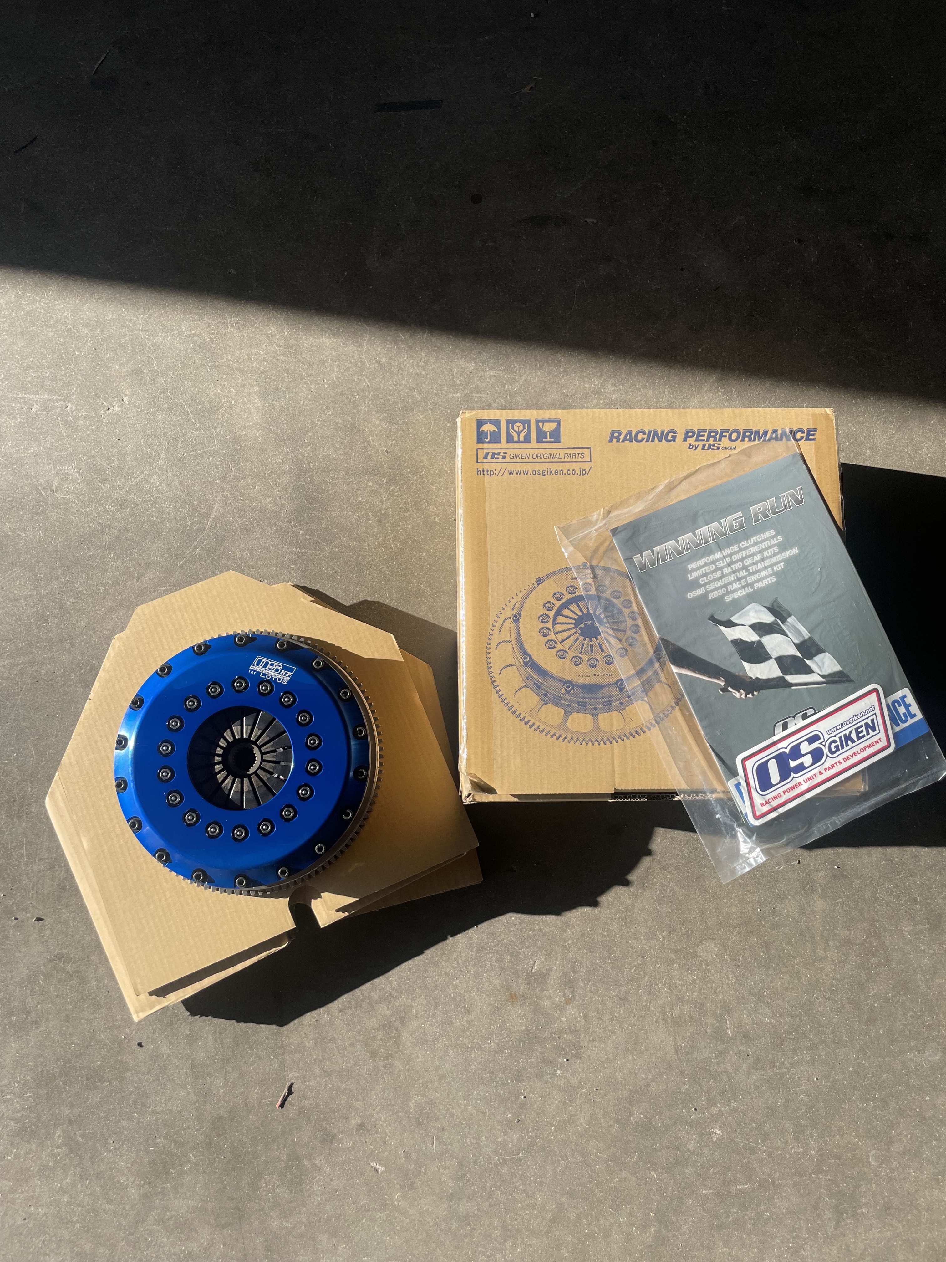

    So no real update's. A lot of parts stacking for the motor build.
    Recent addition is a OS Giken STR clutch is a single disc sprung clutch, that is more suited for race and daily use without a heavy pedal andddd can hold the torque.
    The pressure plates on the ACT HDSS clutches for some reason failed in the diaphragm after about a year of use maybe 6 track days and some daily driving on a stock 2ZZ.
    [IMG][IMG]

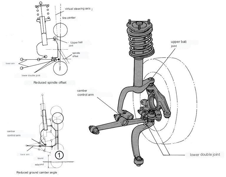

    -Superstrut really took away all my complaints in the handling department plus my coilovers from Riaction USA. They have been on for a while but i am finally getting closer to fine tuning the cars balance.

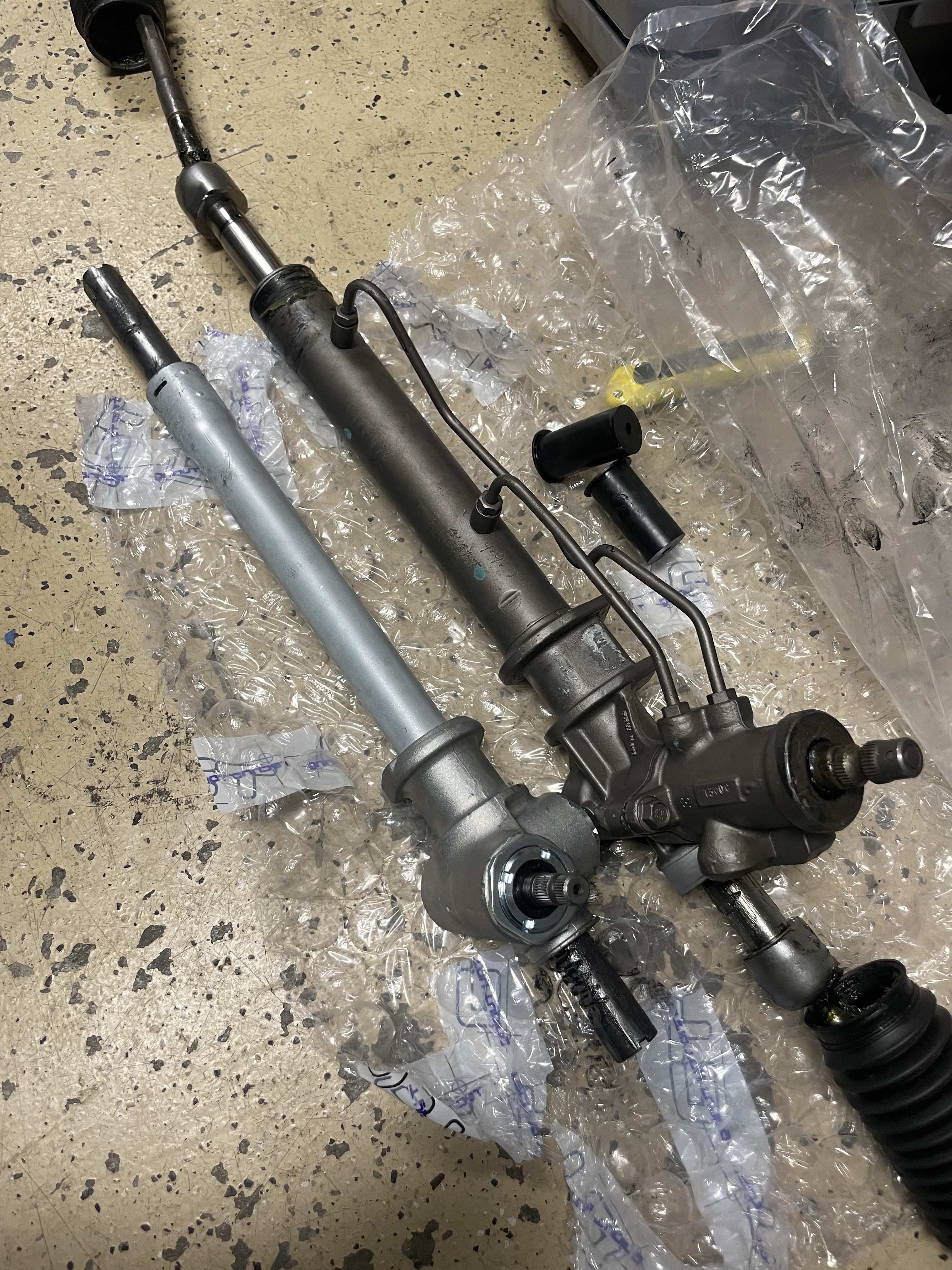

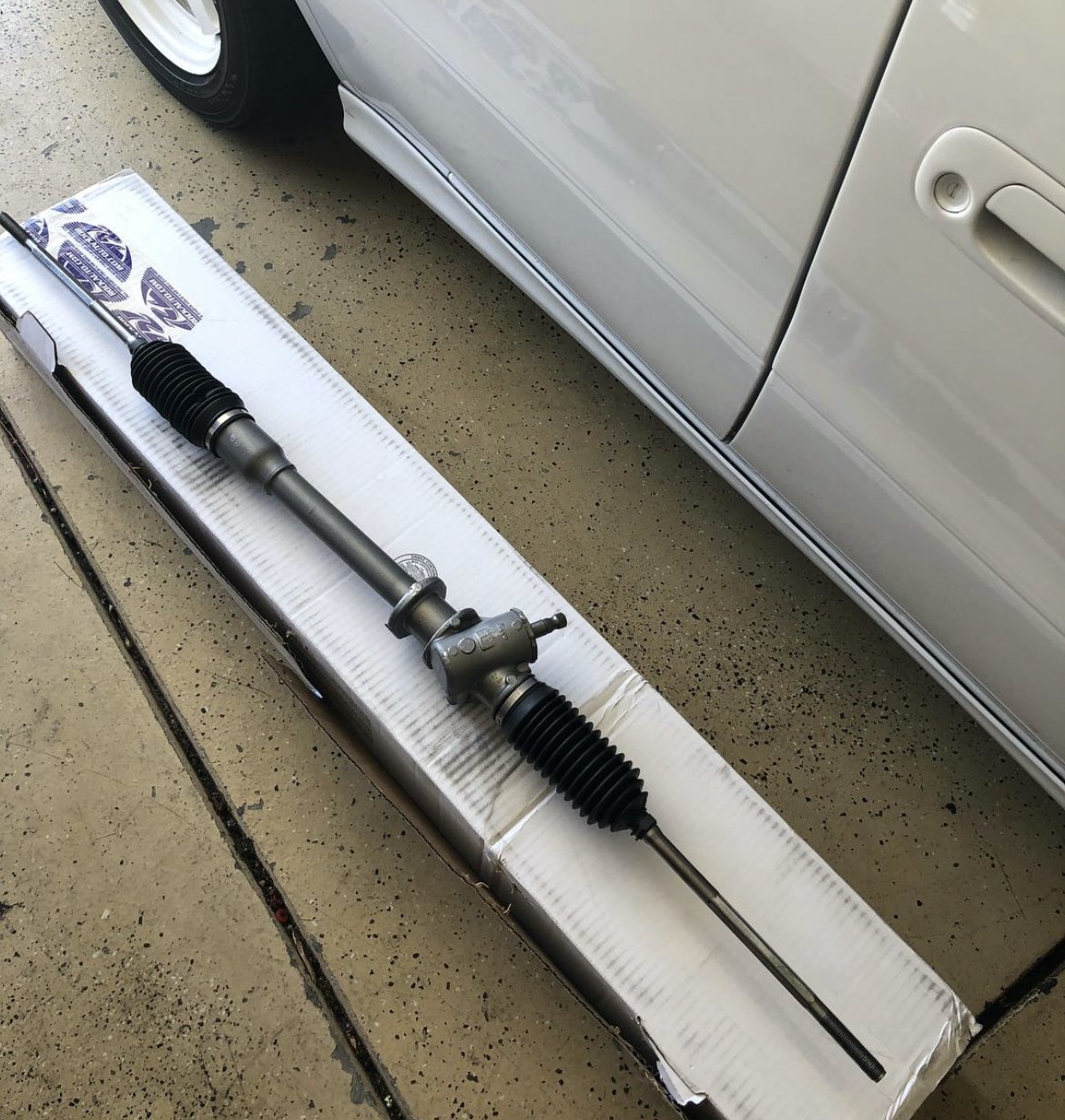

    So I have been running a manual steering rack out of a AE101(7th gen,1997) corolla for a while now with yaris Electric power assisted steering (EPAS). The combo works pretty good daily driving, but on track I noticed I have to input a bit more angle which left me feeling like something was off. I was digging thru the manuals for both corollas, turns out i went a bit backwards by going to a manual rack. Stock 8th gens steering have a ratio of 18:1 3.5, turns lock to lock, while the manual rack out of the 7th has a lovely 22:1, 4 turns lock to lock. Problem found after maybe about 2 years of driving.
    (OE 7th Gen Manaul Rack )
    Off to the Toyota parts bin! Coming out with the manual steering rack for a AE86, even better since that car was heavily supported in racing. There was 2 upgrades available, A FLO's quick rack or Quaife quick steering rack. So I took some measurements and ordered a FLOs rack from T3 and once it arrived it measured up thanks to @crolla .
    (FLO's rack on the bottom, 8th Gen OE P/S Rack) Both racks measure 22" wide which is good since the 7th gen rack is 20's requiring longer inner tie rods
    This was a one step back, 2 steps forwards moment. While i don't have final steering ratio numbers, I do know its now a 2.5 turn lock to lock wheel.
    crolla and Goldy like this.

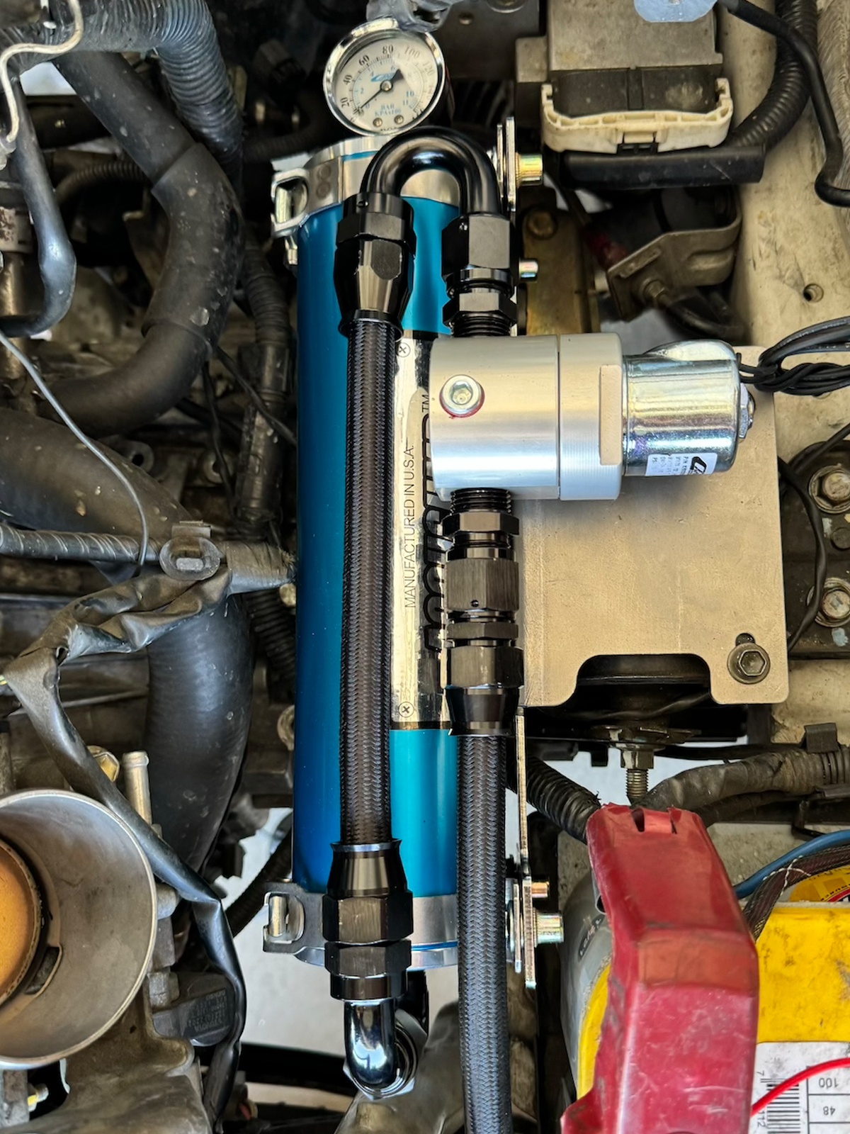

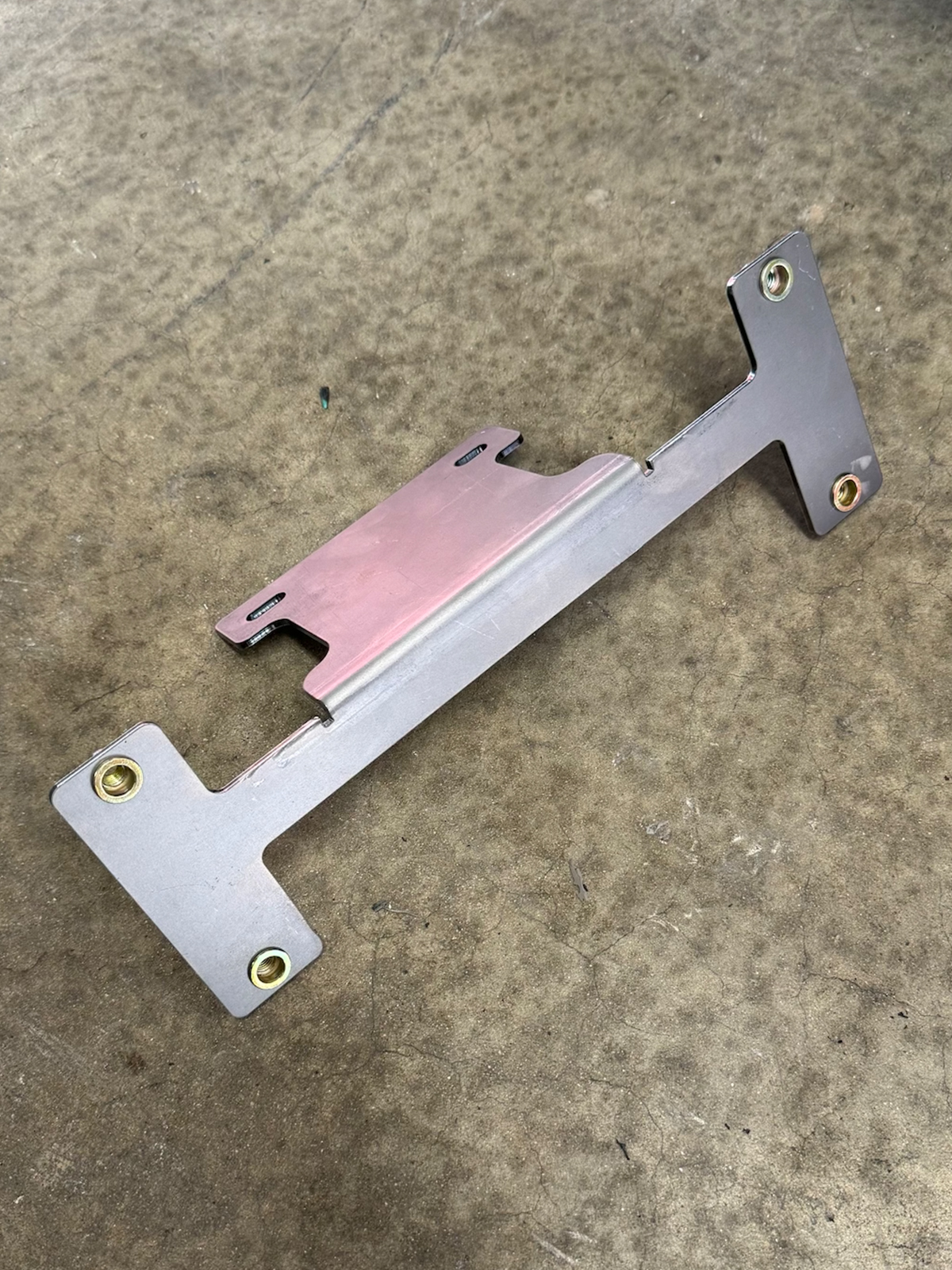

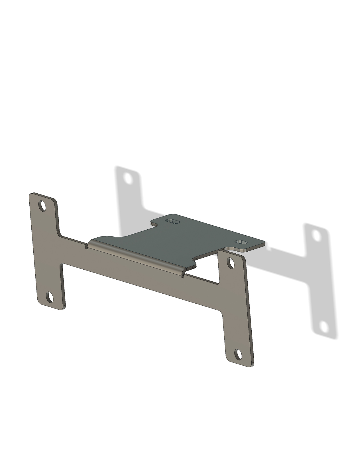

    Little update, I have decided to go the Accusump route. This offered a little neat feature vs the Moroso oil pan, like a Pre-oiled startup.
    Since my CAD skills are growing, I've whip up a special mounting bracket. The clearances are very pleasing for the first attempt. but there are a few little things i want to tweak.
    [IMG][IMG][IMG][IMG][IMG]
    crolla, MattH and Goldy like this.
    How did you run the lines?
