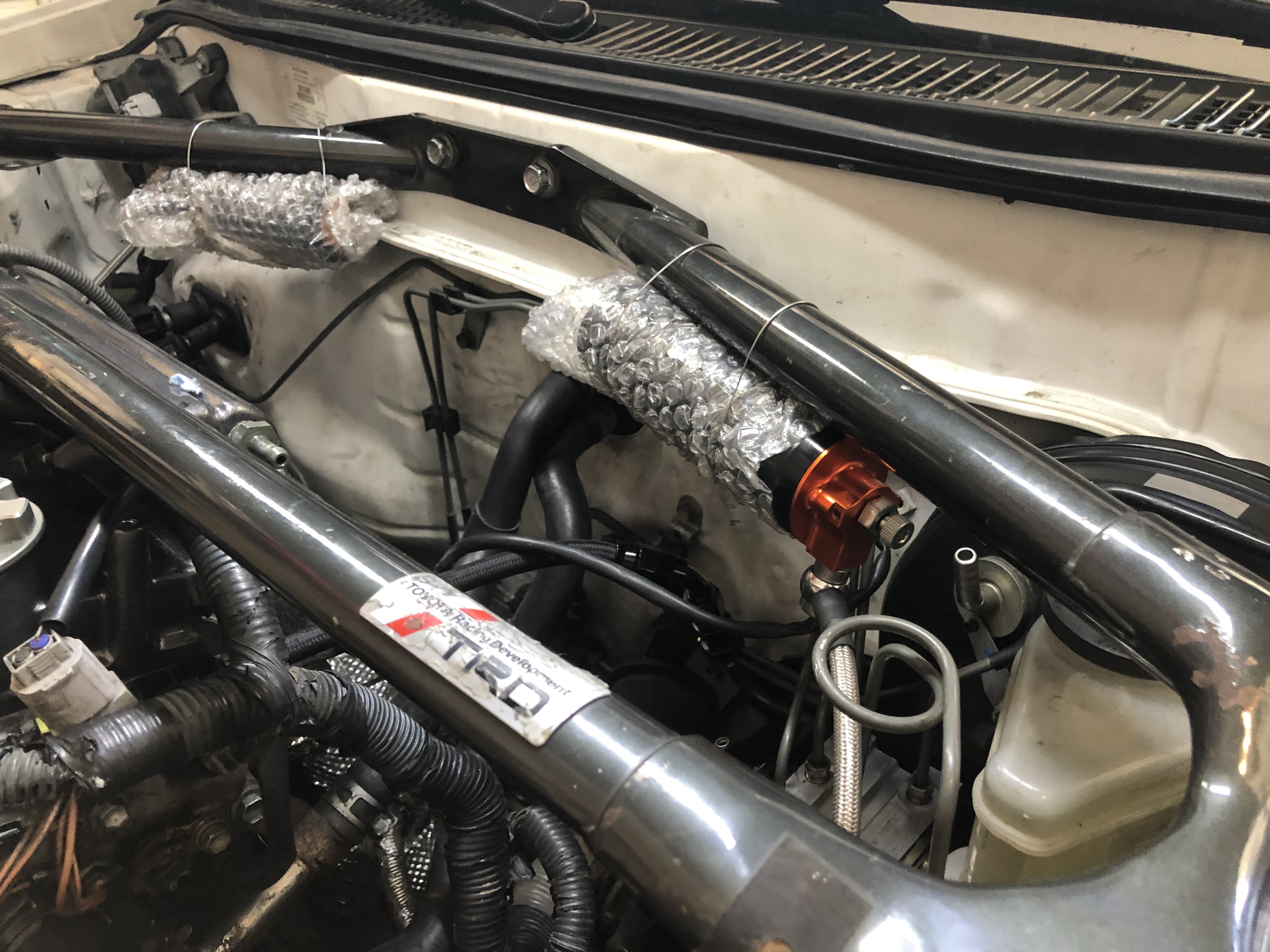

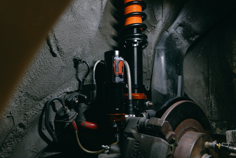

    Well... got some new coilovers from a socal brand called Riaction. I went with a digressive valved 2 way adjustable coil. going to track test them veryy soon.

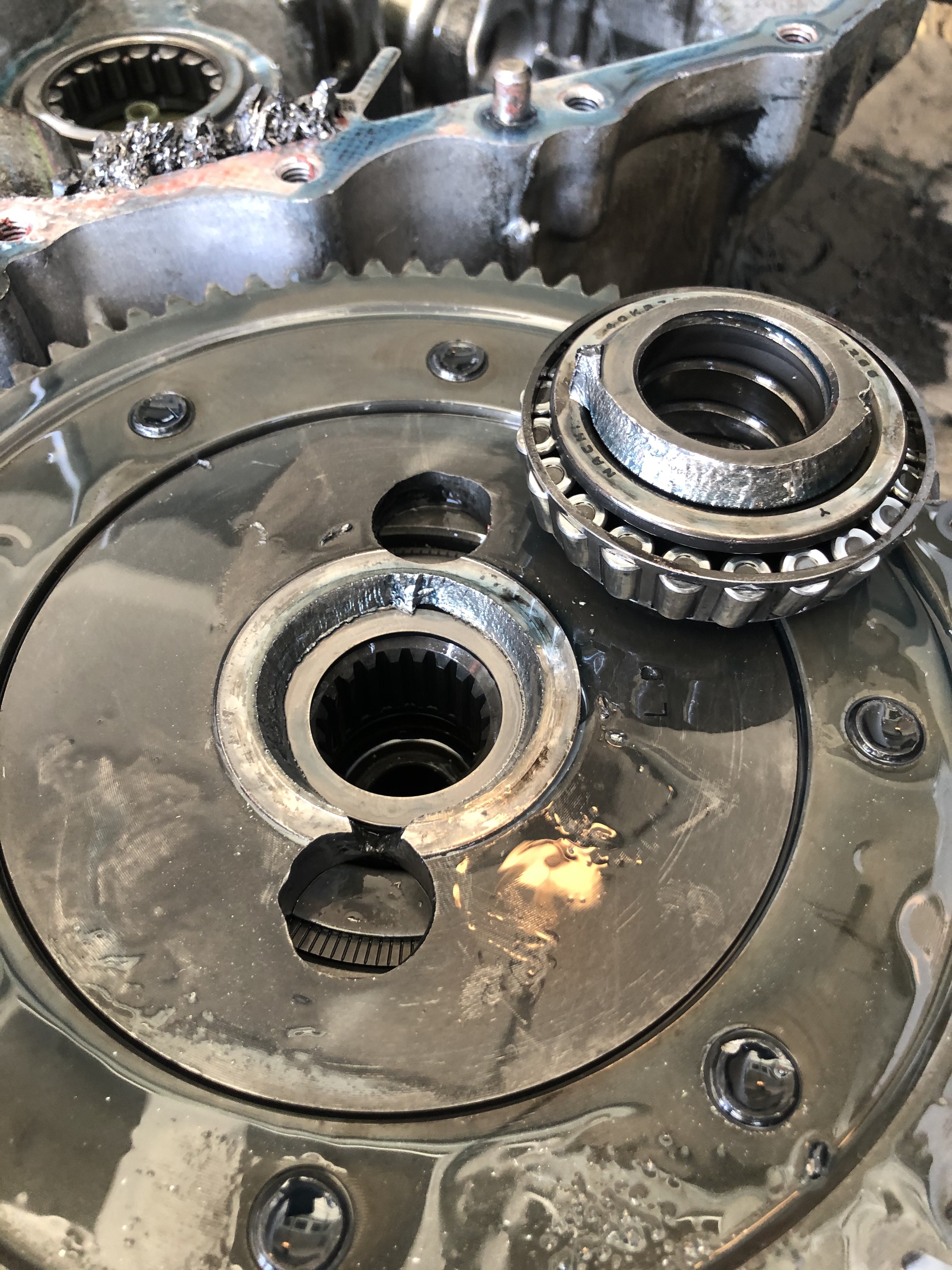

    Car will be getting a little revamp since i recently broke something in the current trans now.
    Also working on fitting abs, since i wanted to see how it felt being it a rare option on the 8th gen.

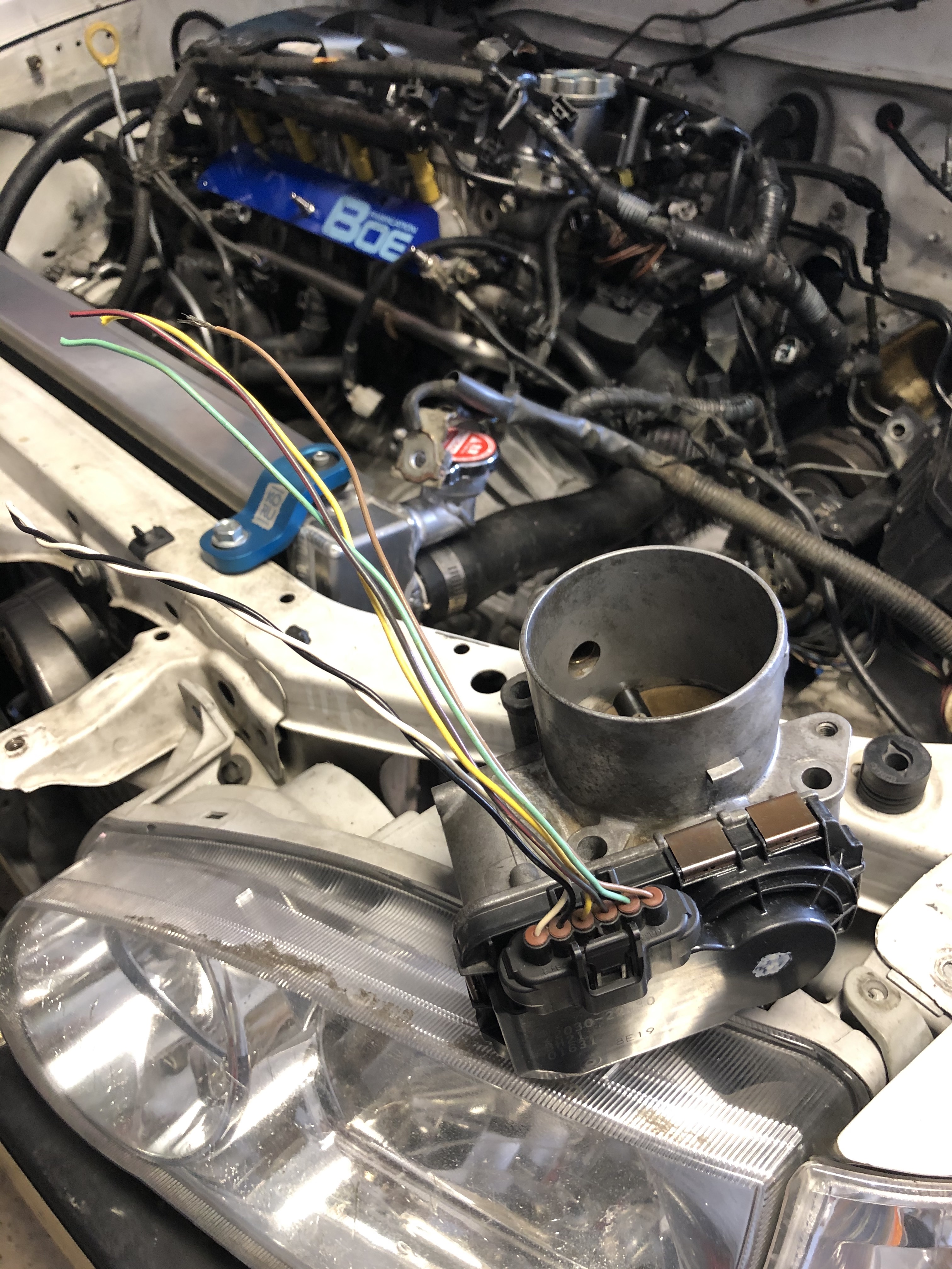

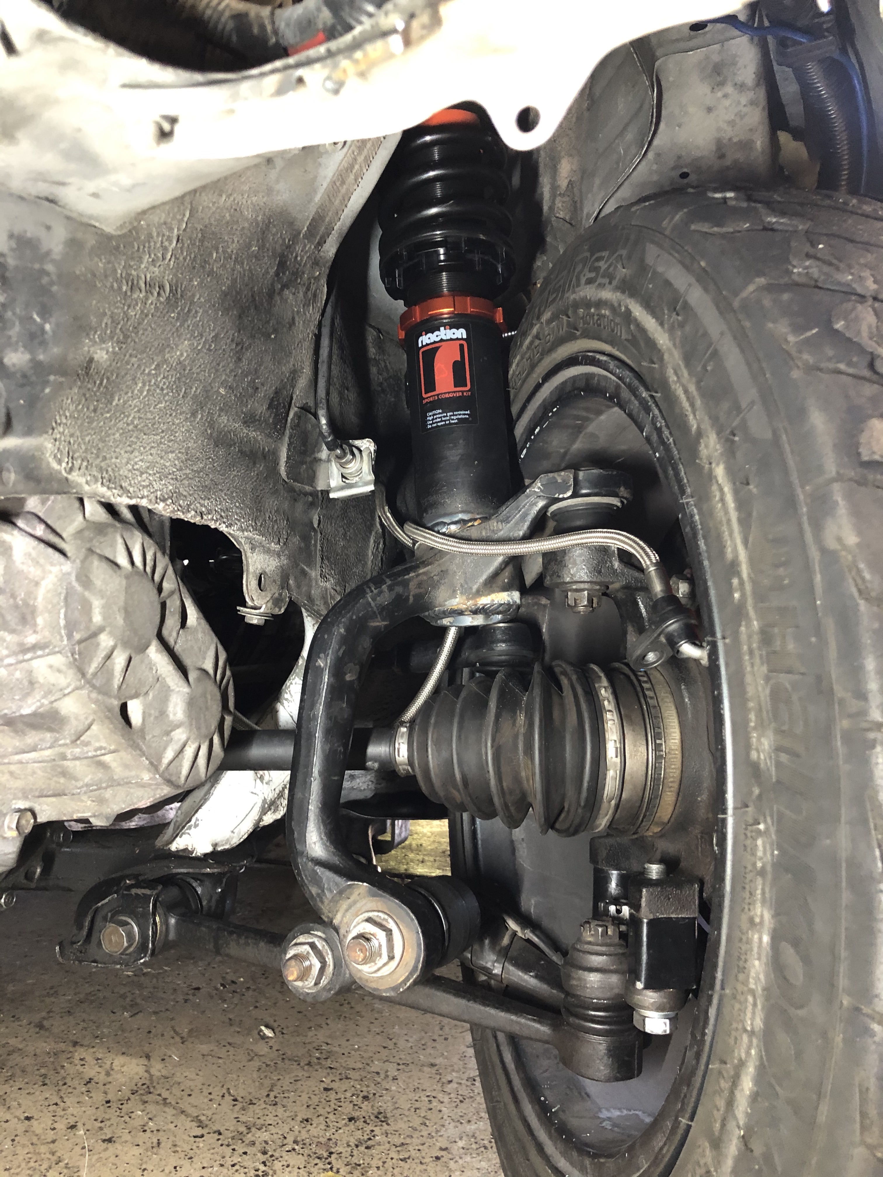

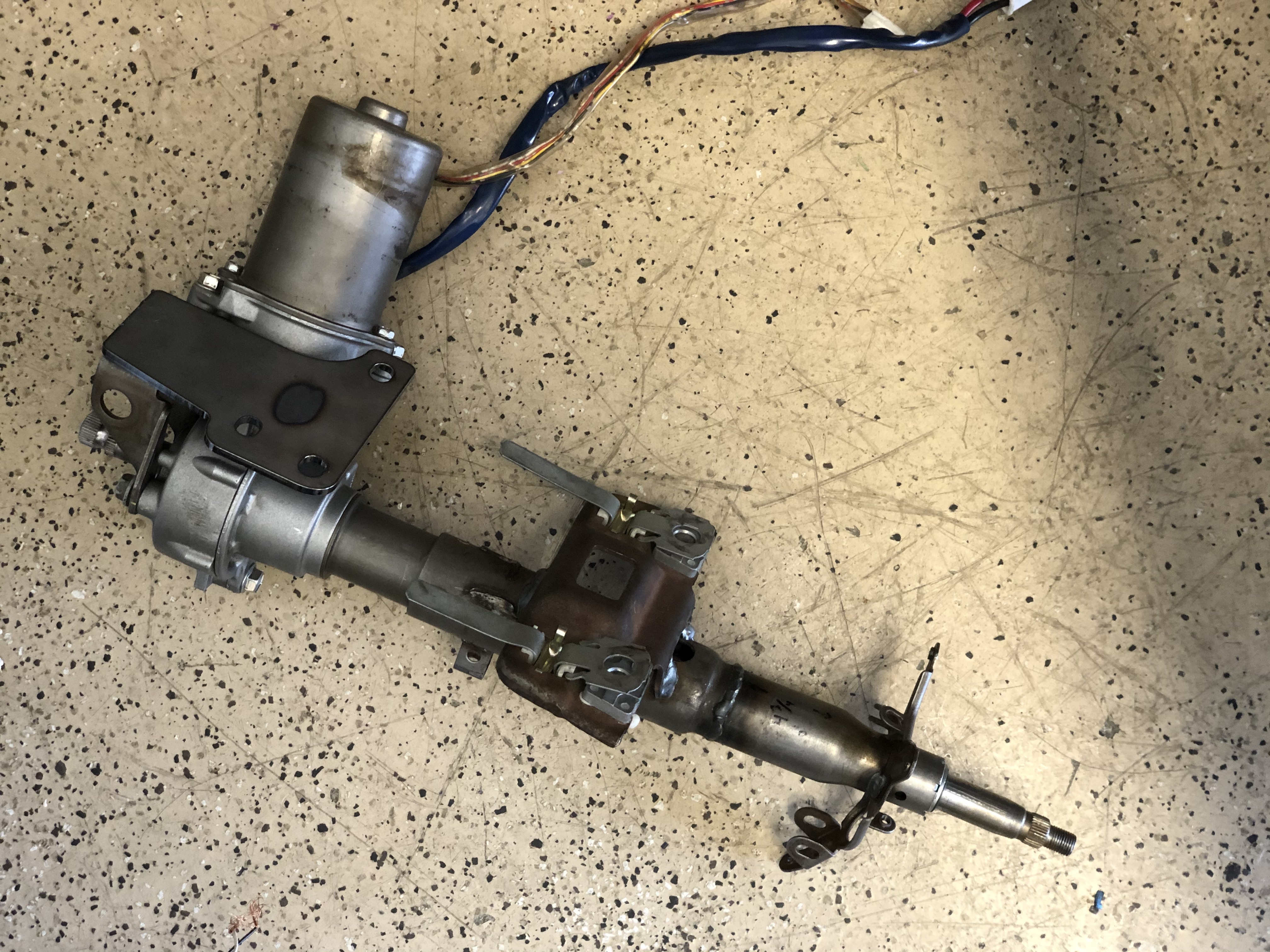

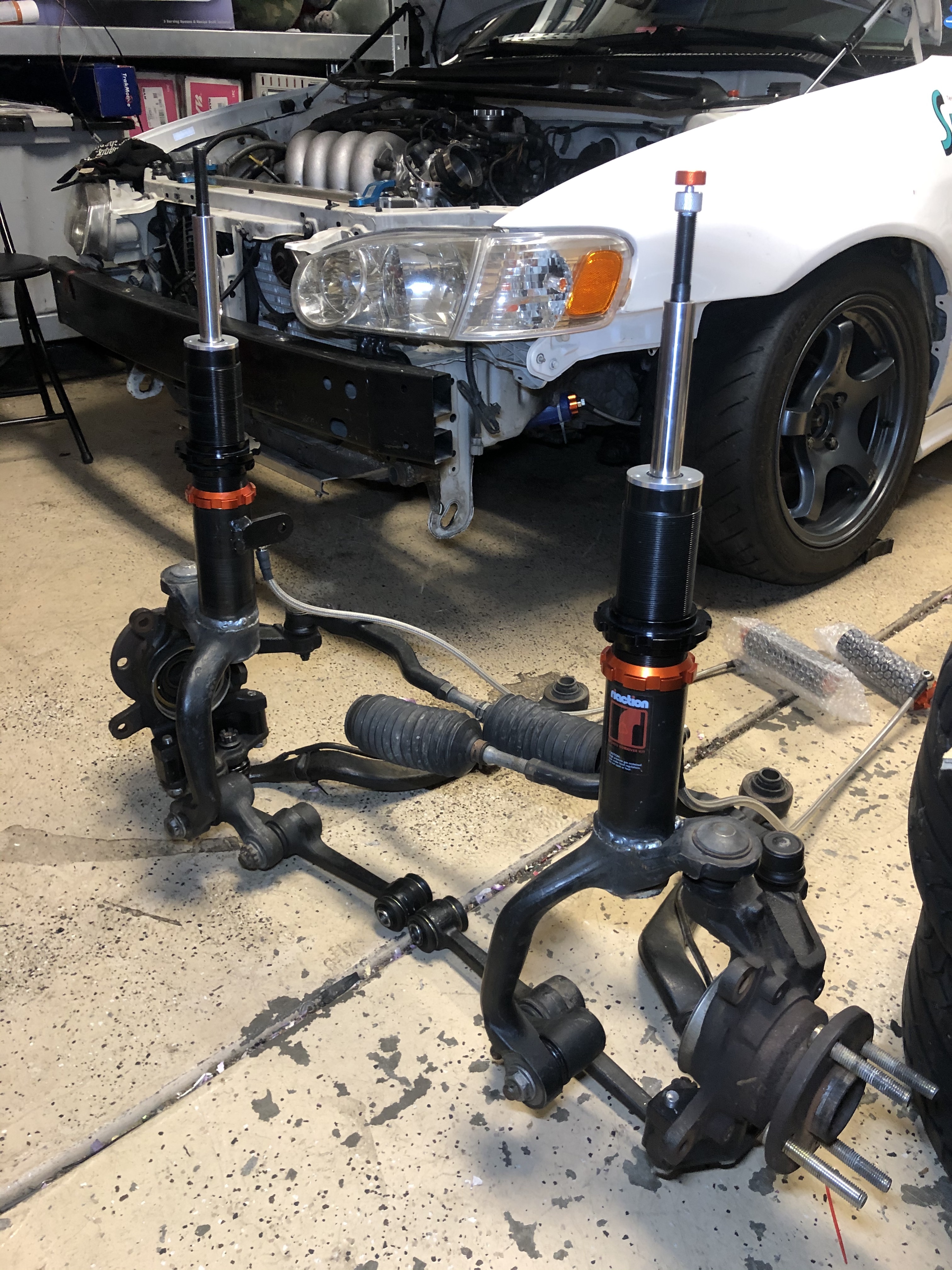

    So upgraded my suspension geometry to the ae111 Superstrut and got hooked up with some 2 way adjustable coilovers from a newer Socal company called Riaction, finally installed a Yaris power steering column, and next on the list is a DBW conversion. IMG_7841.jpg
    MattH, James, vortex and 1 other person like this.
    32,005
    That's pretty cool that you can just swap the suspension like that. Was it an option in another country or something? Or is it from a newer car?
    And what's up with the steering column, what's the advantage there?
    And I thought people generally hated "drive by wire" and preferred the old mechanical style

    So superstrut was a JDM option but ended up in Europe and it was reallly good. Biggest complaint was it’s pricey to upkeep. For all the arms new it is about 1200 but there’s a guy who can refurbish them now and makes it rebuildable at home for about 500 for the service and 80 for the parts now.
    So the column a ae92 guy actually did and I figure I try it. So I kept blowing pumps and racks trying to figure out a combo for the 2zz to play happy with 8th gen stuff and got tired of it and wanted to get rid of the fluids. And I guess less Power loss from the pump never noticed it btw lol.
    DBW on a oem setup is generally sluggish or weird. But I’m on a standalone ecu so I can program it to be 1:1 like a cable or by torque to pedal demand to prolong my trans from going out lol. Lost my final drive at a track day in January lol

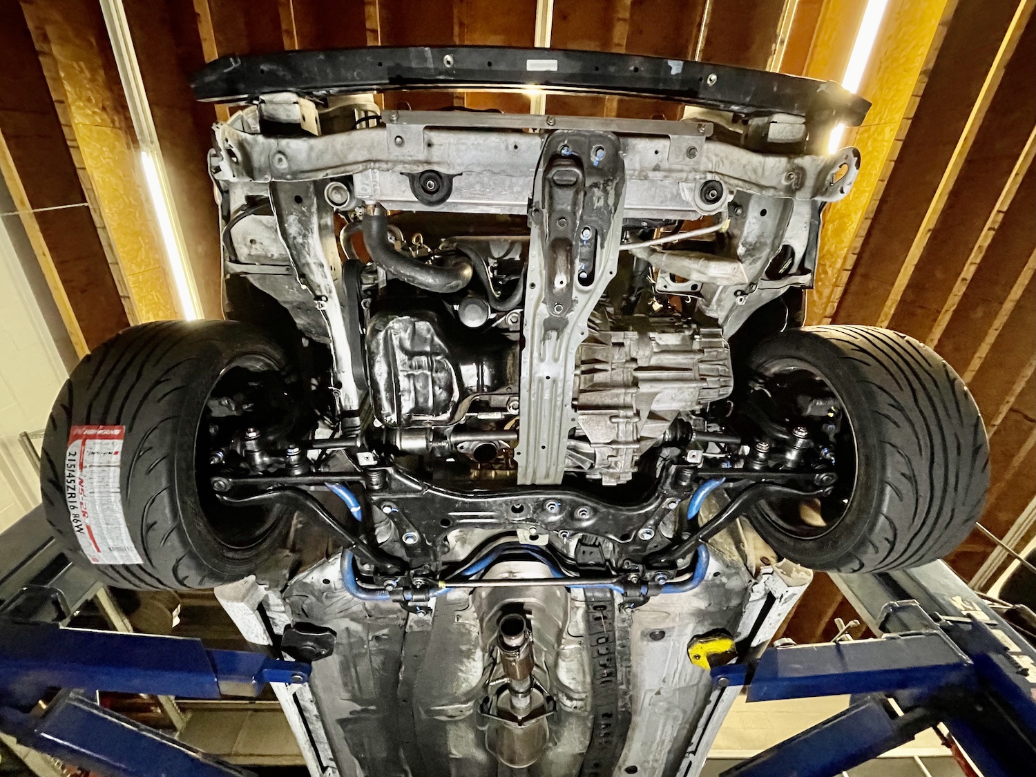

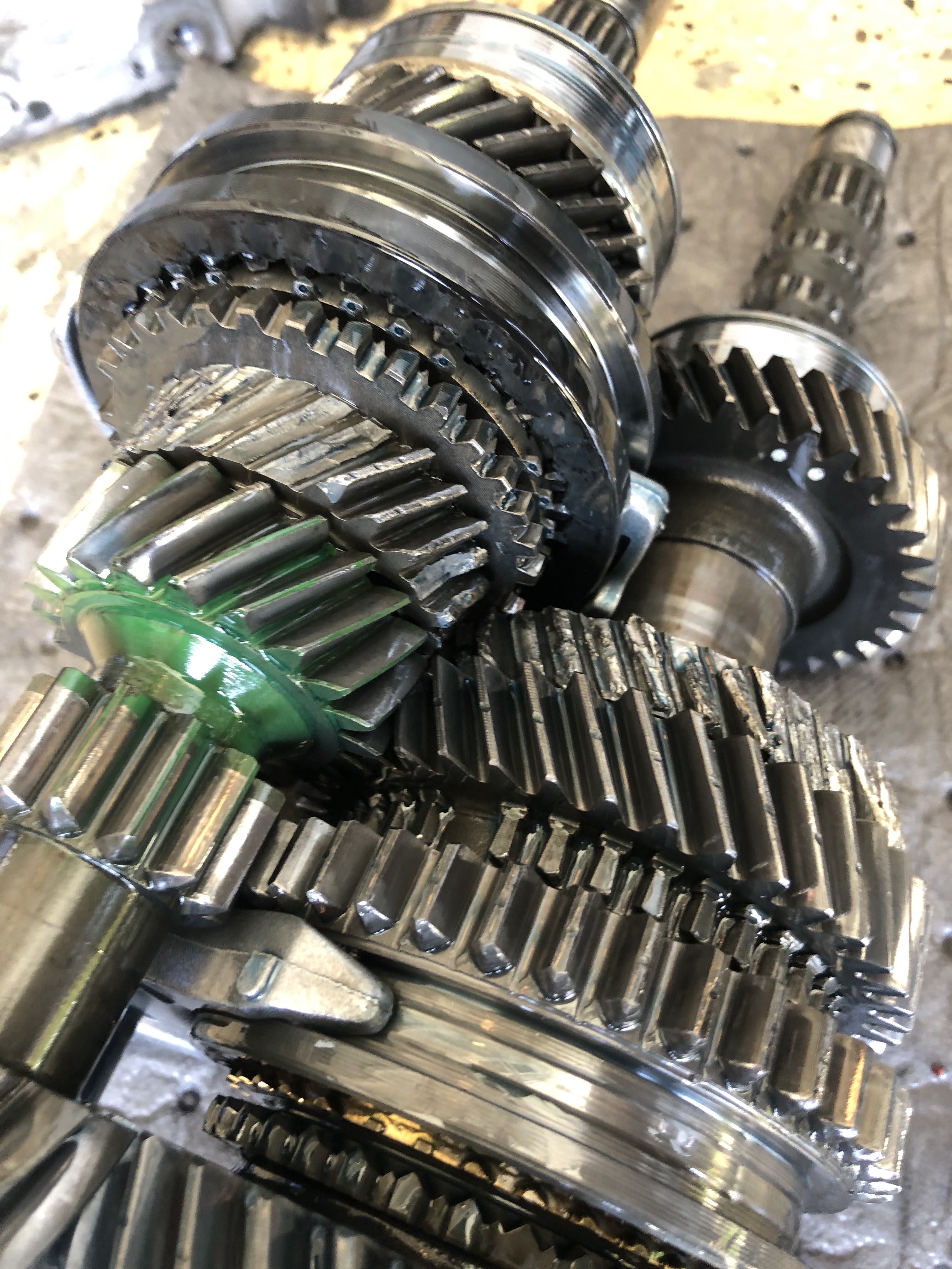

    Update Alert :
    So my ever so weird, stupid, maybe crazy quest for modernizing this old chassis continues.
    First up is fixing my transmission problem with a retuned OS Giken LSD for my racing requirements.
    And some VERY strong 3rd/4th gear.
    That should conclude my power delivery/Transmission problem. (for a while)

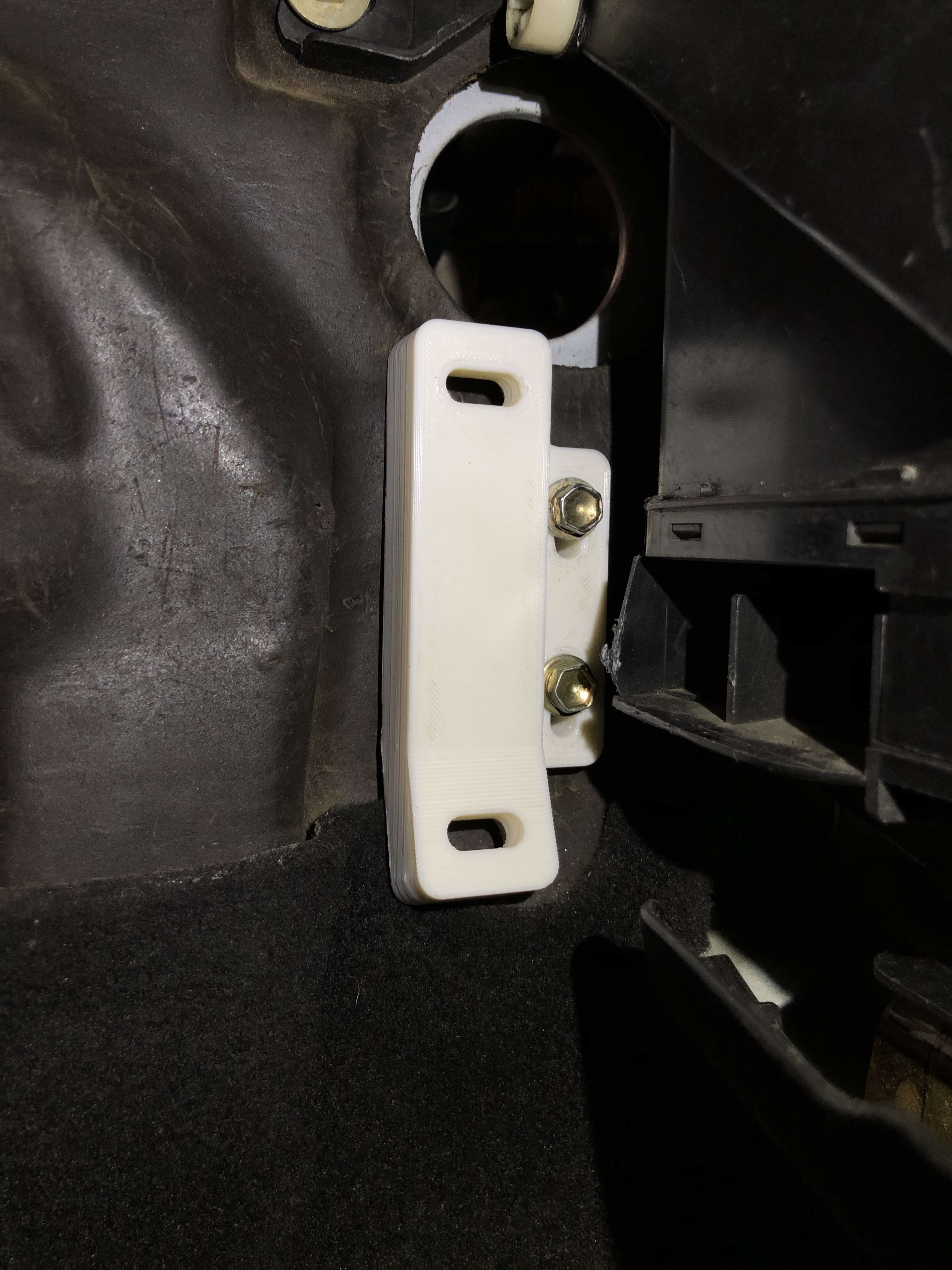

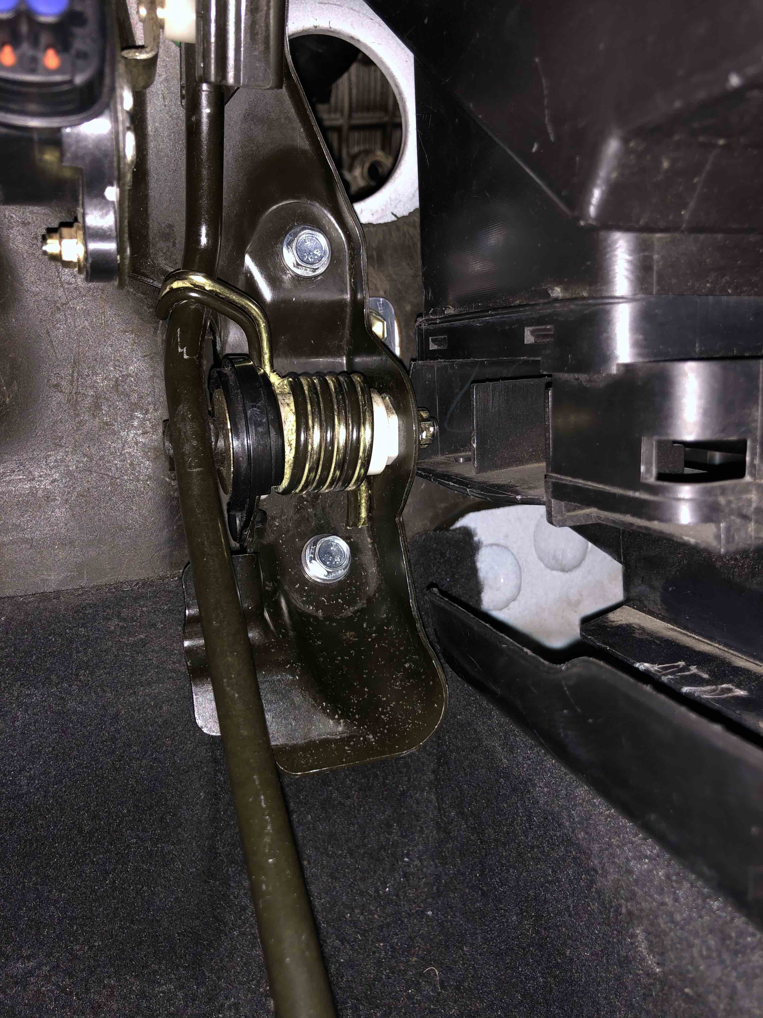

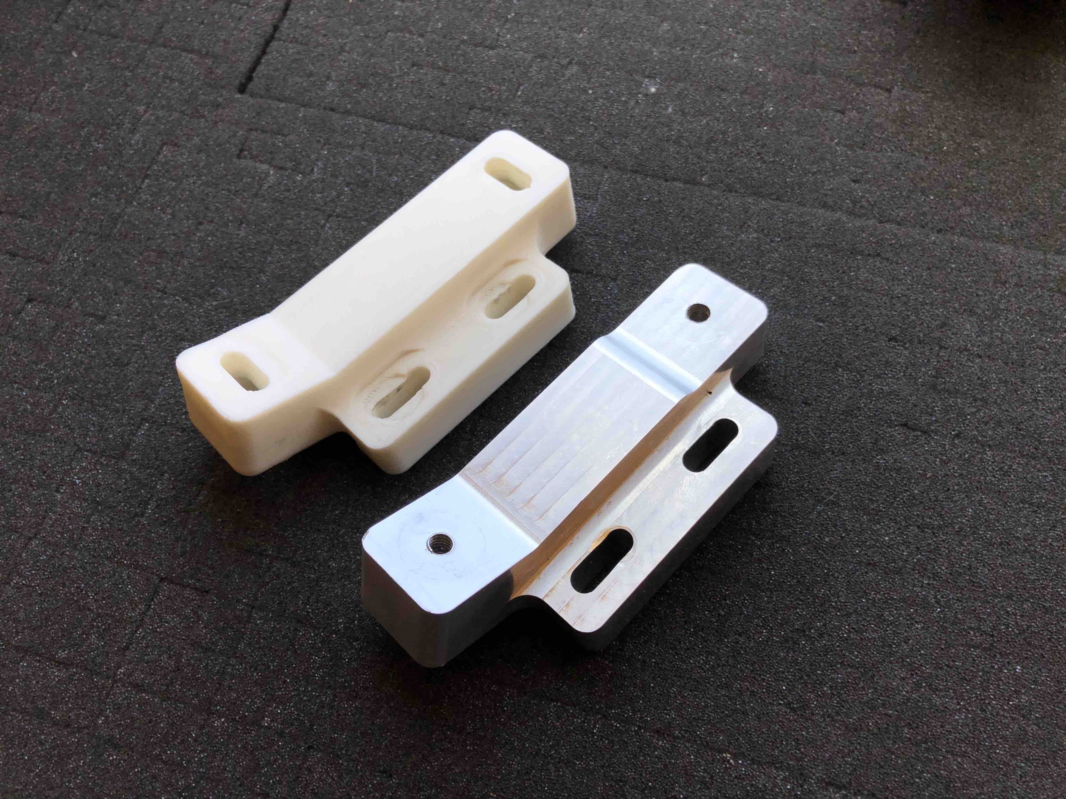

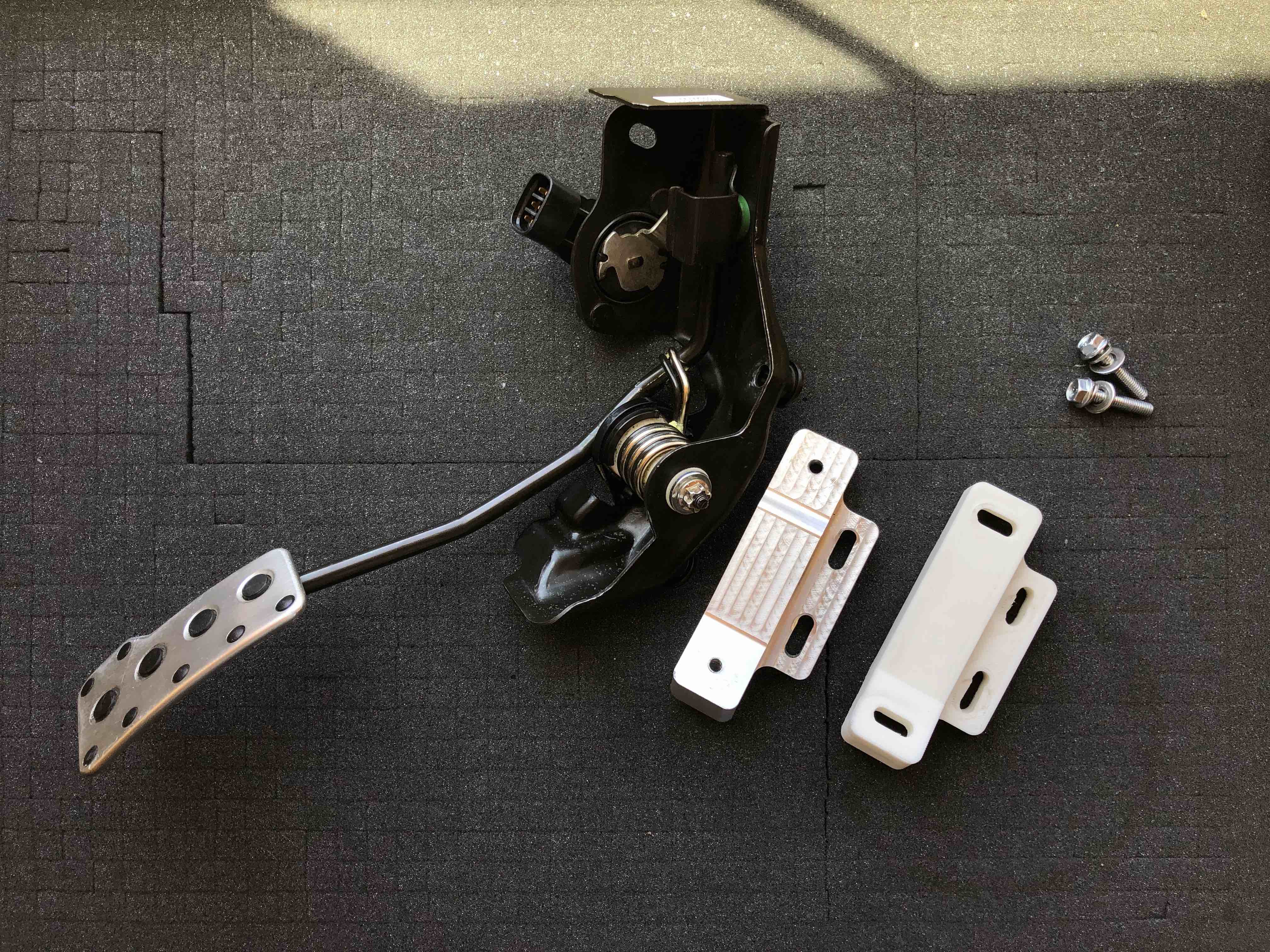

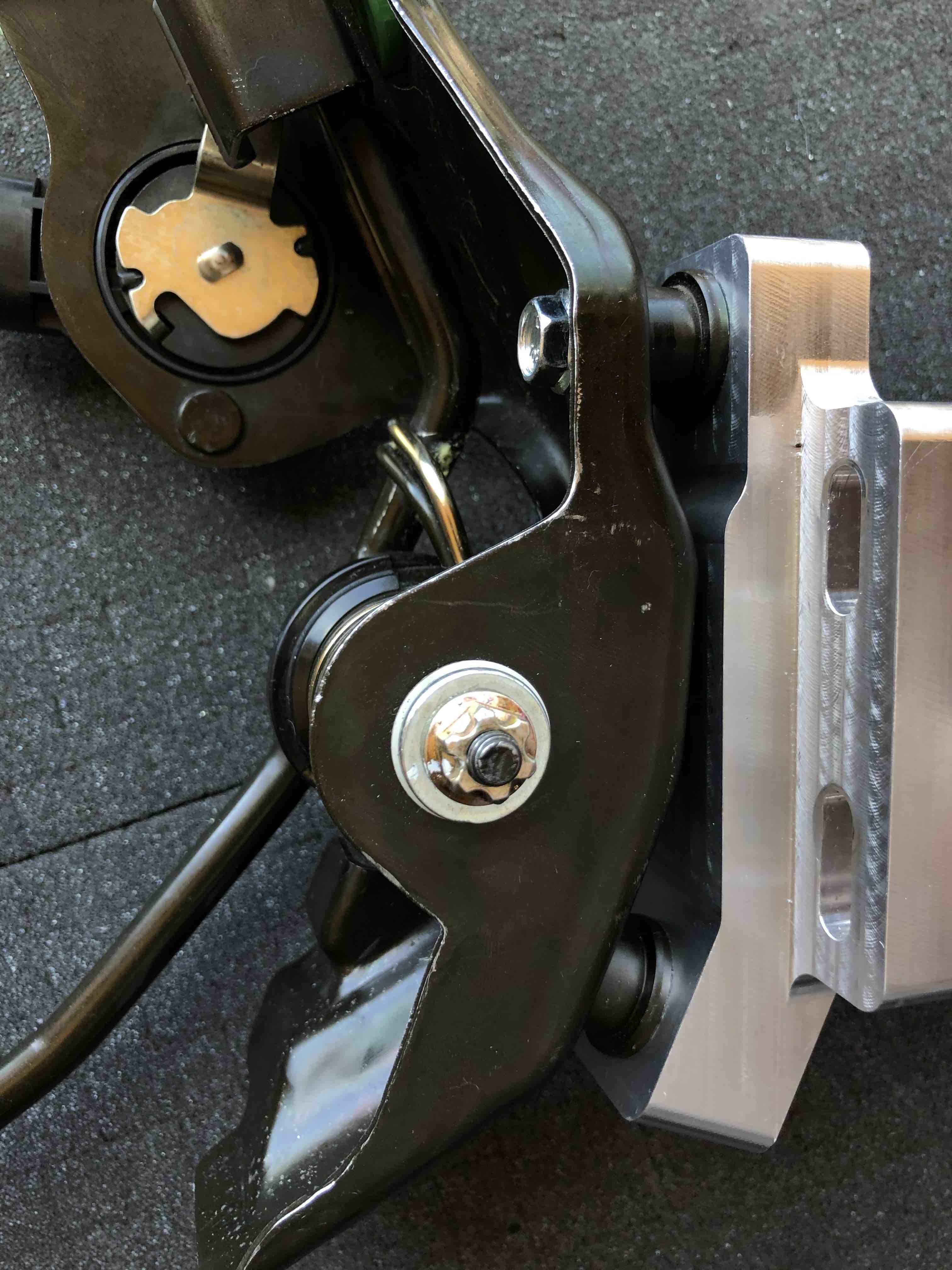

    Last was my recent update to use a Celica GTS DBW pedal. so i needed to do a little CAD work and testing to make a adapter. IMG_8369.jpg
    Came out pretty good for my first time trying to make a part lol.

    DBW Update: So pedal adapter is finally finished. pretty hyped with this, being my first go at making a part and having it CNC'd.(new possibilities ahead now)
    MattH, vortex and Goldy like this.

    Patched the car together for a track day. So far the upgrades are showing positive improvements!!
    Main shake was seeing how:
    2-Way coils
    ABS
    Super Strut Suspension
    Electric power steering column
    Temp Motor and oil pan was changed lol

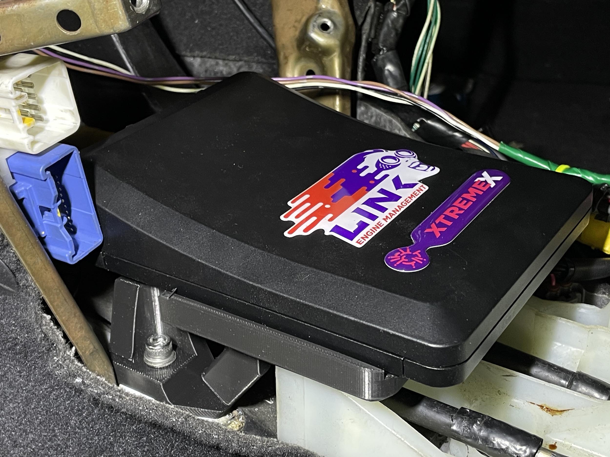

    [IMG]Made a little mount for my ECU

    Such a clean install. :joyful:
