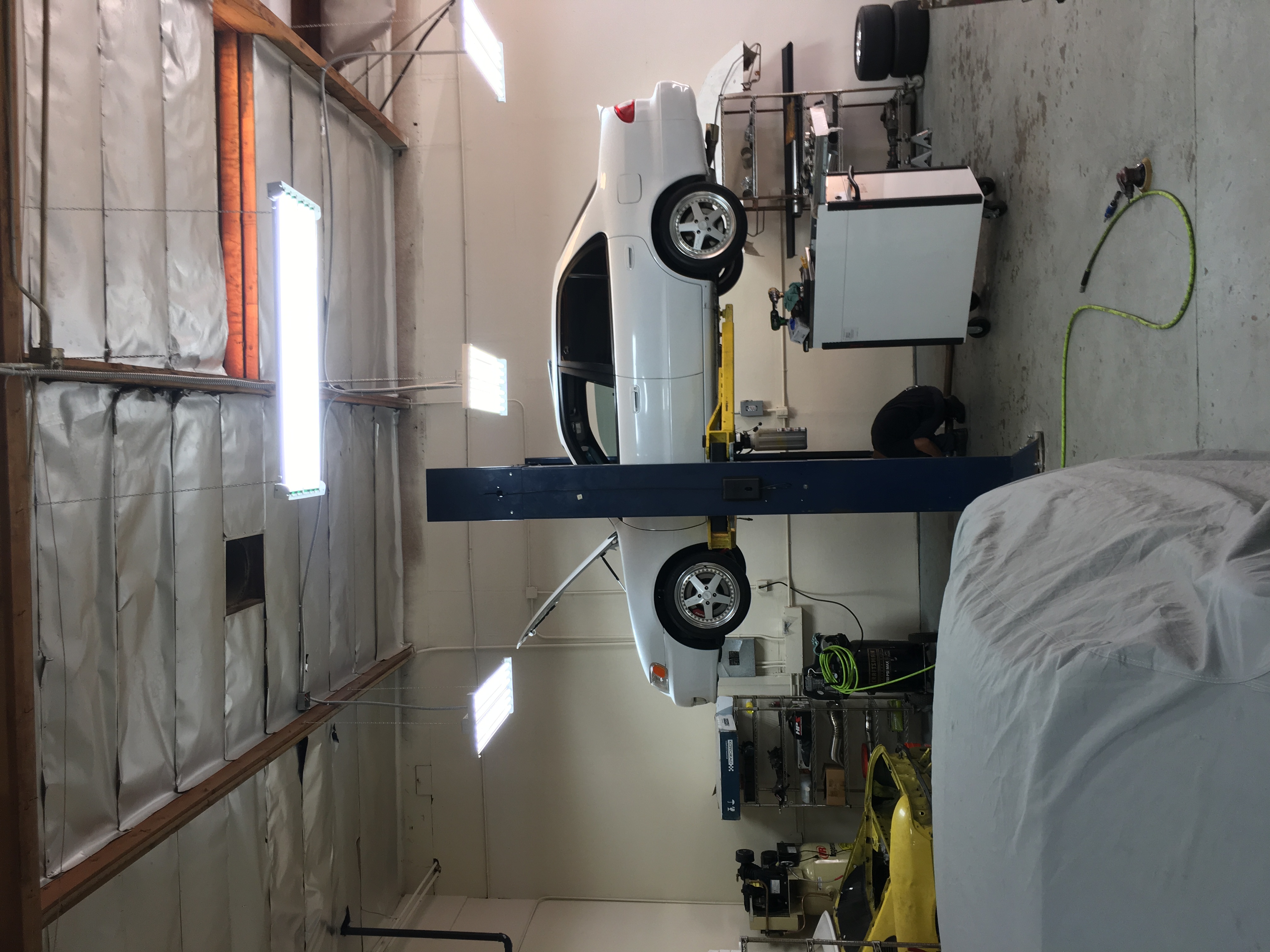

    So want recently i installed a Moroso oil pan,bigger tank and has baffles to keep my block safe on the track. Replaced a leaky OCV valve and had my mid pipe re aligned it was sitting on the body making a bit too much noise and vibrations.
    Ohh looks good. But is it fast?
