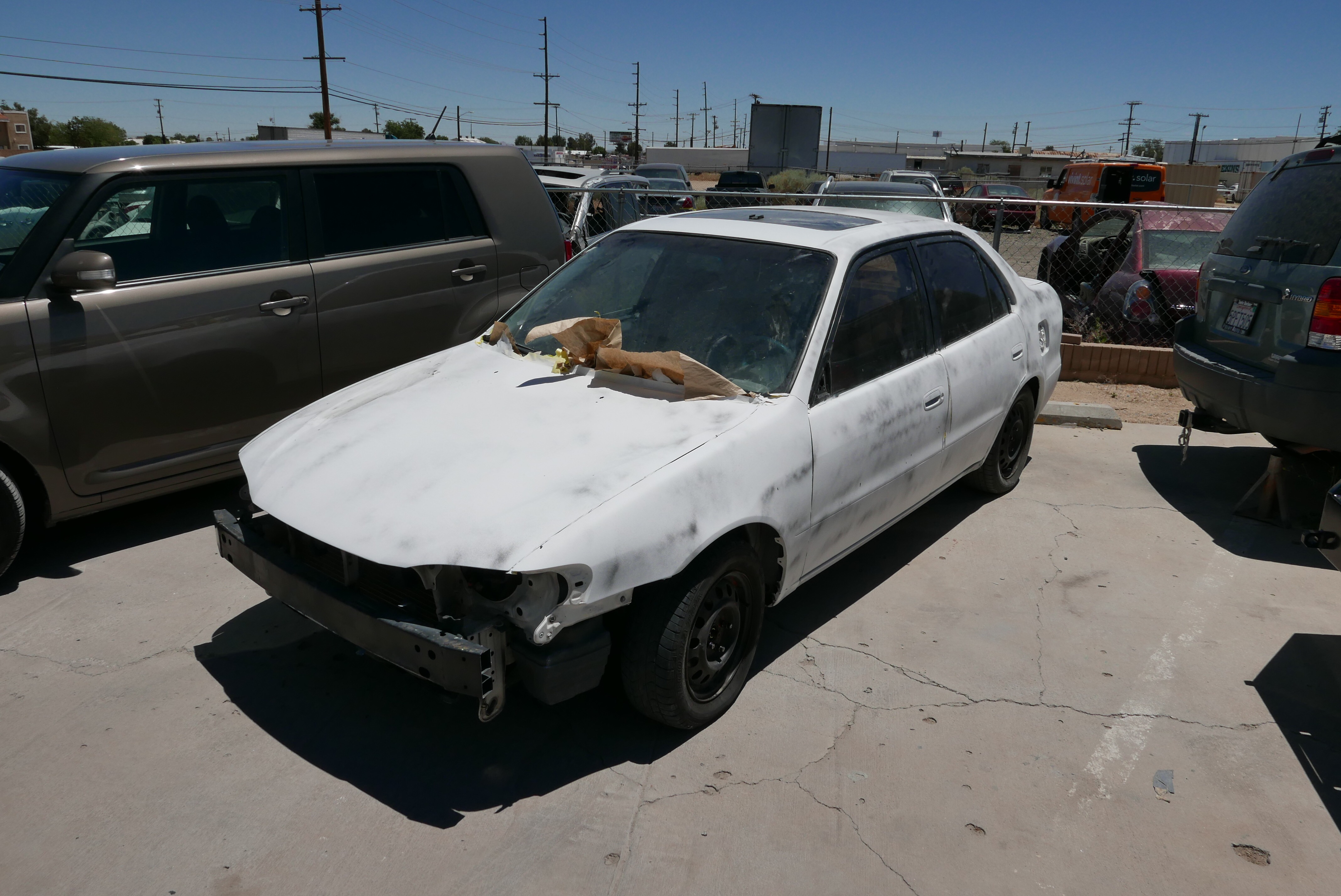

    Well guys finally decide to try a build.
    So a little background
    i have/Had a 98 LE i have been deciding to get rid of and have been on the fence since january, i was on the hunt for a 01 white S with sunroof and a 5 speed... long story short,it's like finding a unicorn for a good condition one... so my solution just make one yourself.
    Heres is what i have going

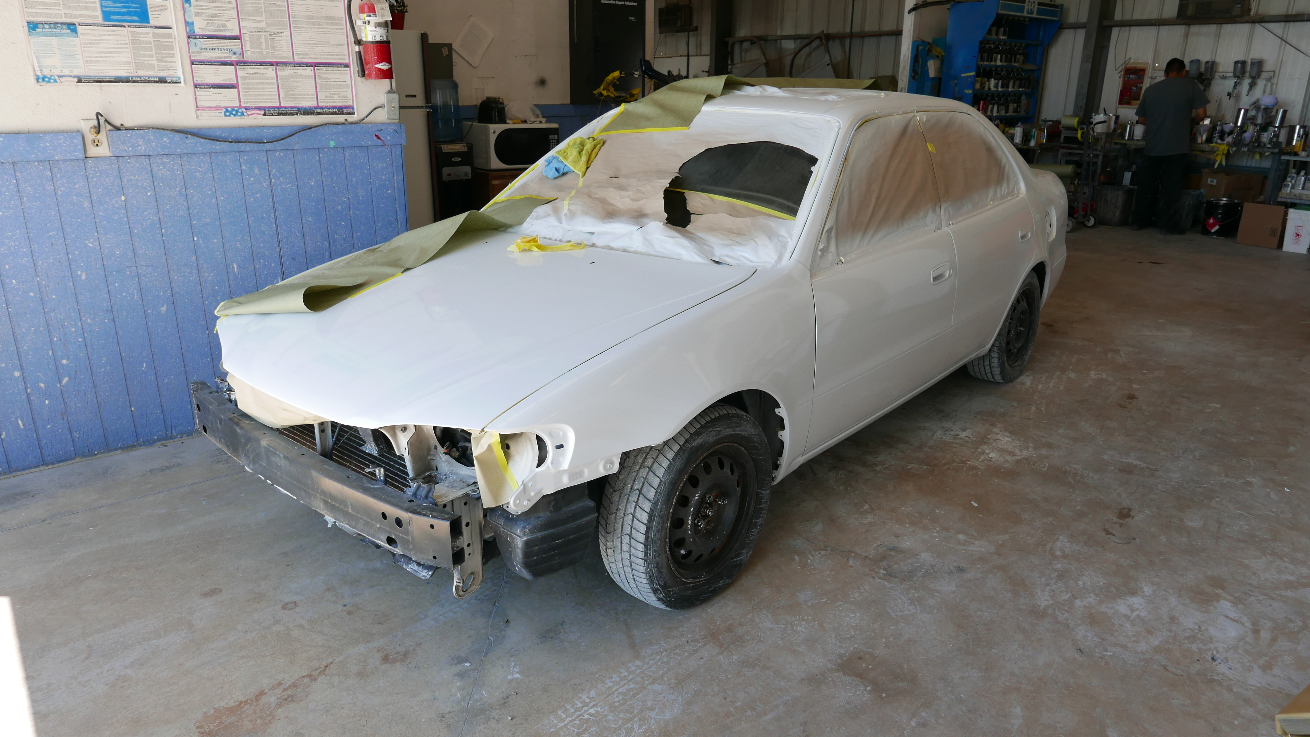

    Before

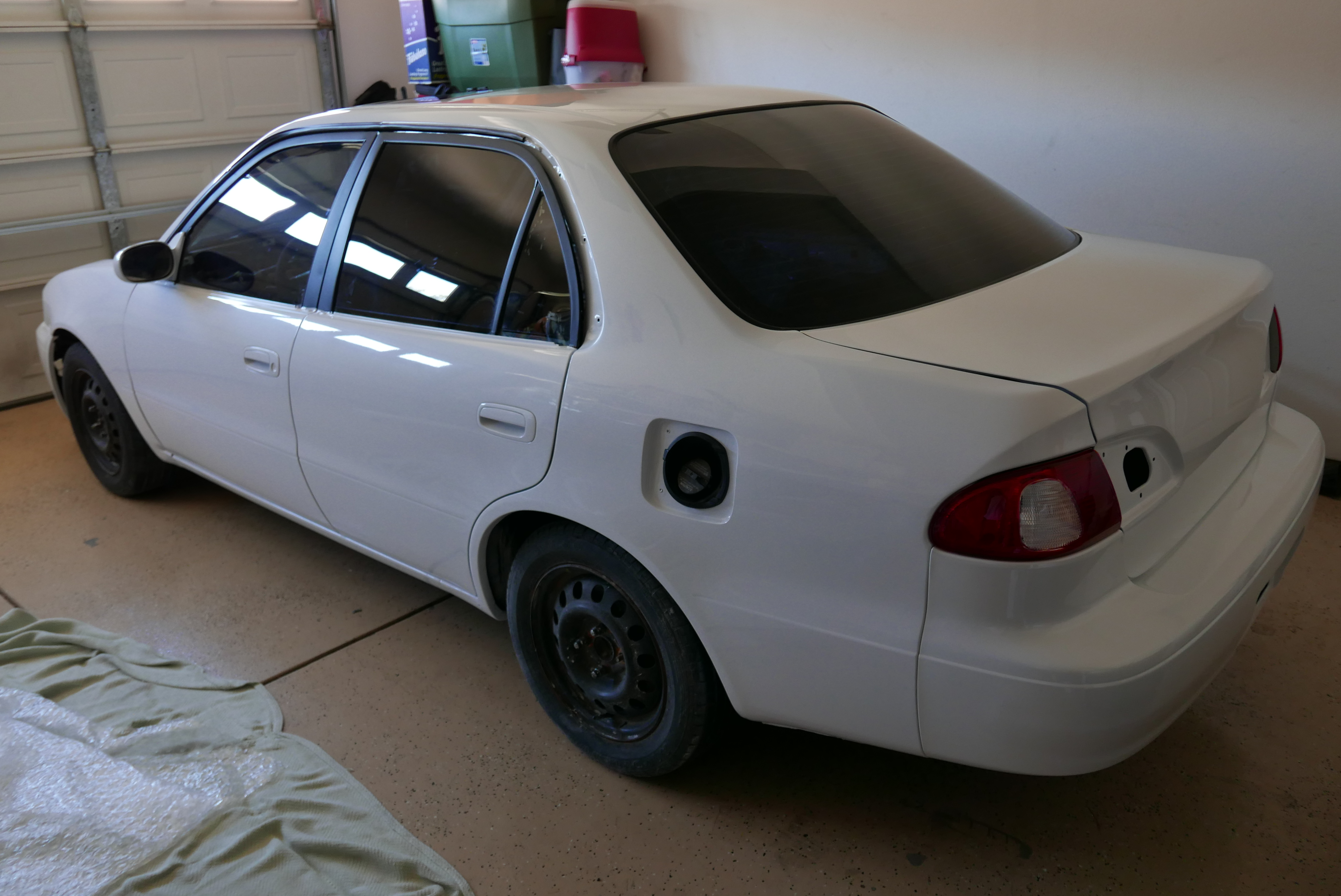

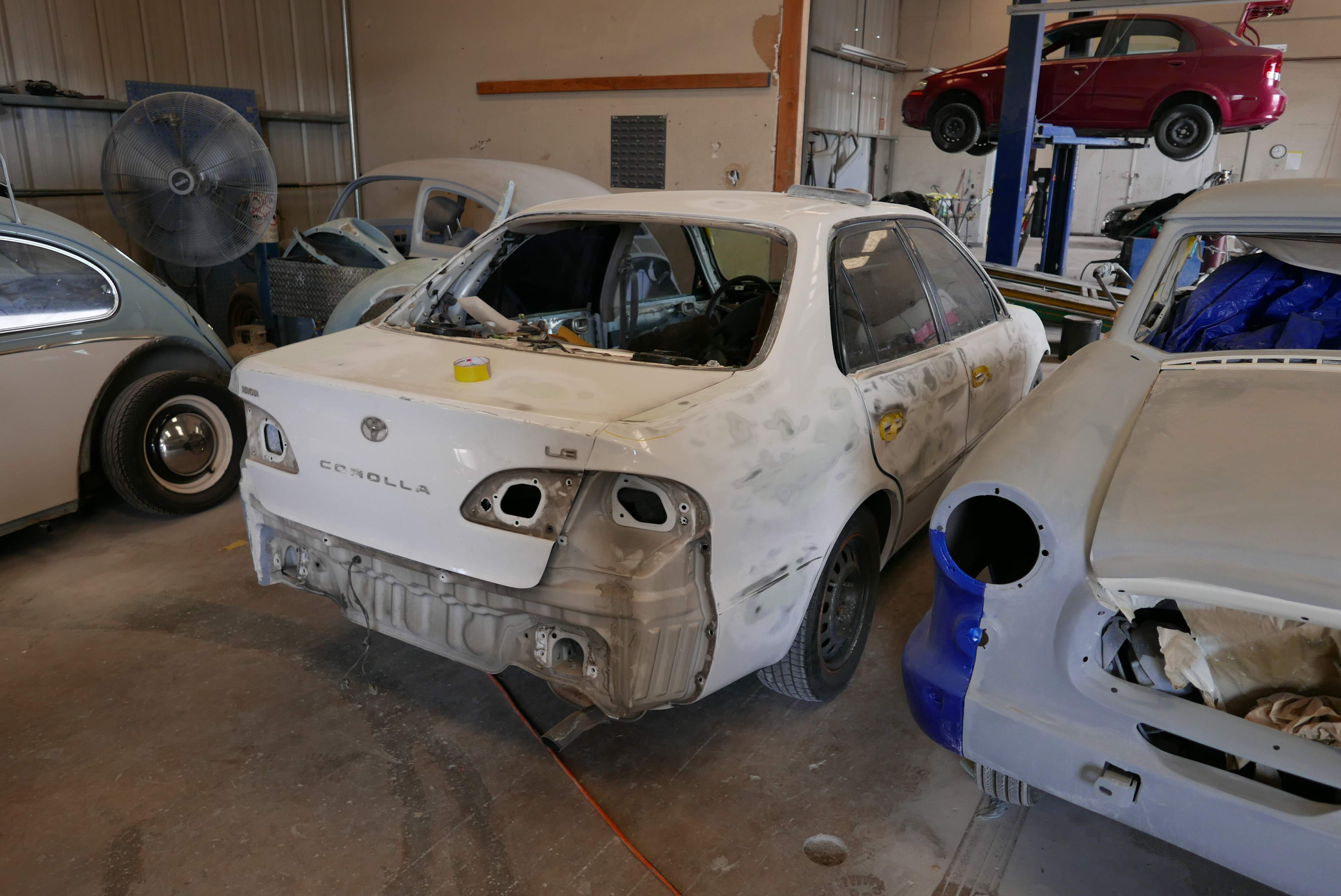

    So my build began. but first a trip to the paint shop for a little TLC.
    The car is now a Lexus Ultra white. brighter than toyota super white and also has a slight pearl to it

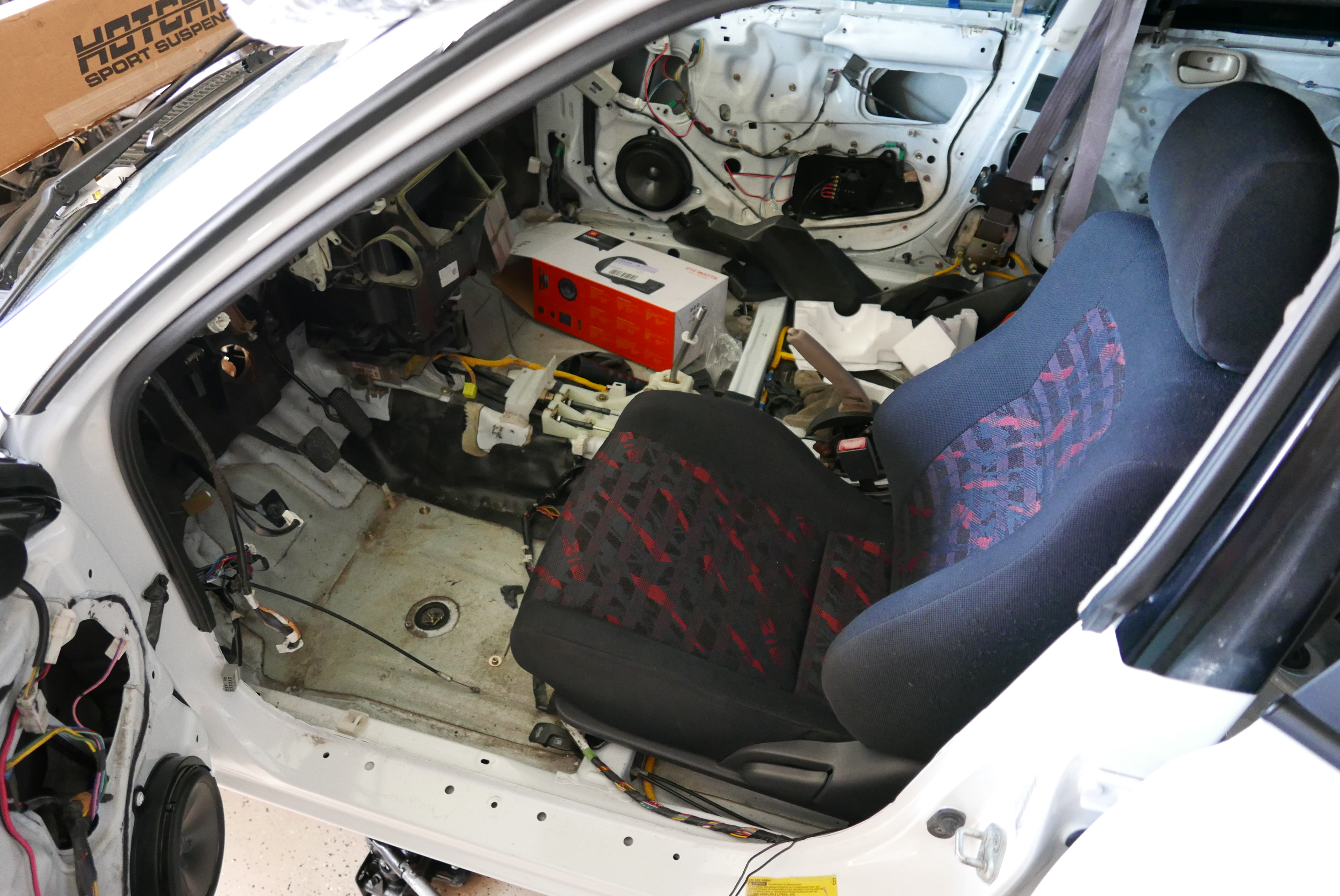

    Now the real fun has started. I had to clean up all the gunk and dust that the car has collected over the years pressure washer and degreaser were my best friends

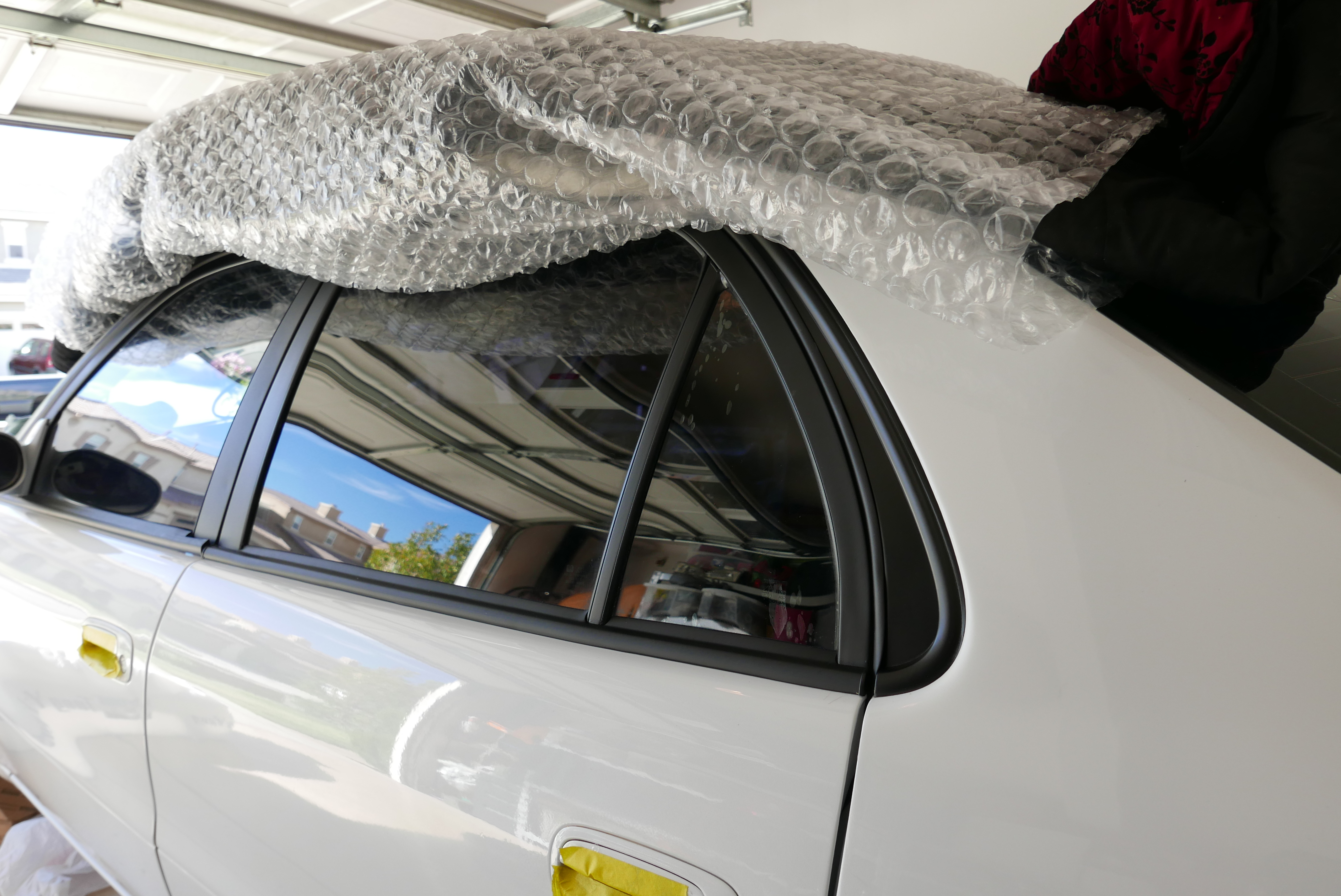

    Installed all new trim and weather seals.. Front trims needs need clips

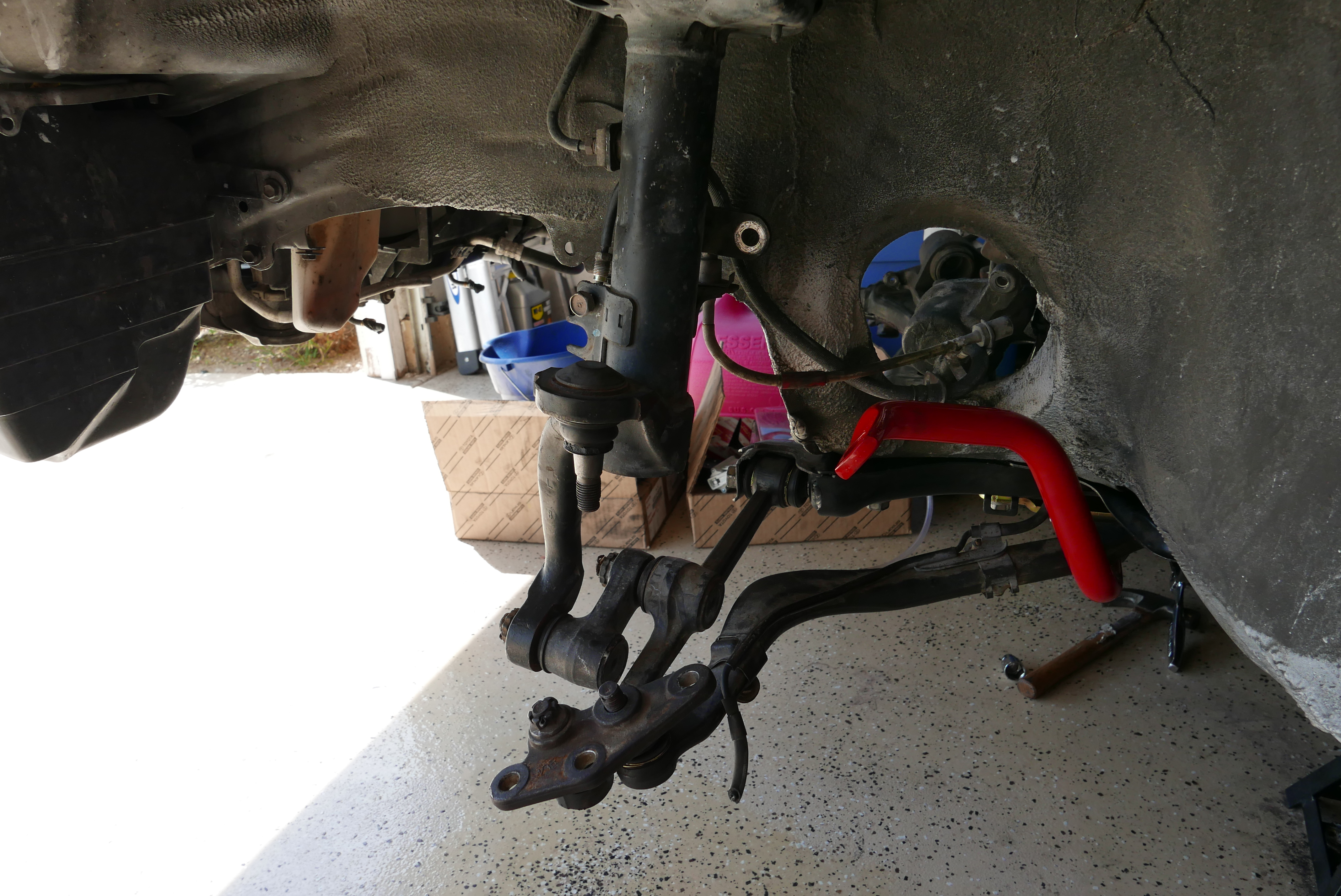

    Painted the crossmember and the lateral arms also installed poly bushings into the rear arms and installed my hotchkis rears.
    Also i am going from a sport daily so i decided i wanted to give the Superstrut suspension a try sadly my hotchkis sway in the front won't fit here
    Next was to install the new speakers... got way to eager to test fit my ae111 seats also lol

    Finally got to finalizing the trimming from the back end to the front doors

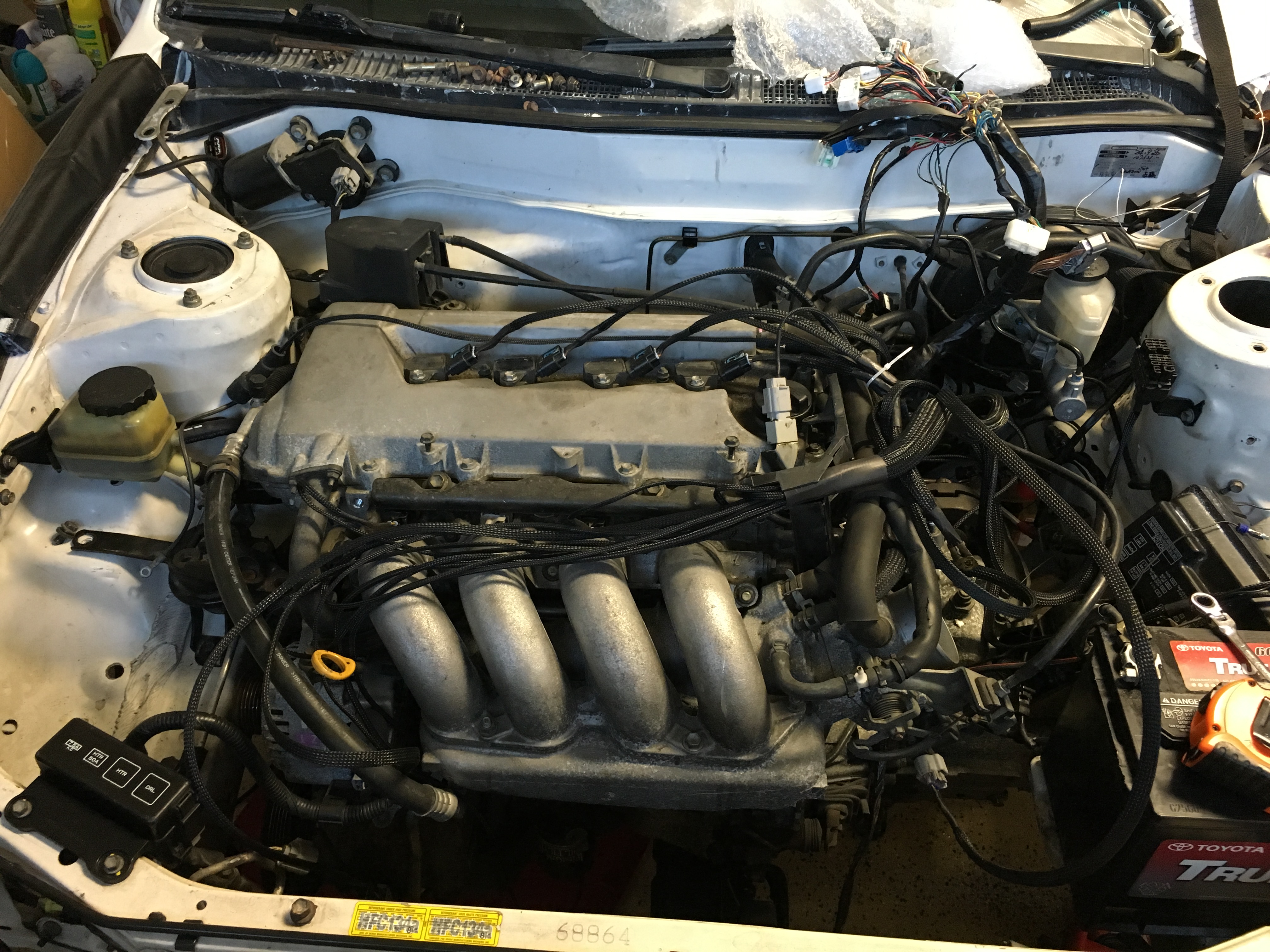

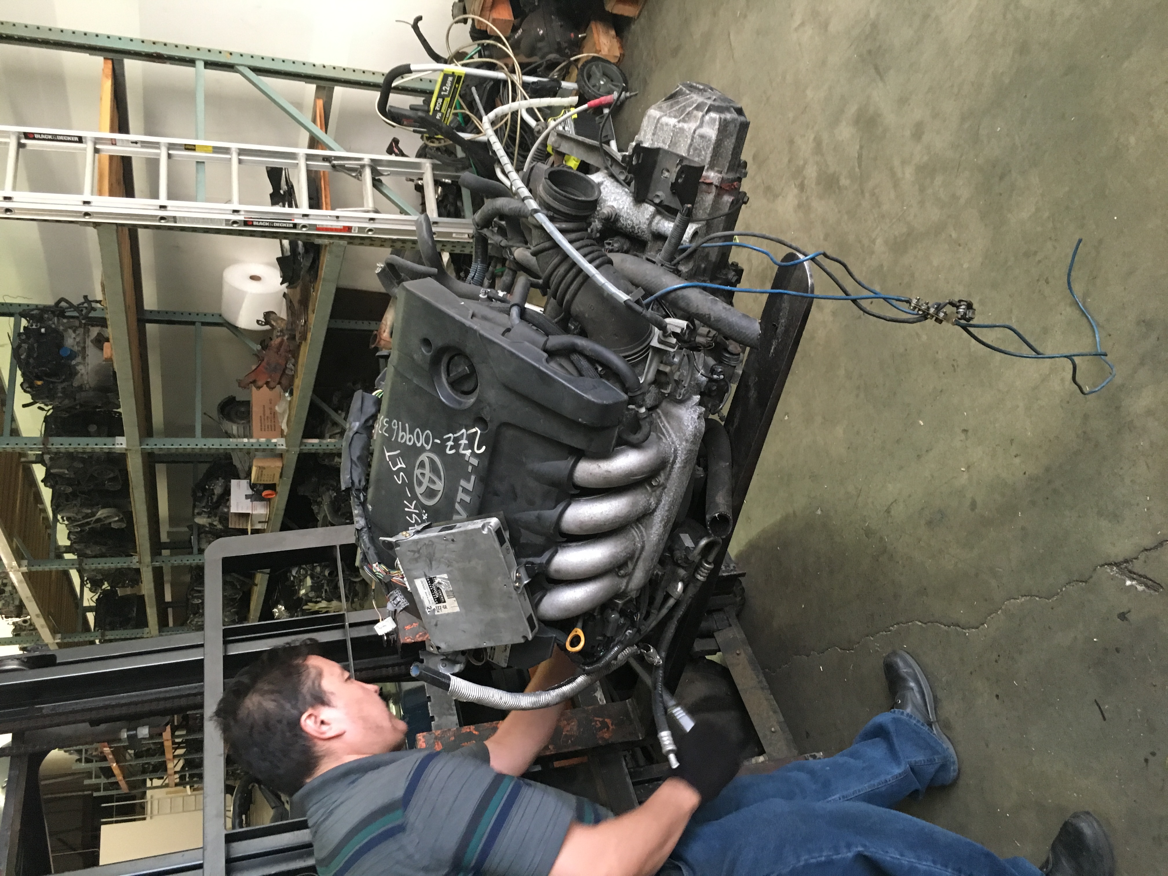

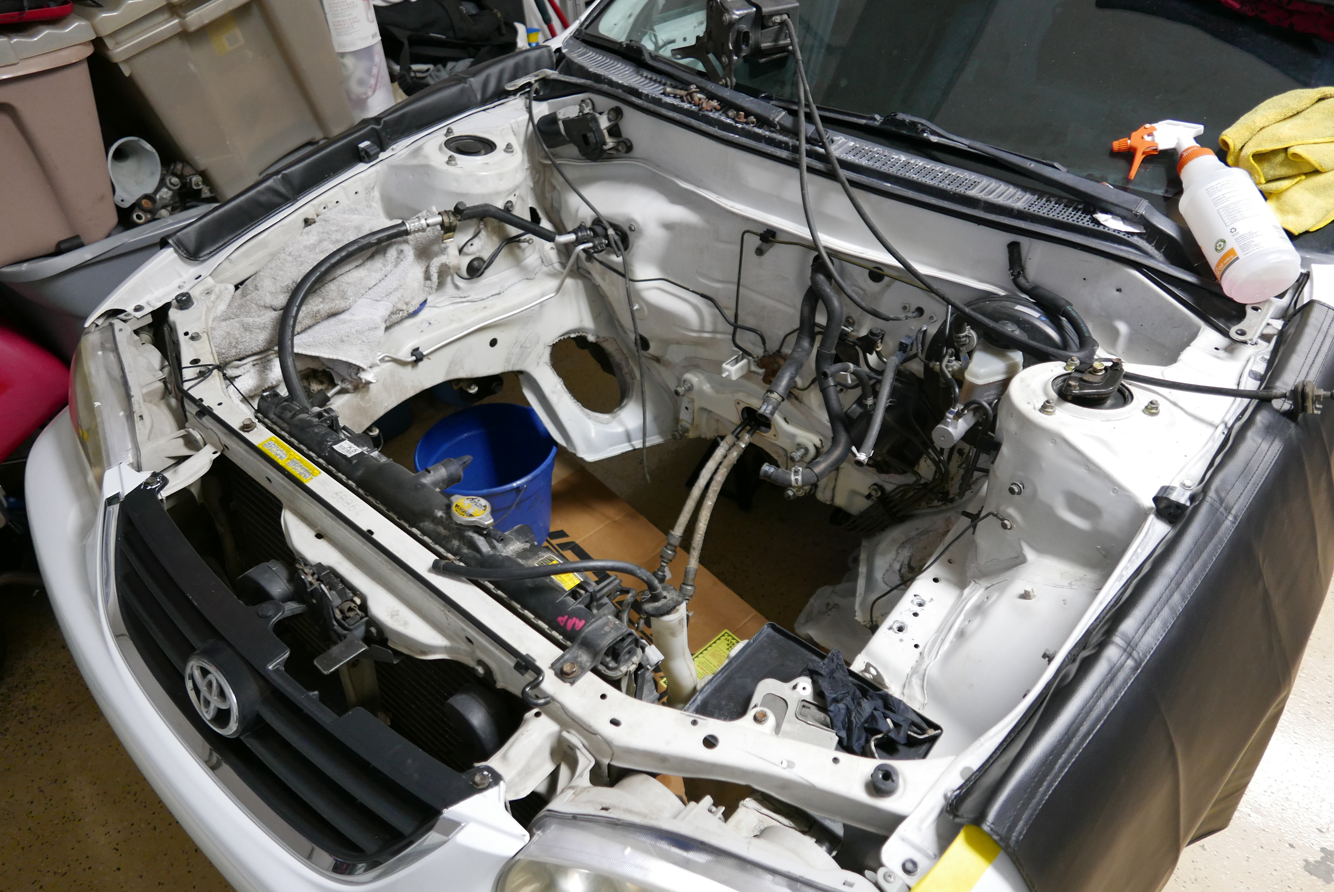

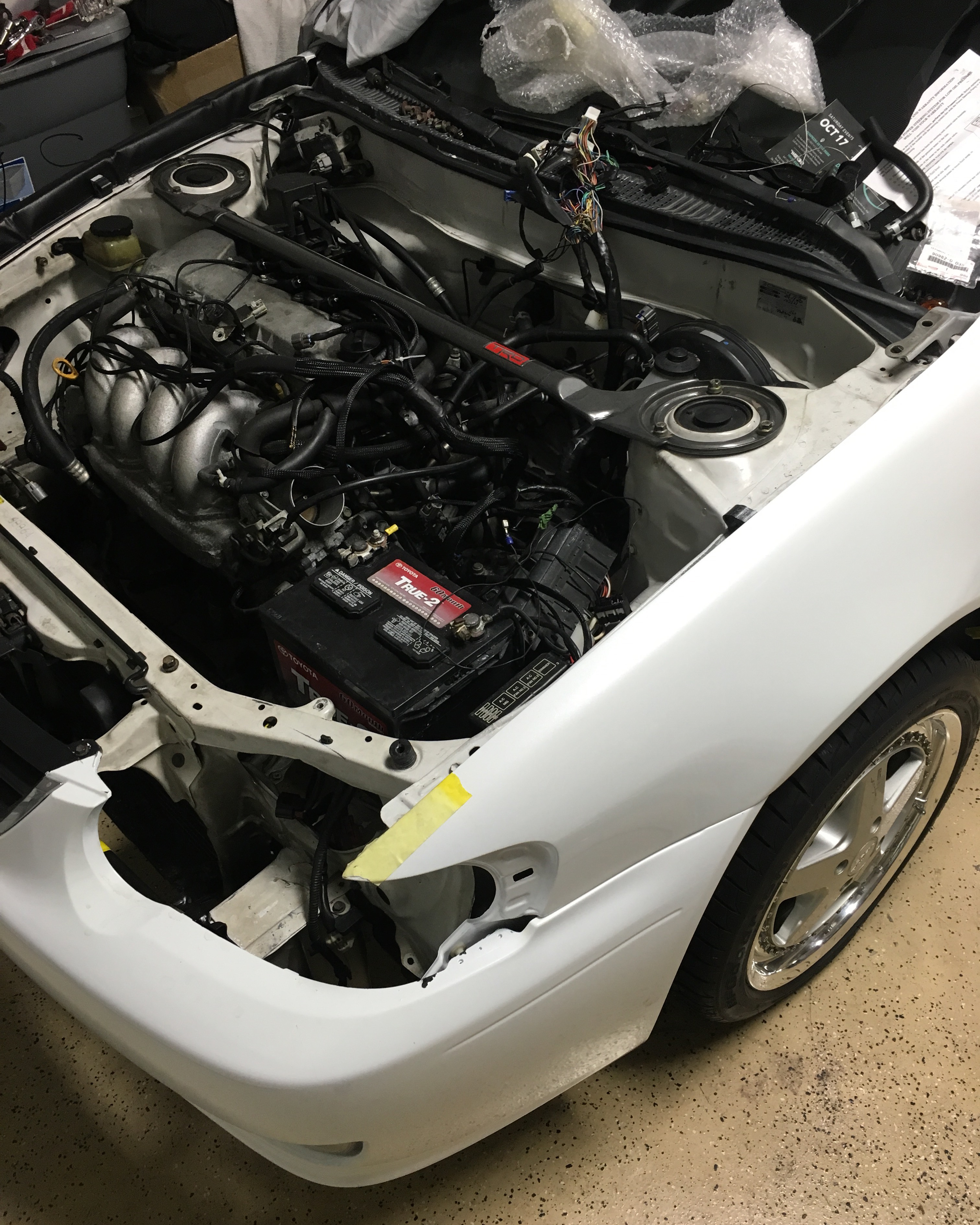

    So sites finally back up here's a update
    got the 2zz installed and fits perfect aside from the passenger mount

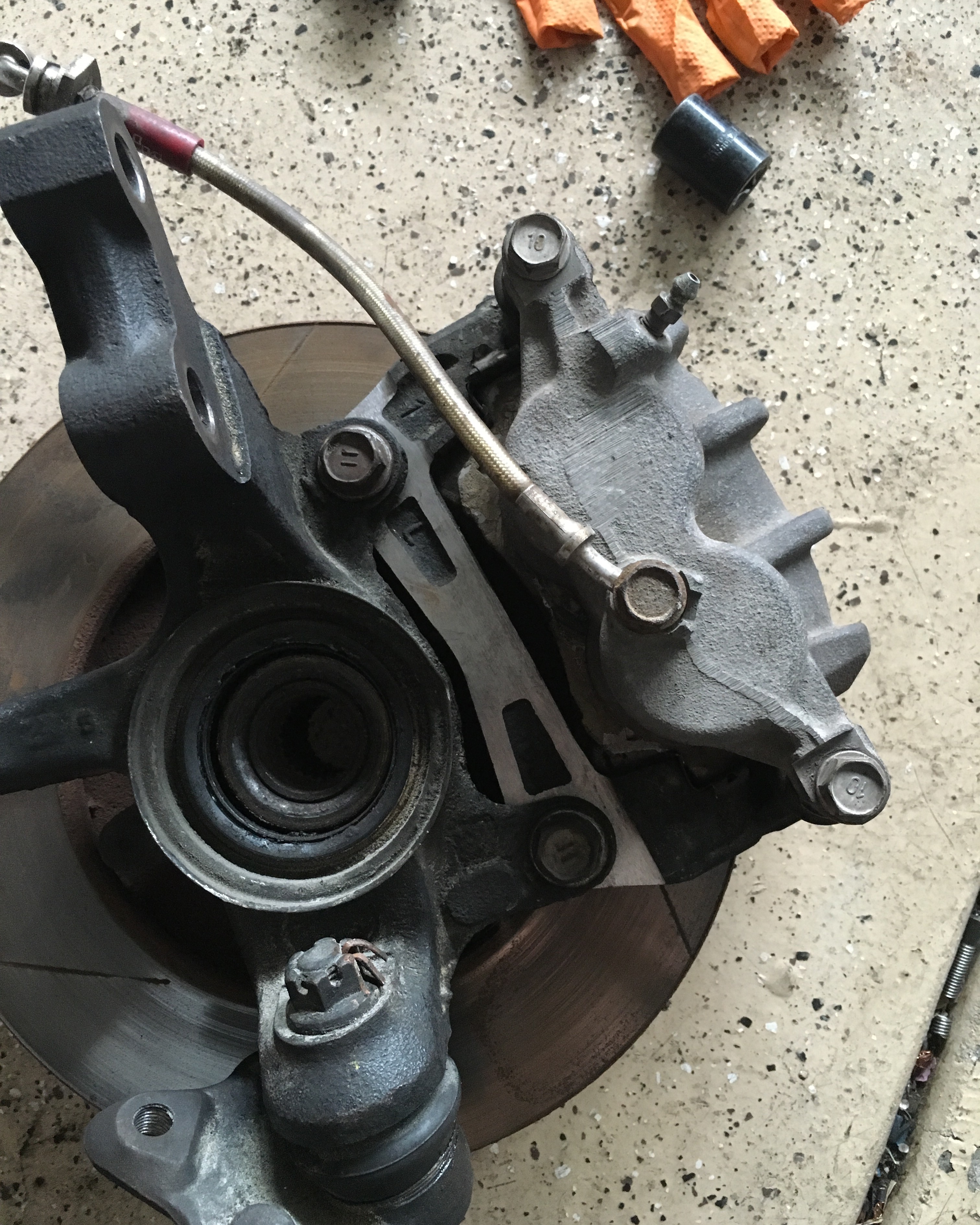

    Also did a big brake upgrade up front.
    Always wanted to do this one only required a litle machining off the bracket
    Ae111 superstrut rotor and twin pot caliper/ with celica st202 brackets with 3mm shaved off the back
    other than that direct bolt on zero fitment issues

    And she is finally rolling out the garage.
    2 problems at the moment.
    -fans stay on (possible harness short,air in block still,or bad ect)
    -No lift yet (gotta check OCV valve filters or lift bolts)
      File size:
      3.8 MB
      Views:
      2,178
    The fans will stay on because of how the celica is wired. Mine stay on as well, haven't bothered to mess with them yet.
    Not having lift is a wiring issue. If it was the bolts or OCV you still be able to rev pass 7k. Did you send ignition power to the ECU?

    307
    Turns out the relay polarity backwards somewhere along the line

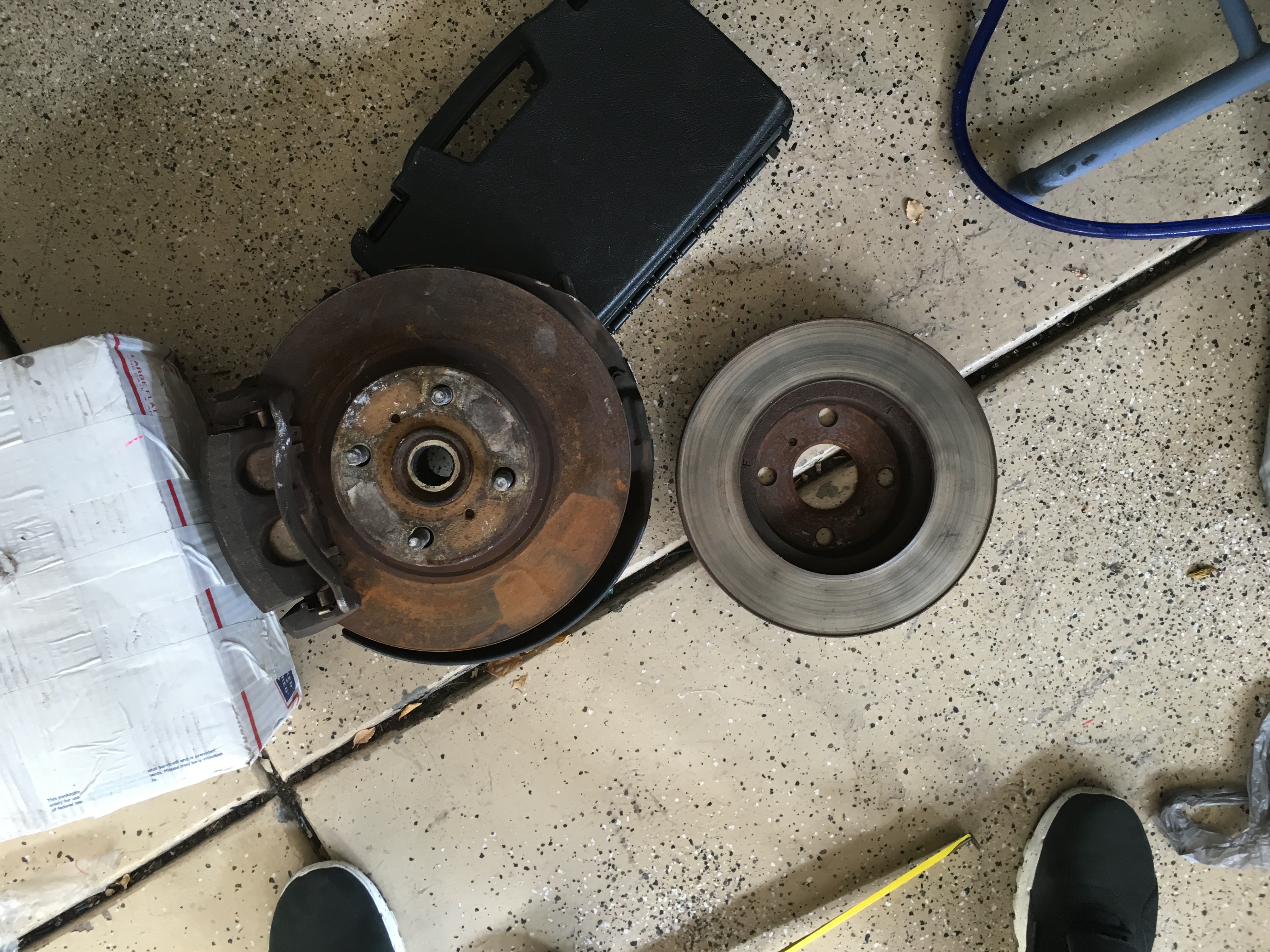

    Since the Clutch is getting done i scored a set of cusco Coils. so i am installing new rotors,pads and o2's also
