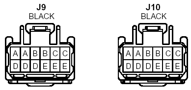

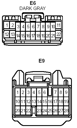

    The 00 has a couple tach wires. some on the ECU, another one elsewhere.
    ECU ones are on E6, pin 13......E9, pin 27
    --black wires
    then there's a junction connector J9 pin B, J10 pin B
    -- also black wires
    I dunno where they are though.
