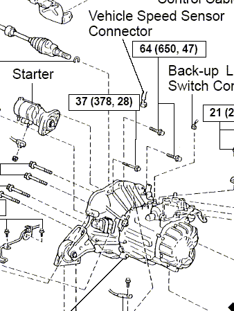

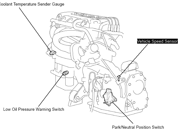

    Does anyone know where this sensor is located? The pictures in my Haynes manual didn't help too much. I'm thinking it's the harness that I see beneath where the battery would sit. Any confirmations on this?
    1337Rolla oh my
    3,979
    here ya go!
    edit:that pic actually may be slightly incorrect if you have a 5-speed.
    1st pic is with an auto
    2nd pic = 5 speed

    Thanks. I was right in my assumption then. Hopefully a good cleaning of the harness will cure my probs.
