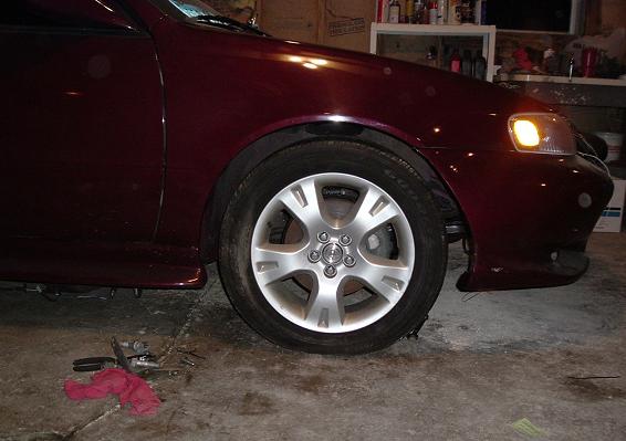

    Savannah, GA
    Laz Z Kay "n00B, be kind"
    1,662
    Biloxi, MS
    Great job. You even did the 5-lug conversion. That's crazy.

    Dr Tweak, what is required to do the 5 lug swap?
    1,662
    Biloxi, MS
    An 8th gen with XRS rims. Us XRSers not unique no more. :( :(
    Dr Tweak Mad Scientist
    1,237
    Savannah, GA
    The way I did it was, I took the Matrix hub and had it pressed out of the bearing, and then had it machined down about 2mm, and a small spacer made so it looks just like the 4-lug hub, pressed that into the Corolla bearing, and then the splines are different, so you have to use at least the outer cv joint from the Matrix, which also needs to be machined so that it doesn't contact the outside of the hub bearing.
    The brake caliper bolts right on.
    You could do the whole thing much easier by just taking the hub out and knocking out the lug studs, and then having it drilled with the pattern you want. We did it this way because we're using modified Matrix axles. With the swap.
    We're also doing a rear disk conversion on the car, I think we'll be using Celica parts for that.
