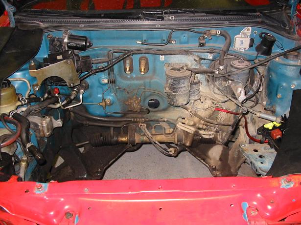

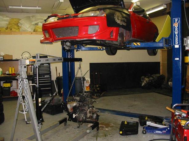

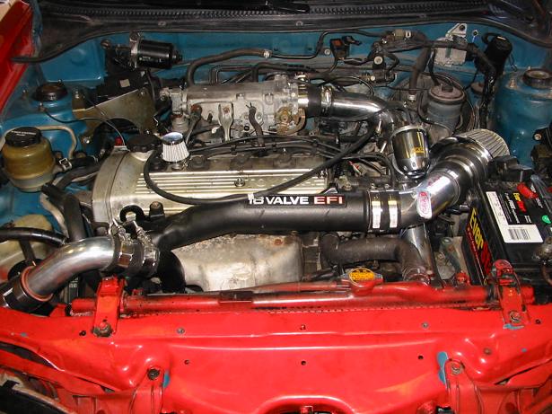

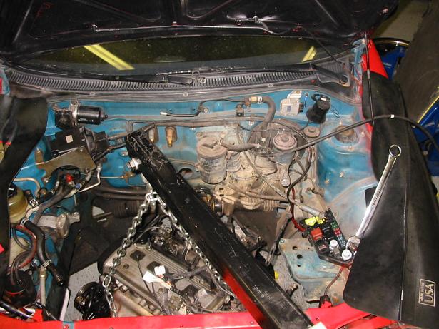

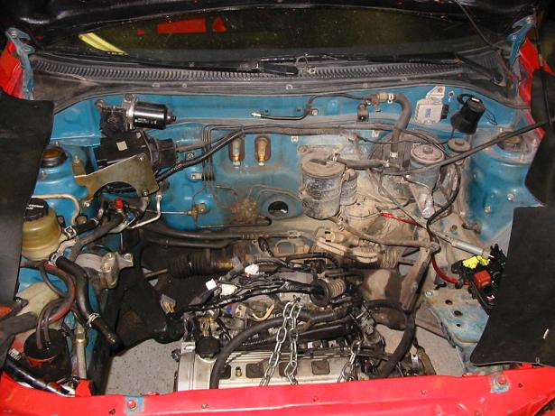

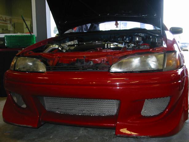

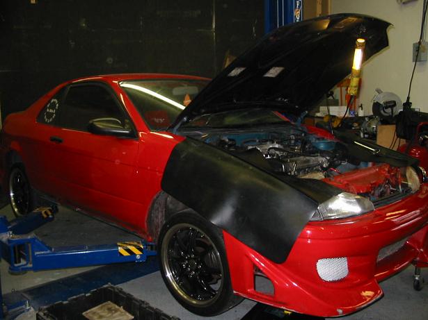

    Here's a Paseo that I did a 4EFTE (1.3 Turbo from Starlet GT) swap on a while back:
    Enjoy! :)

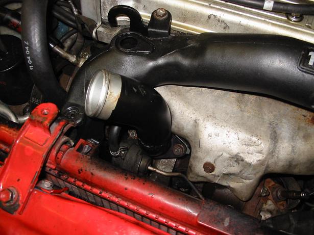

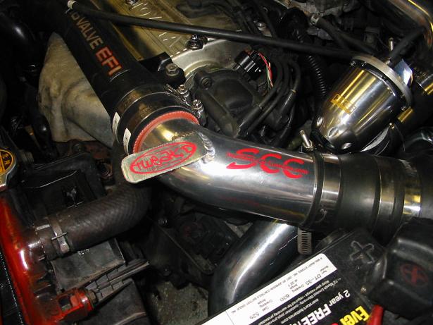

    The mighty CT9 turbo, one of the smallest turbos in the universe!
    For the cleanest look with the FMIC piping, I cut, shortened, and rewelded the turbo outlet pipe at a different angle.
    ^^ Very very sweet.
    SaberJ2X Lurk MOAR
    1,713
    7
    398
    Mayawest, PR
    the last picture is just golden
    I must agree. :)

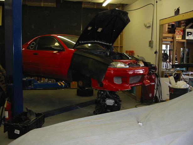

    I wonder if I can drop my motor out the bottom without a dual post.
    Dr Tweak Mad Scientist
    1,237
    Savannah, GA
    Sure, just get it up on jackstands (you need about 24" of clearance) and drop it right on the floor and then slide it out.
