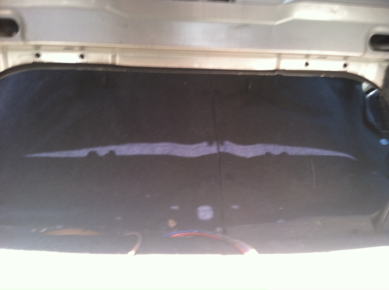

    Does anyone know how to let down the back seat. The pull tab cable in the trunk isn't there. I took the cables off my 99 to put in the S but I cant get the back seats down to swap out the hardware.
    You don't have fold fown seats then... You have to do it the hard way

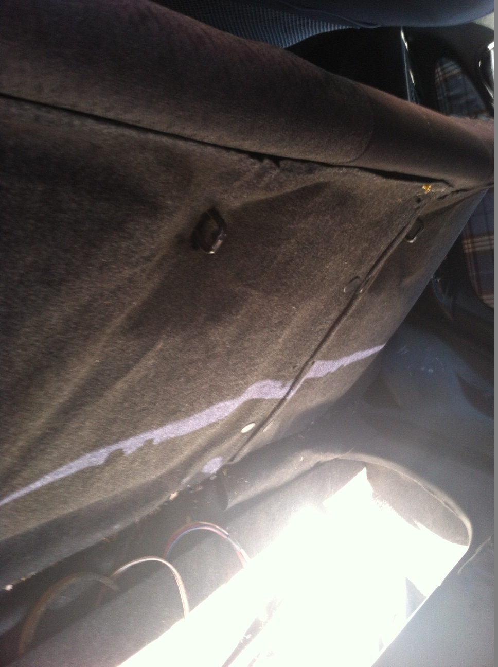

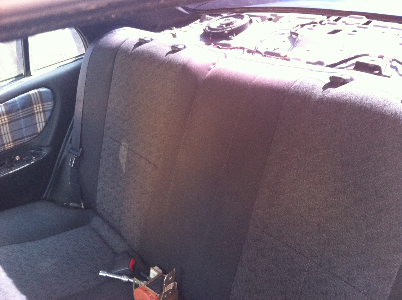

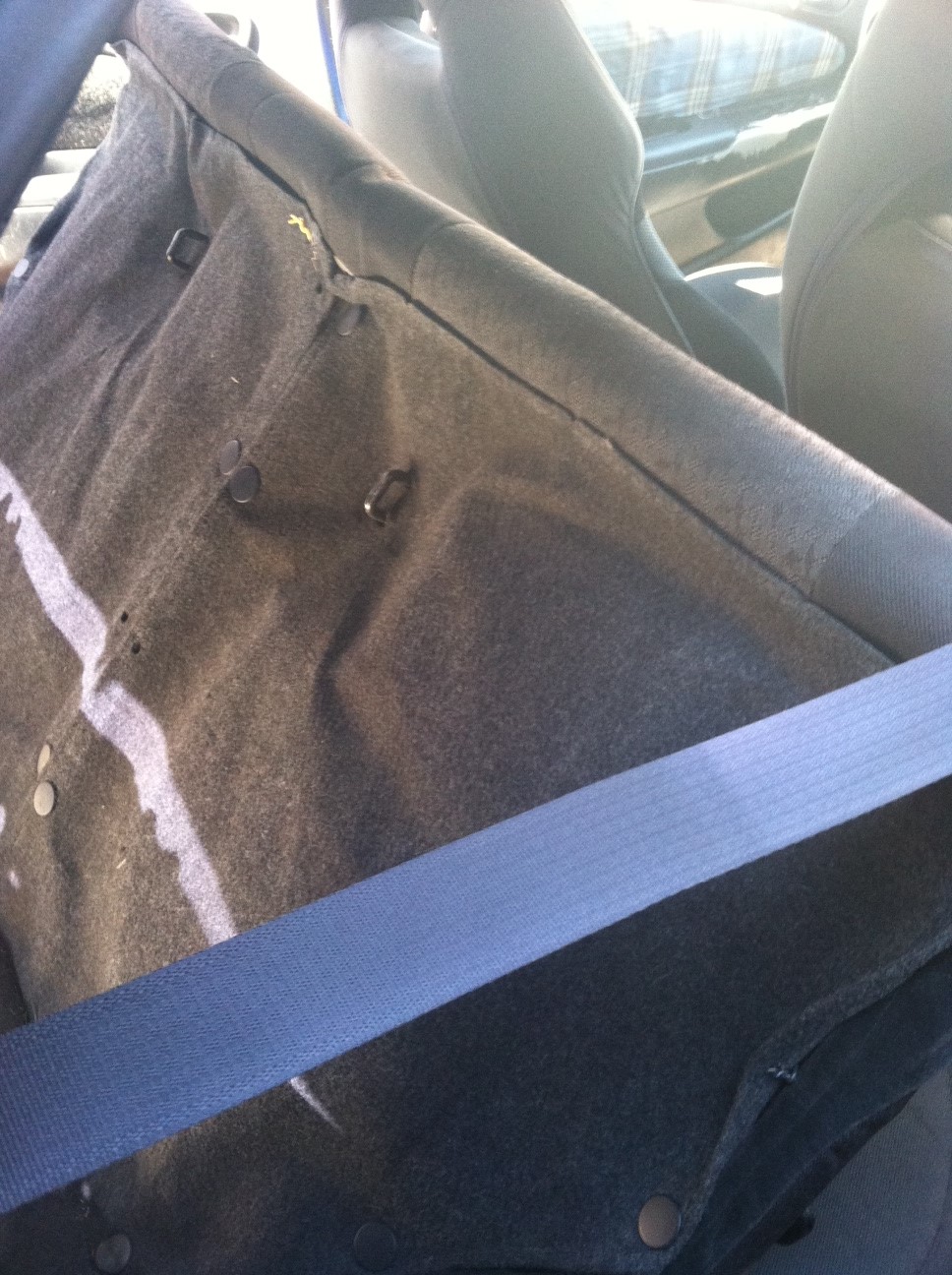

    OK this is not going to be easy, but its 100% possible as i converted my non foldable S seat to 100% fold down....it wont be 40/60 anymore, unless you cut the fabric but it would look weird unless someone sows it back together for 40/60
    You have to pull off the fabric on both seats, and use the black S one on both the 40/60....ill take pictures later of my setup but it pretty much looks OEM

    you want to remove the black S seat cover completely off the cushion, so you only have the fabric....
    And you have both 40/60 folding seats side by side and you throw the black S fabric over both of them (with the old fabric removed from the 40/60 seats) like its a 100% folding rear seat....

    yea, here are my folding seats but as i said, its only 100% folding down, no 40/60
    ohh and you will need to use the plastic panels behind the seat from your wrecked car....i painted mines black with plastic paint...its been fine all this time. You wont find any in black

    I had also been curious, seems like just putting the cables on the S seat would work, just pull them both at the same time to make it work? Or do the S seats not even have the folding mechanisms?
    S seat does not have the hook shown on my pictures to lock it
    S seat is just foam and anchors
    S seat has no hinges n hardware, also non mountable since its just foam
