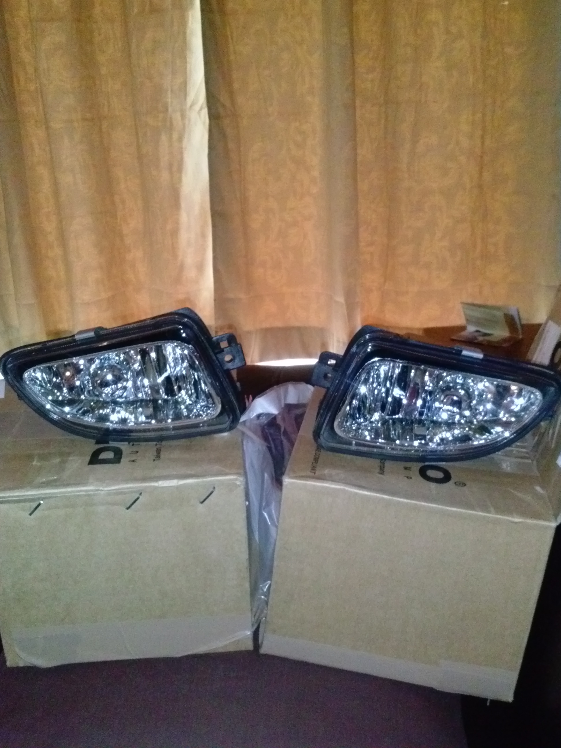

    and cBass my fogs are coming straight from Riga, Latvia look it up my friend :naughty:
    Loso170bx New Member
    yinster those fog lights you showed me do they come with the black plastic right next to it like on the picture?
    yea i think they are off of the hatchback you showed me :thumbsup: but all the way out in russia :( ive been waiting for a week already

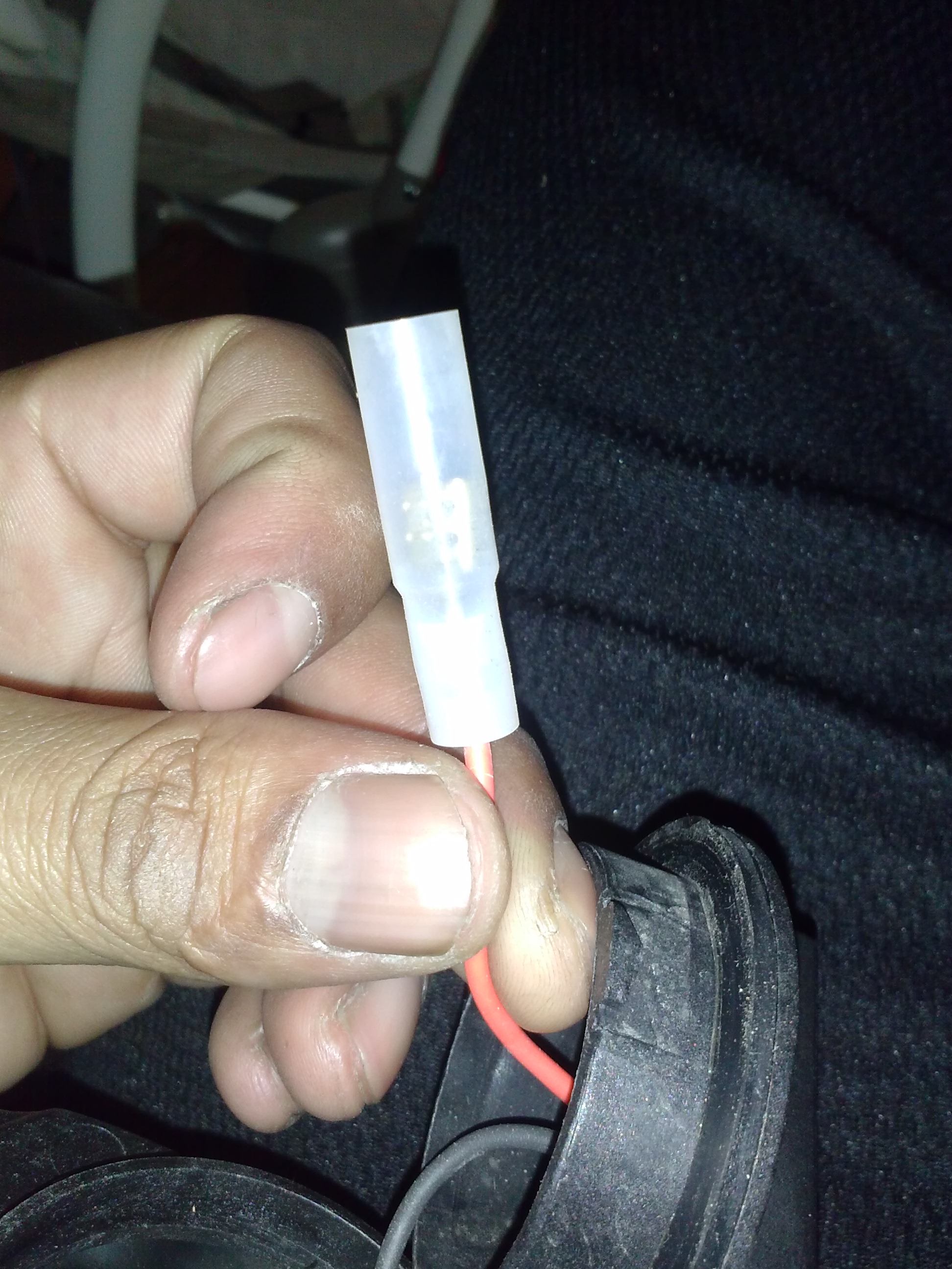

    Ok so i got my fog lights in today but the plugs looks a lil bit different please let me know what do i have to do in order to put hids on them also the black wire is already grounded on the fog housing any help? Tia ps they didnt come with wiring harness so im doing my own CAM00112.jpg CAM00113.jpg CAM00114.jpg
