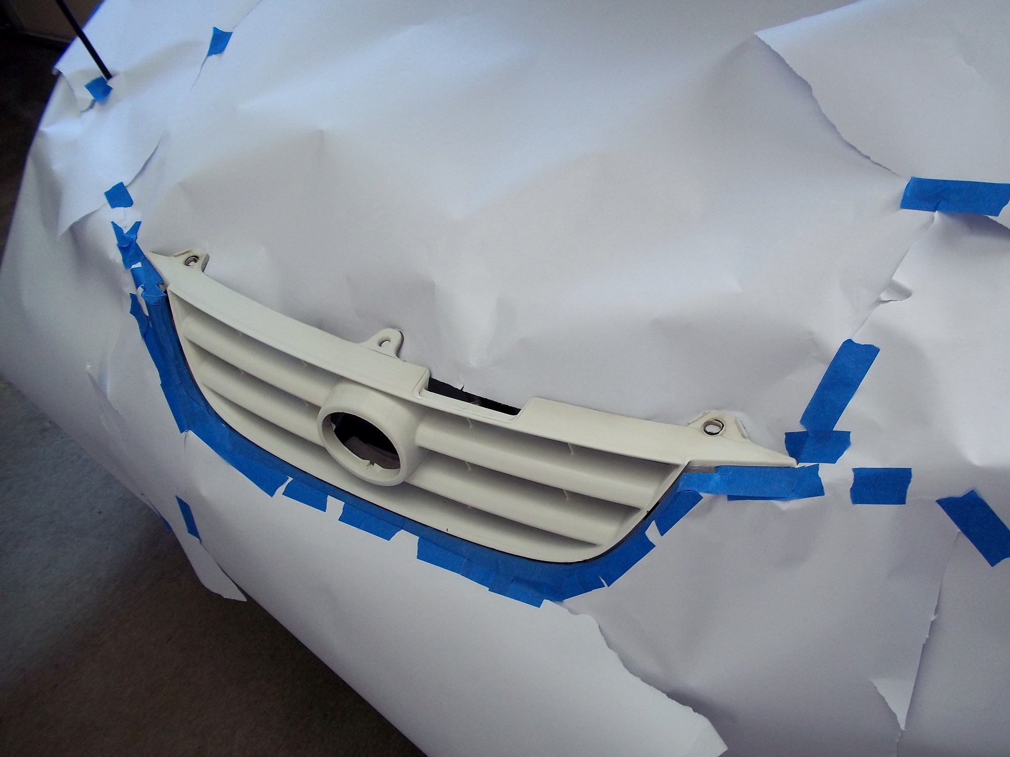

    First you can start by removing your (T) Toyota Emblem in front, It should pop rite out if you push it from behind. Next you can use the dark side of a sponge or sandpaper to remove a coat or make it smooth preparing it for the primer process. Then mask EVERYTHING that you would think might get sprayed accidentally. I personally was too lazy to remove the chrome piece so I just taped it haha. IMPORTANT: Make sure you mask the area between the radiator and the grill.
    Next you do slow repeated steps going back and forth with the Black Primer Paint. Make sure you wait until the paint dries before adding the next coat. Spraying from a different angle every two coats.
    After everything dries, just remove all the masking tape and put everything back in the same place you got it from. then Viola!

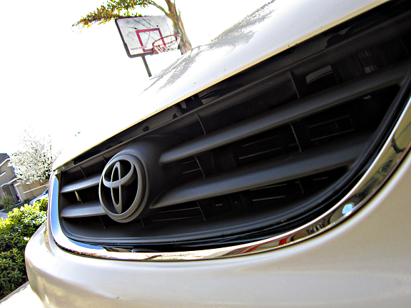

    100_6110.JPG Here's an update with the "T" primed as well. For anyones future ref. IMG_0134.png IMG_0123.png
