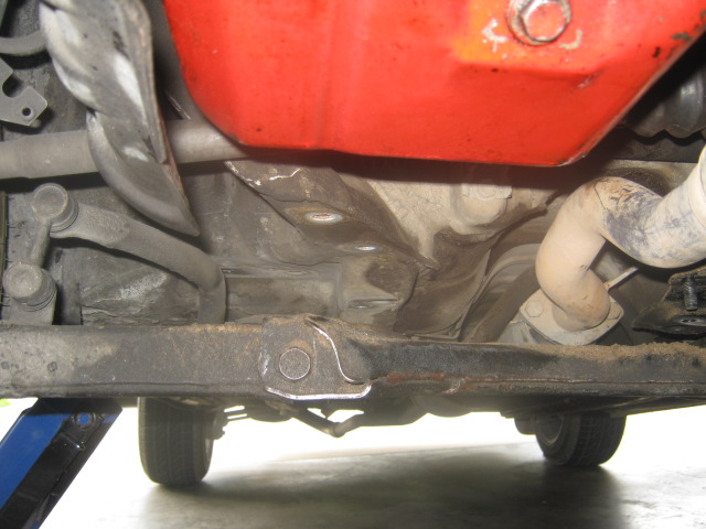

    This is a DIY for the rear motor mount .
    For this DIY you need to raise your corolla real high so that you have room to work underneath it . You do not need anything to hold the engine up .
    First remove the muffler pipe bracket . Then you remove the center bolt of the rear mount .
    Then you can remove the bolts to the rear motor mount and remove the bolts for the sub frame but DO NOT REMOVE THE SWAY BAR LINKS OR BALL JOINTS
    The purpose of removing the sub frame bolts is so that you can pull it down and remove the rear motor mount while the sub frame is still hanging .
    Then once you remove the rear motor mount you go in reverse to put it back on . But you can start by putting the center bolt then push up on the sub frame and put all the bolts back .
