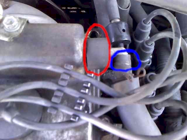

    I guess the only question I have is the hose on the driver side (it looks like it goes the throttle body). I assume I pull off from the blue cirles since the clamp is there. But the gasket I circled in red seems to wiggle too, that doesn't come off does it?
    Pull it off from the red one dude, it's not really a gasket, per se, it's like a rubber, I don't know what you call it lol. But you can go wither way, the blue circle or the red. I forgot you're just changing the gasket, not painting it lol. Either one works if you just want to remove it.

    Mines as hard as a rock. No soft or bendy stuff here. Took a little elbow grease to pull out the PCV valve and jam in a new one. The inside of the old one was dirty, lots of gunk inside, so time to replace it anyways. The PCV is in the pic I put up covered by a bit of insulation (it's on the driver side like you mentioned).
    I checked the cover and one of the corner bolts snapped off as well...metal must be old...I'm going to stop by the dealer's part dept tomorrow to pick up OEM parts. Grommet, hose, and corner bolt. At this rate I'll be doing an engine rebuild just to keep oil out of the spark plug wells...lol.
