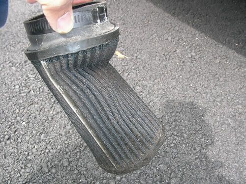

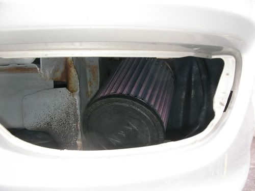

    out with the old (6inch)
    in with the new (5inch) it still doesn't fit and I dont think the 4inch would fit either. I'm just gonna stick with this 5inch and maybe switch back to 6 inch since im just going to keep the driver side fog light off.

    The reason the 6 inch won't fit is because the intake tube is too long to allow it enough room. I shortened the end about 3 inches with a hacksaw. The 6 inch filter fit perfect then but I still replaced it with a new 5 inch.
