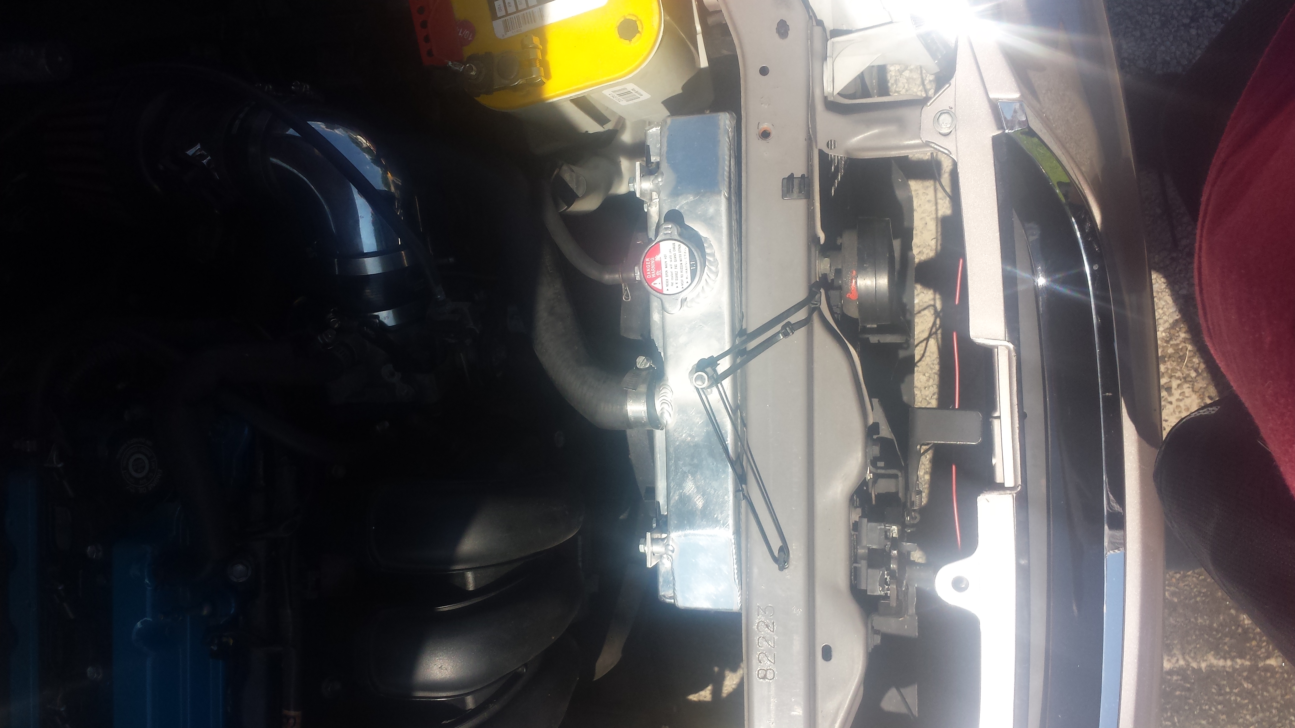

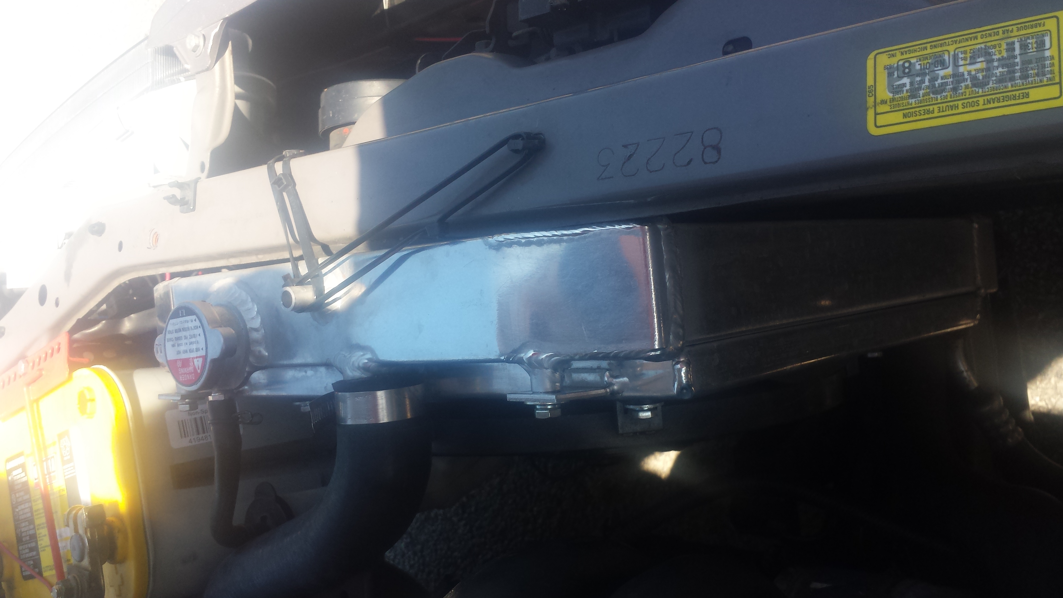

    So I have to ask, how many people on here are running after aluminum radiators? I recently bought an all Aluminum Yonaka Honda Half Size Radiator. It was a very good deal, 150 bucks for a beautiful well put together rad that comes with a metal fan shroud and a new cooling fan. Being a dual core radiator; I kept the same cooling capacity as my OEM radiator. Well basically I have had nothing but problems with my cooling system since I got it. Car is fine at idle. Unfortunately on hot days while traveling uphill like in the mountains the cars temp gauge starts climbing. And every time I use the AC it over heats as well. I have to leave the blend door on heat and bringing in outside air. I am assuming I am not getting enough airflow since the car is fine at idle. I am running an 80 to 20 percent mix of distilled water to Toyota OEM Red Coolant. Also running a 170 degree thermostat as opposed to the OEM 185. Sorry for the long post but just tired of spending money and the problem not getting fixed. 20150723_144849.jpg 20150723_144907.jpg
    CorollaGT has an aluminum one but I think it's a full size one.
    Yea I would switch that out with a full sized aluminum radiator.

    I never knew that happened. The Aluminum radiator makes it looks nice :)

    Most of the guys I see get the 03 Corolla 2 row radiator. It's better for the top hose position, works great for the intake mani swap. Also should be able to find one for close to the same price. I have the mishimoto version, hope I spelled that right. Just didn't put it in yet. If you have a auto trans run a trans cooler. Looks good and they work. The RX7 stock, that's the one people are using on different cars.
