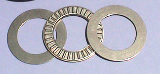

    thanks so much big help the kit comes with 3 washers Screen Shot 2015-02-04 at 8.08.47 PM.png this is what they look like where do these go. I'm asking because i have ordered these sleeves before and installed them and the rear was fine but the front would make clunking noises when turning the wheel and when i hit big dips in the road

    yeah i didn't use the rubber washers and i had to grind down the strut a bit on the bottom part for Screen Shot 2015-02-04 at 8.28.21 PM.png these to go in and i used the o rings to center it everything seemed fine but it was making the noises some people told me its cus of the washers but idk I'm gonna re order the kit and try to install it again i will post pictures as i go along

    Not using the washers would deffinately cause problems bc you will have that much play in your suspension.

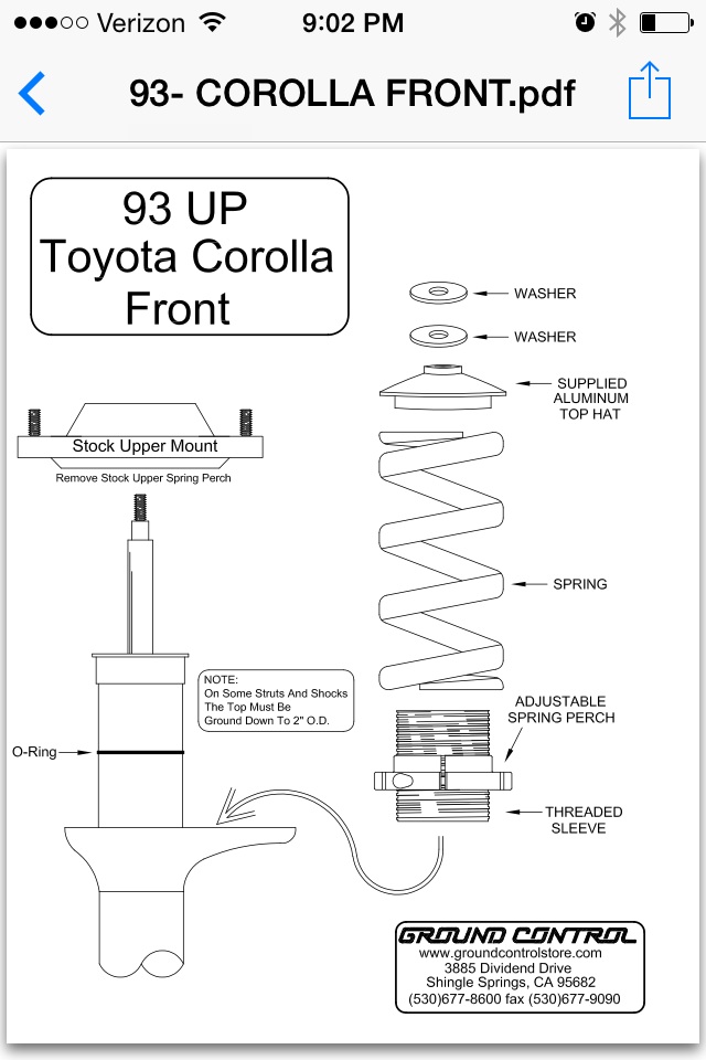

    I honestly do not know what those washers are for. I didn't use them when I installed my sleeves, but mine are Ground Control (Eibach) and I used all OEM strut mounting hardware (top hat and top strut mount) It should look like this when your finished:

    My setup didn't need the rubber o-rings bc of the koni struts I used had a plastic cap that kept the sleeve centered but here's the order you put em together at least for me without o-rings.
    Sleeve with adjustment nut
    Bump stop
    Spring
    Spring perch
    2 washers
    Top hat with nut
    Install
    Those are directions straight from GC.

    Matt you still have the stock spring perches on top of the GC spring perches?

    thats just what mine looked like i must ve messed something up in the order i put everything in hows the ride btw?

    Yes I have the OEM one's on still. The ride is fine, bouncy at times. Would be perfect if I raised it a little. Seemed better than usual today.. Must have been the 55 degree weather LOL

    Trust me it would ride 100 times better if you take that out it's not suppose to be there I made the same mistake called GC and they explained what I did wrong feels and looks so much better now.

    Notice the fine print...(remove stock upper spring perch)

    You are correct about the left struts being front in picture. I just jacked my car up to look and the only reason I can remember re-using the stock perch is because I didn't like the way the GC perch fit into the bottom of the top mount.

    Yeah that's what the washers are for to help fill the void, they fit perfectly flush then.

    I'll be damned.. That schematic doesn't lie, does it? I also recall a mark on the GC perch that didn't match up to the top mount ring, but did match the OEM perch ring. If this is the case I might take the OEM perch off, meaning I can raise the spring up, allowing the strut to do more of the work now... Meaning less bouncy. Thanks bro!!

    that's exactly right meaning you can lower it more and still ride smooth bc your strut will be functioning properly lol

    I'll have to get some washers at work tomorrow. You said 2 on each strut? How big is the center hole on the washer? Does it fit pretty snug/close around the piston?

    The washers don't actually go down around the piston they just go over the strut mount stud/threads and sit on top of the piston I can't recall how big but just pop that plastic cap off the top of your strut mount and the stud should be sticking up enough to see what size you need. They should fit snug around the stud you don't want them falling down around the piston.
