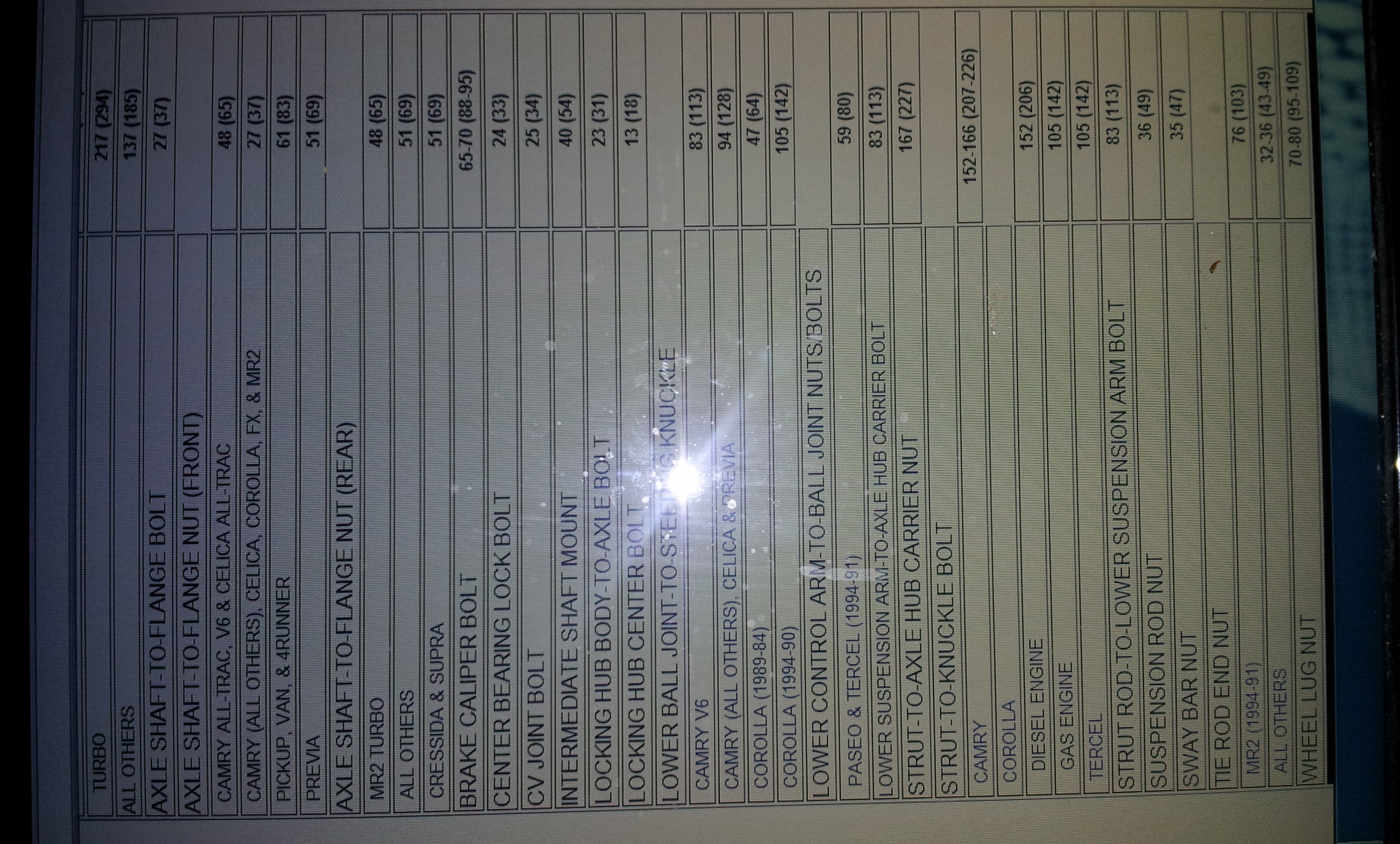

    Ive been looking around for suspension torque specs. I came across a couple pages that had them, but i noticed some are different. Can anybody clarify this?

    What torques are you looking for? I'll bust out my FSM when I get back home.

    Lmfao. i just need the torque specs for the strut, as im installing coilovers in a few weeks.
    15,356
    978
    K. I'll get you the torque specs for the 3 top mount nuts and the 2 lower nuts and bolts.
    Good work not just torquing the shit out of them by the way!
    15,356
    978
    Ft-lbs is the last number on each of the torque values.

    Awesome thanks alot! Exactly what i was looking for. And yeah, id prefer to have the peace of mind that its done properly.

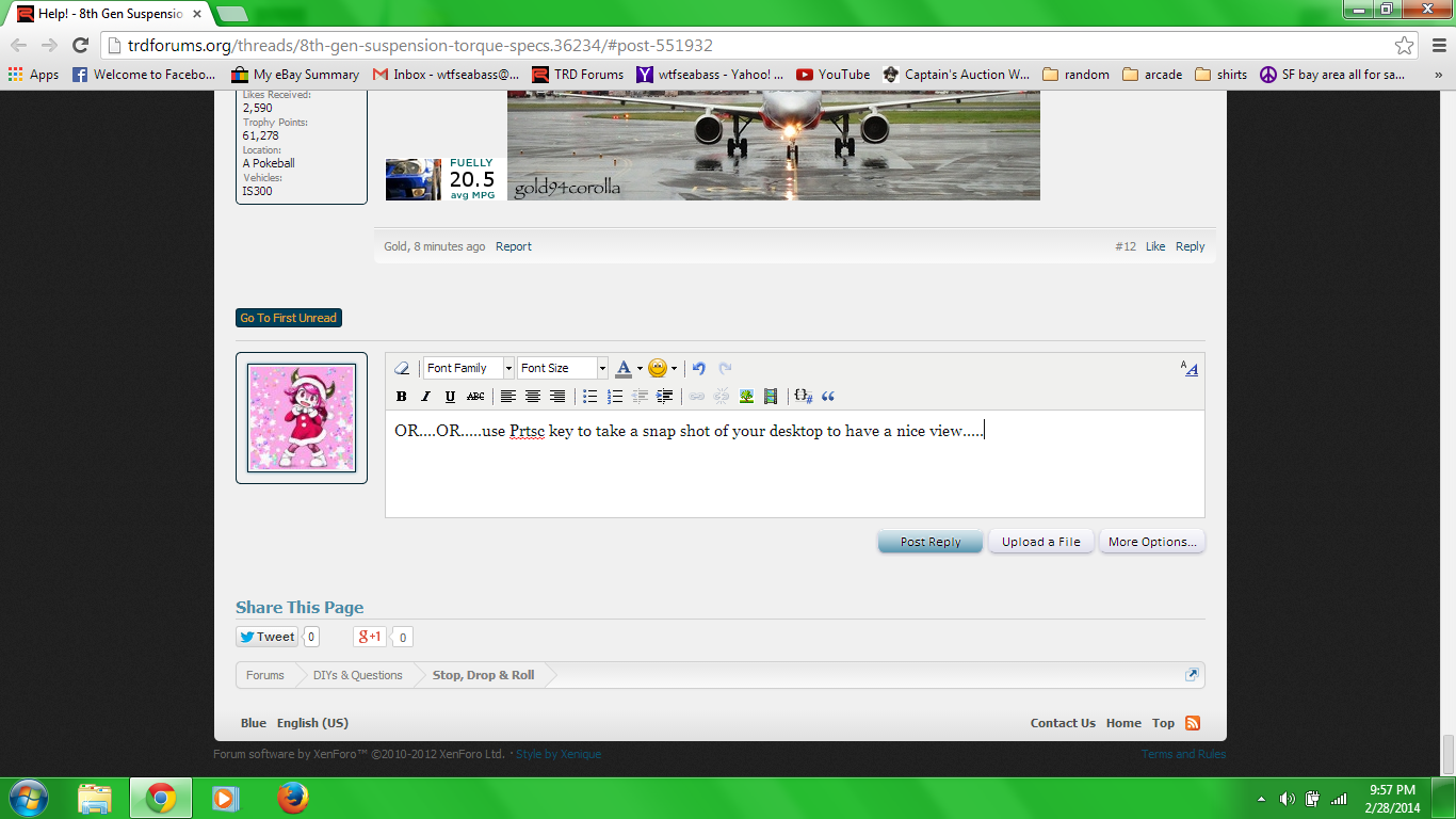

    Lmao.. yeah i know... i dont know why they're uploading horizontal. Bad pictures in the first place.

    You people with phones gotta learn to hold it sideways like a regular camera! lol.

    OR....OR.....use Prtsc key to take a snap shot of your desktop to have a nice view.....

    Yeah, i would've, i have no computer of my own at the moment, i was at a friends house and just decided to have it on my phone for quick reference. But these diagrams are fan-fucking-tastic.
