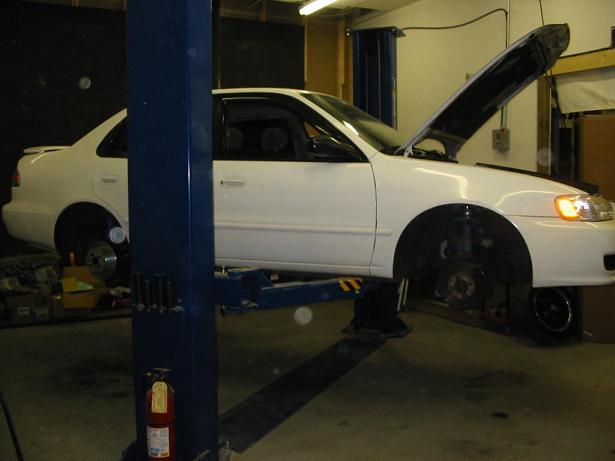

    Well everyone, I'm happy to annouce that I'm re-releasing the Phoenix Tuning Rear Disc Brake Conversion. I've had a car here that I've been able to do some more R&D on and I've made some improvements to make the conversion easier. I'll be making an official thread in the near future and updating my website. In the meantime, if you want a rear disc conversion for your '93 to '02 Corolla, just let me know.
    Now with that said, let me introduce you to Jerry's Corolla!

    sweet....now time to update the front dull-lookin disc, lol....

    I dig the D/S rotors. What Toyota is this kit derived from?

    Will those rotors fit my AE101 rear disc?

    These won't fit the AE101 rear brakes, they are a different setup. They are modified Celica GT parts. We're going to be looking at around $550 for the kit but I haven't finalized that yet. I'm pretty sure that these will work with ABS no problem but let me know ahead of time that they will be for a car with ABS just so that I can be sure.

    so, you could use celica gt brake pads as replacement parts? nice! if so :D

    That's exacly what you use :)

    I used a Corolla brake drum clamped over the brake disc with them both centered by a hub that I had removed. Then I used the Corolla brake drum as a guide.
    Probably looking at $550 for the parts, and I'd say $250 or so should cover the labor.
